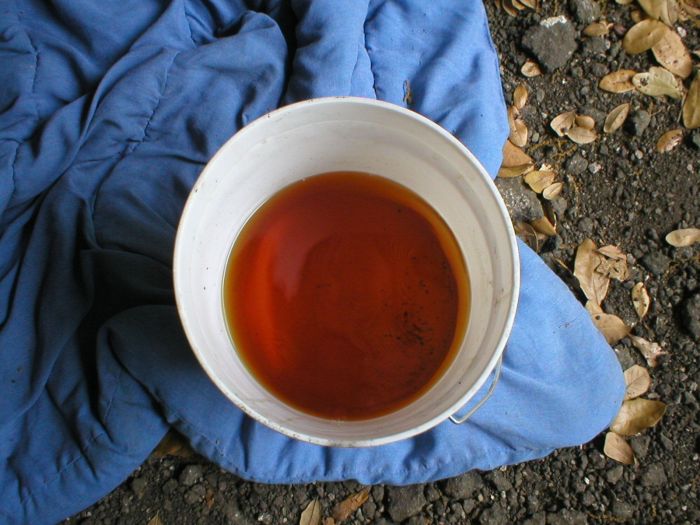

Well, I just purchased a car that hadn't run in over 2 years. I don't know when the fuel was filled, but I decided to drain everything, test and clean the injectors, then try and start the car. Here's what the fuel looked like after I drained it....
BTW, I will agree with Joe, I wouldn't let the car sit too long without actually running the engine for several minutes, or drive it around the block. After Joe cleaned and rebuilt my carbs, I have since added the POR-15 fuel additive so that it won't breakdown as quickly....
