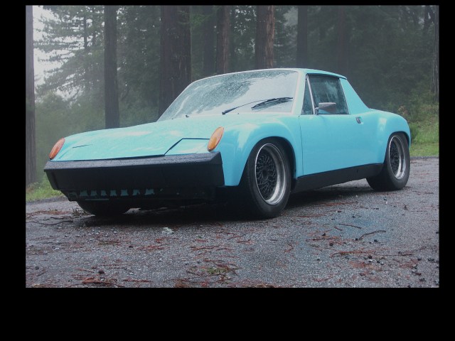

To keep costs down, all of my fiberglass bumpers and hoods have been swap meet 'buys'. Took a little refinishing time to primer & spot putty, but the results are fine.
Pic above is right after I 'found' a used hood and couldn't wait to paint it before I put it on...
