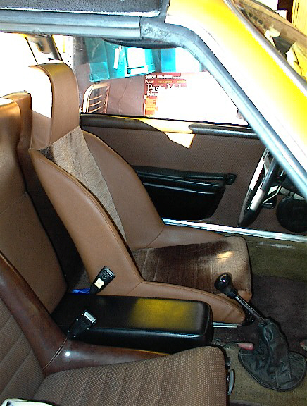

I don't know who's this is but the seat was done like an early 911 sport seat. I have a set in my 944 and they are really nice. This is the 3rd car I've put them in now! I plan on making a set of these for my teener when I get started on it (IMG:style_emoticons/default/confused24.gif)

I like that seat. great! i need more of those pics. (IMG:style_emoticons/default/piratenanner.gif)

QUOTE(scotty b @ Apr 18 2006, 08:00 PM) *
That's my car I did the seat about 3 years ago. Made the bolsters and did all the upholstery myself. Still have not done the pass side. I think I had some pictures on my blog. I'm looking for pictures of the modified bases and frames I know I have some somewhere.
Bob (IMG:style_emoticons/default/biggrin.gif)

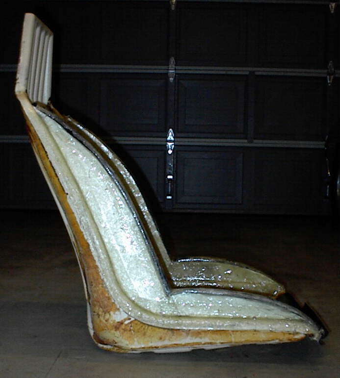

Here's mine. From this view, it's easy to see the original shape and the new shape.

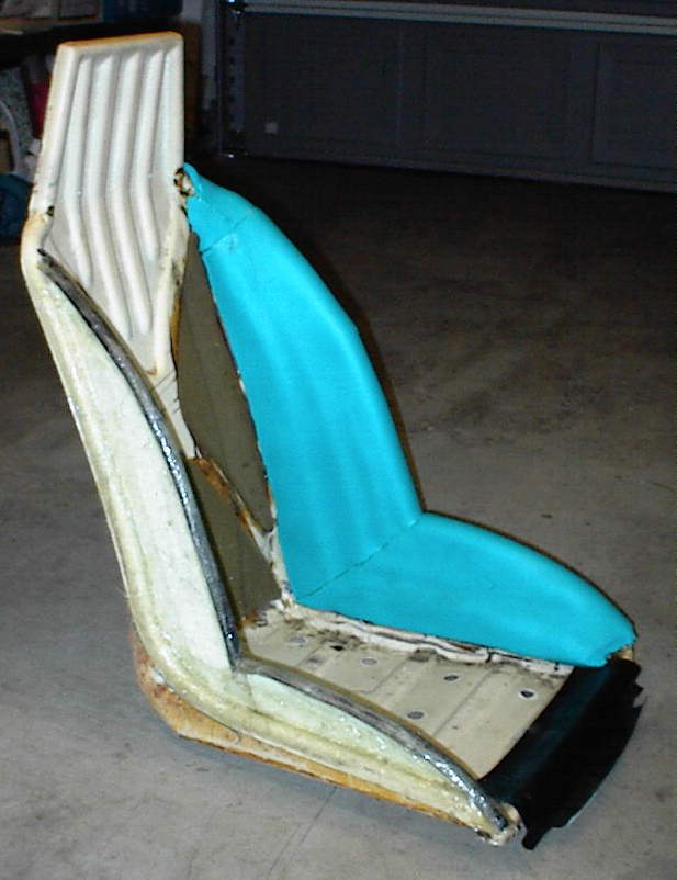

Here it is half covered in foam.

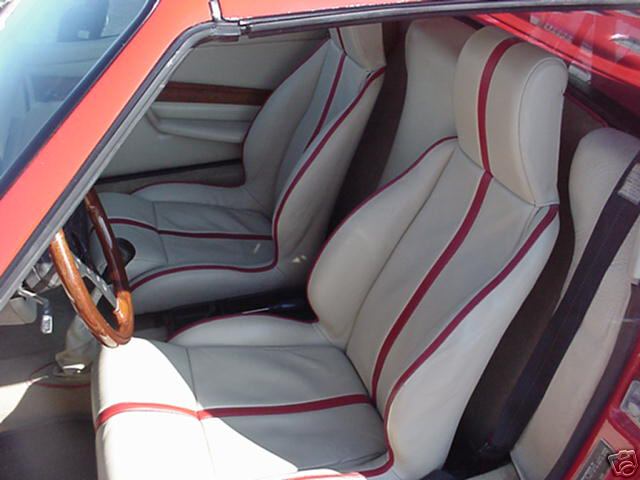

...and finished

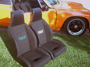

I have a stock seat modified by Renegade Hybrids that is very nice.

That helps a ton.
thanks
