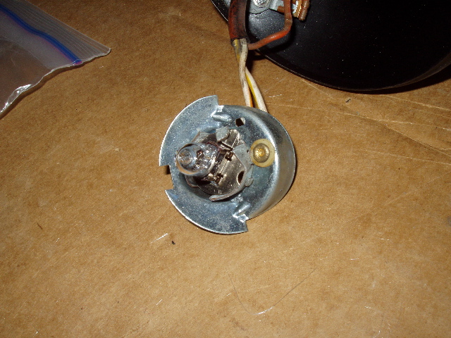

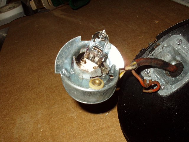

Ok I found them, I did nothing special here basically crimped the base of the bulb socket around the bulb fixture. Now that I see what I did I have to get in there and refine it.

thanks, chap. I had concidered that criping idea, but isn't the bulb a little low in the saddle with that particular version?
iamchappy
post Apr 21 2006, 07:06 PM
It all happens so fast!
Posts: 4,893
Joined: 5-November 03
From: minnetonka, mn
Member No.: 1,315
Nope they seem to work just fine, there not as big and dont take up as much space as the original bulb but the element is probably close to the location of the original bulbs.

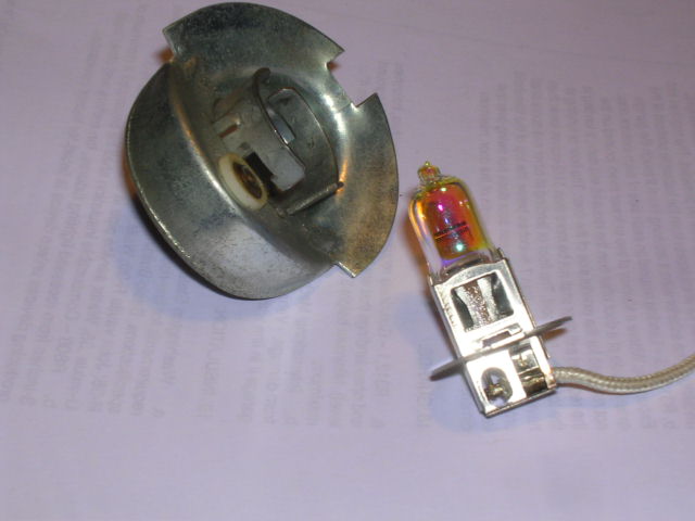

Here is the bulb and housing... Just to show ya...
