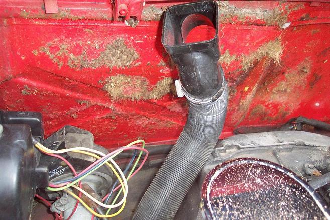

Also the heater hose was disconnected. Does it just attached to that blower motor?

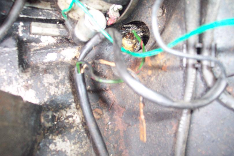

The oil temp guage on the center console twitches when I turn the car on, but doesn't seem to work. In the pic below with the wires, there is a wire w/ spade connector that isn't attached to anything (FI remnant?) and there was a green wire with a spade connector that looked like a signal wire, which I attached to a little spade on a pluggish unit near the center of the engine.....is this the oil temp sender, and was that the oil temp wire? Kinda hard to see in the pic.

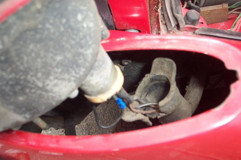

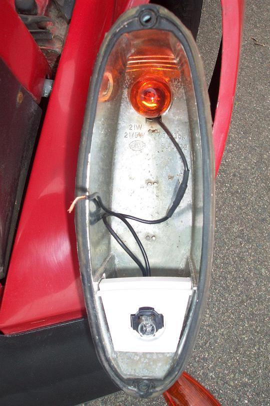

FINALLY, I'm installing the Camp 914 euro light kit (see pic), but I'd like to see a pic of someone's installation of the bulb/white plastic peice. Also, when should the park light be on?

first is the ?oil temp sender?

Finally the heater hose shenanigans!

The oil temp sender is on the bottom of the engine, driver's side, forward, in a round plate (the taco plate). The pictured sender on the top of the engine, passenger side, forward, is the oil pressure switch (hooked up to the green light in the leftmost gauge).

are those camp euro blinkers? i thought the white portion went verticle.
what the heck are all those yellow wires? since you are carburated, the harness gets pretty simple. hopefully the po didn't tear into the main harness too much.

Yes, those are camp euro blinkers, half installed. I just kinda stuck the white thing in there, I kinda need a pic to figure out how to install it correctly.
Which yellow wires do you mean, the ones coming off the relay board? I'll find a pic of a correct relay board to compare...
I'm afraid I don't know when the parking lights are supposed to be on or off.....can anyone clue me in? (IMG:style_emoticons/default/smile.gif)

the marker lights should be on when the light switch is pulled to the first position and when the headlights are fully on. is your fuel pump in the front of your car? if you have a good relay board with the regulator on it, i'd swap it out and loose that wire mess.
