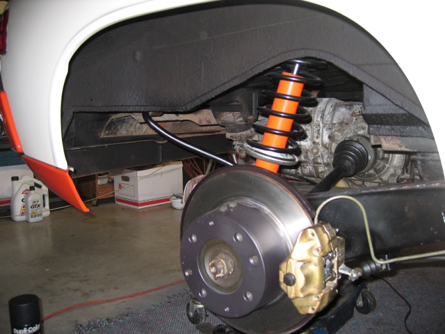

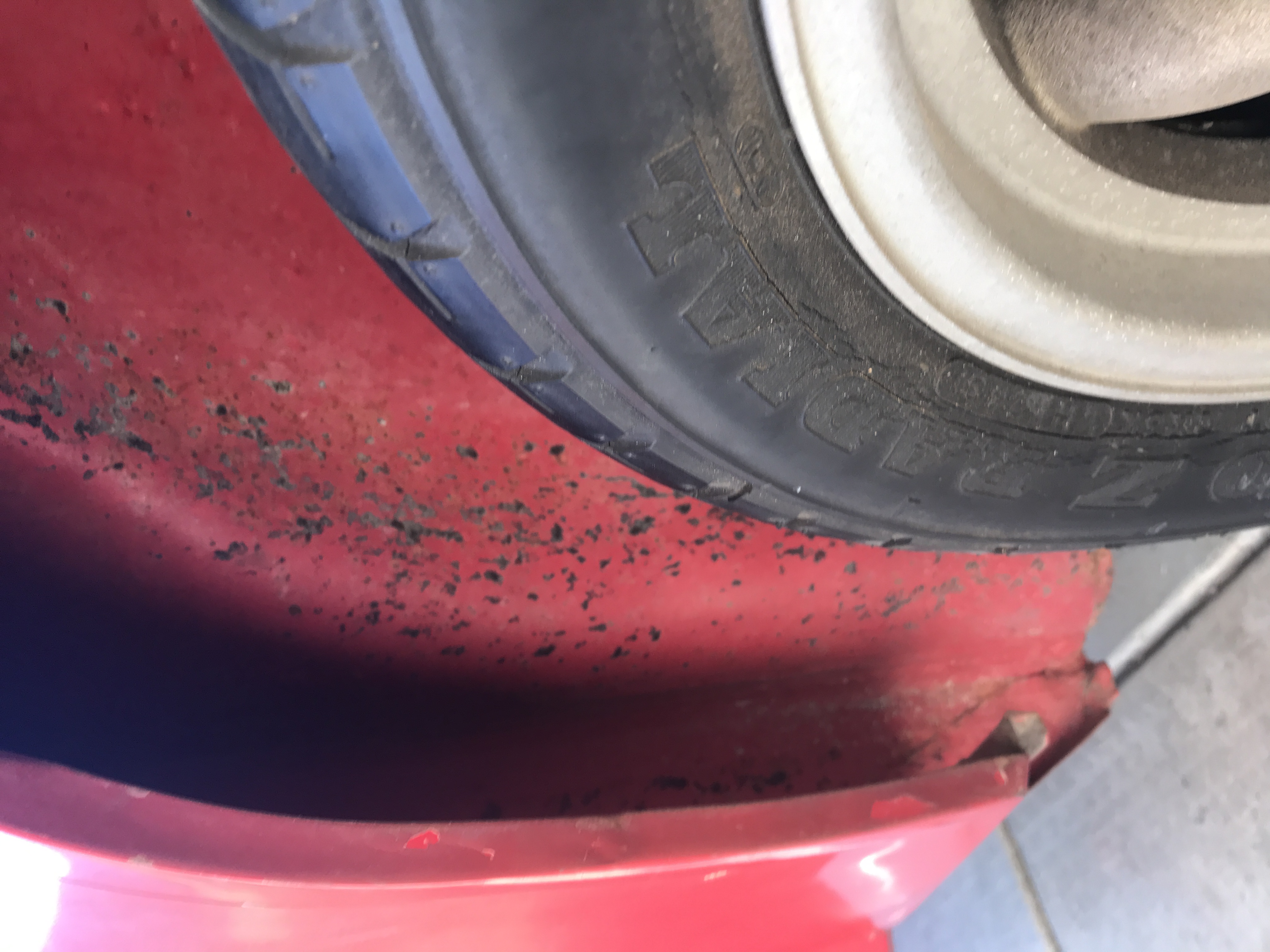

I know it's over a decade since the last post on this thread, but I thought I'd share this picture of my Dad's light ivory California 914. It was only a few months old and did not have the undercoating in the wheel wells.Attached Image

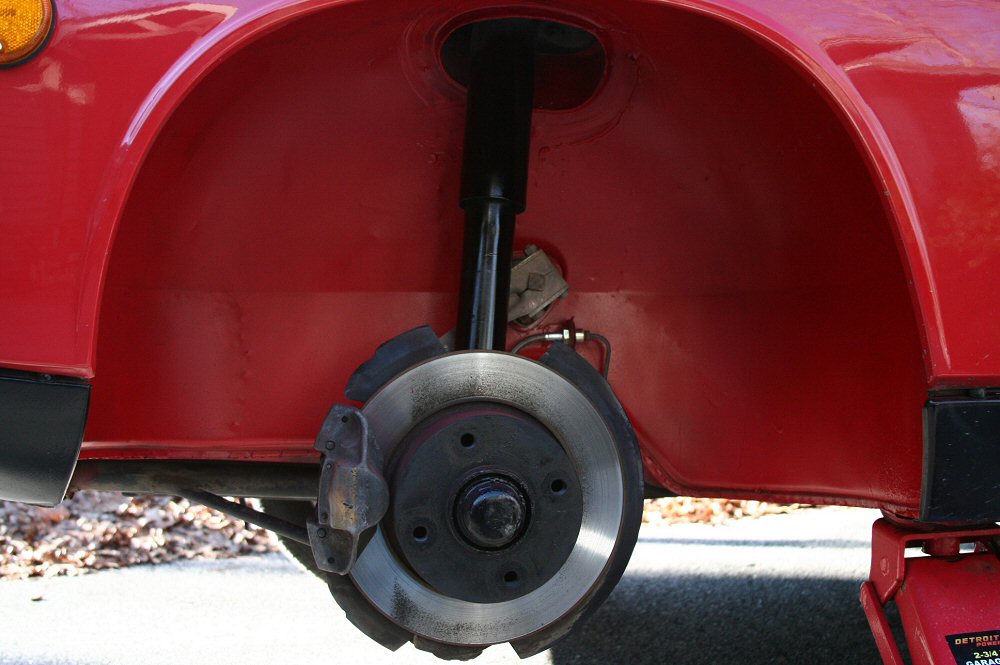

My 74 was undercoated at the dealer- SOP back in 1974 Virginia. It's white underneath the undercoating.

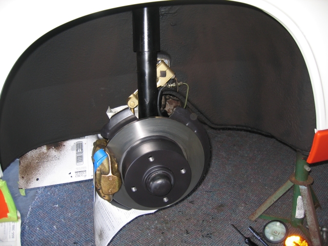

Mine has the undercoating, and it's pretty messy in its installation. I've concoured my car for a long time, both in my PCA region and nationally at the parade, but never where originality was the defining factor. Even so, since it was installed at the dealership, as a judge I would not deduct for it being there. The factor would be its condition and cleanliness.

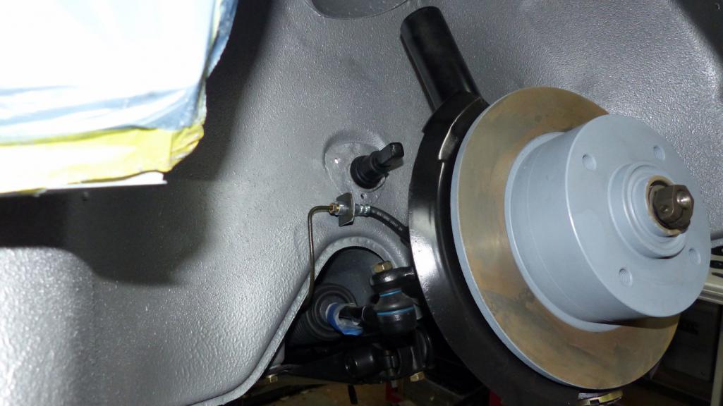

my current 74 Bahia Red project.

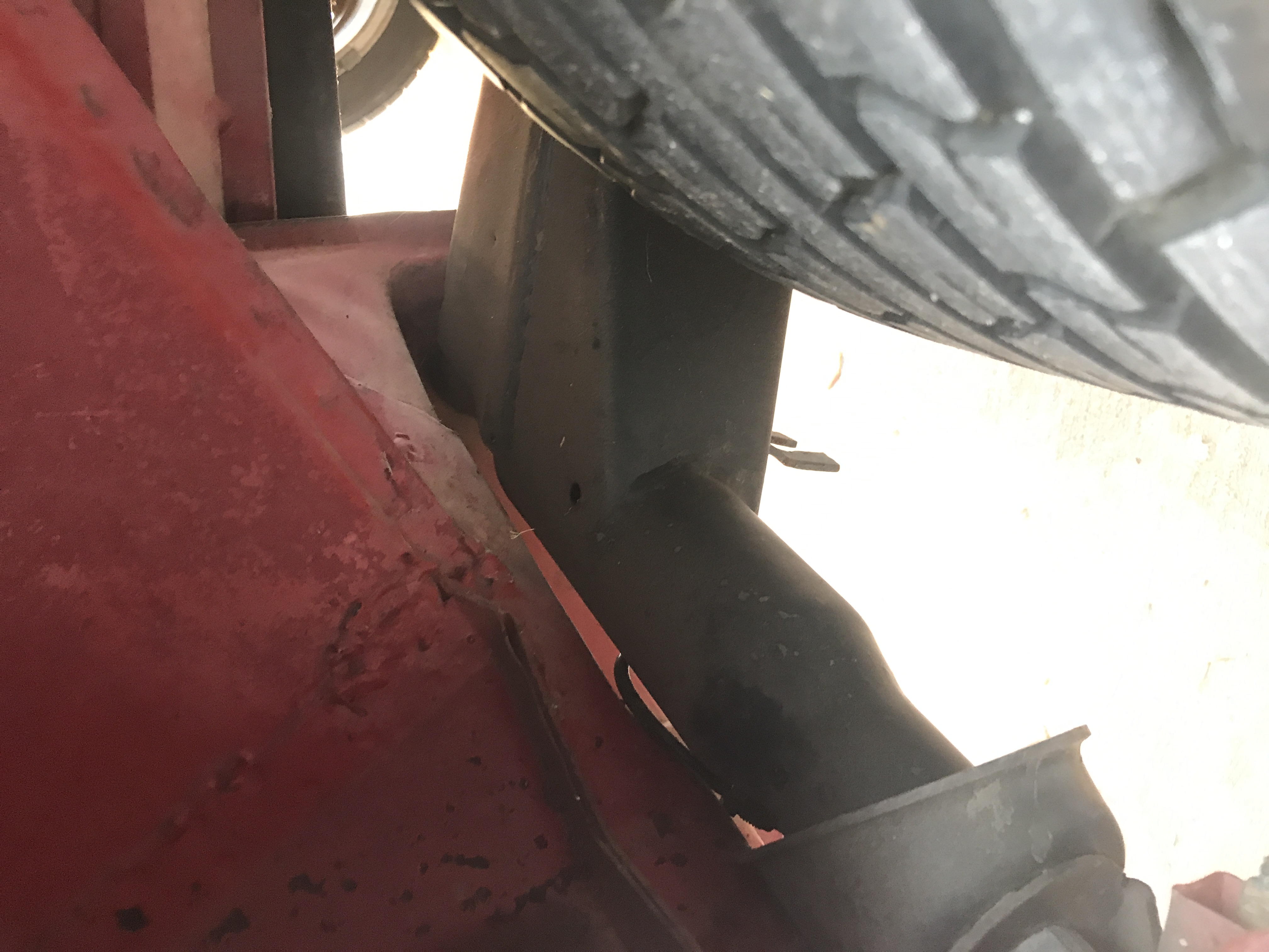

Interesting to read through this thread and see how things have evolved. My car had gobs of black dealer-installed undercoating but during my resto, I opted for the modern version of paint over schutz which was to use body color tinted bed liner. Maybe not CW, but I like the compromise.
