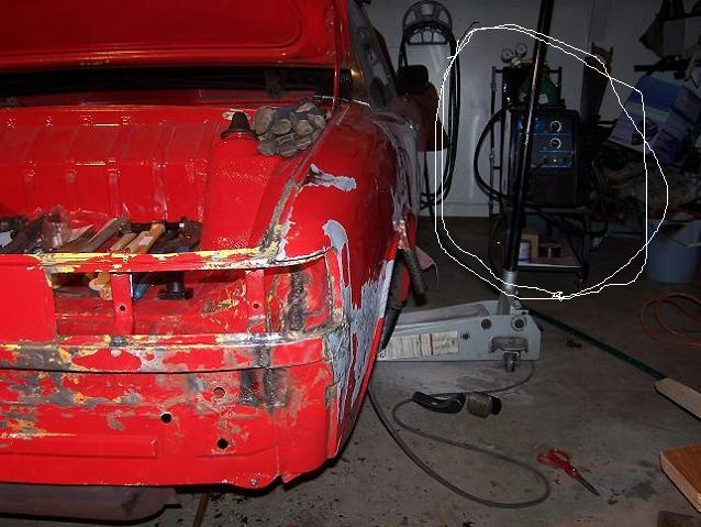

Millermatic 135 MIG.
Continous feed control.
Continous power control.
135Amp
Works on 110V.
Good for most automotive repairs.
I bought mine for the 914 and it works good. Love the continous power and feed controls.
