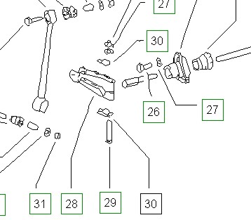

What do the 4 small tabs do?

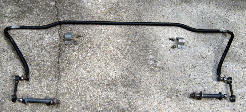

Rear. I have the mounting brackets coming.

I only count 2 bolts for the triangle mounts per side and wouldnt the drop links need bushings?

complete bushing set is coming. New hardware replaces all old hardware except on bottom shock mount.

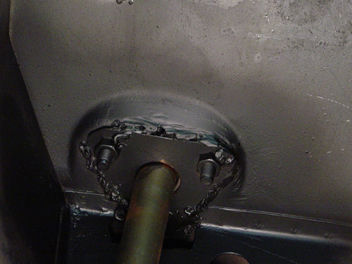

I made mine. Just found some steel the same thickness as the outside mounts & cut them with a jig saw then drilled the holes. The lower hole was the tricky one tho. Had to use AB epoxy to hold the nut to the plate while I screwed the bolt in from the fender well... and it worked (IMG:style_emoticons/default/beer.gif)

The four small tabs go in the arm at the end of the bar to clamp it to the square end. This is a lousy drawing but they are #30:

Does it go inboard, outboard or in the middle of part #28?

Here is a better pic:

so inside the #28 part. That makes sense. I was trying to figure out how that part didn't come off!

Bruce Allert
post Sep 25 2003, 06:38 PM
Hellions asleep
Posts: 3,289
Joined: 19-March 03
From: Eagle Creek, Orygun
Member No.: 441
shor'du wish'd I'd've known 'bout dem plates fore I made mine. Geeze! dem's nice (IMG:style_emoticons/default/clap56.gif)
