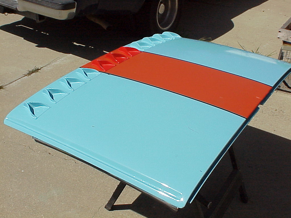

race914
post May 24 2006, 09:56 AM
73 914-4
Posts: 1,006
Joined: 31-October 05
From: Nipomo, California (Central Coast)
Member No.: 5,027
QUOTE(trekkor @ May 23 2006, 08:07 PM) *
...Except, our cars don't go 500mph.
I'd like to see some wind tunnel pics.
KT
I'm sure the stick on airtabs wouldn't do well at 737 speeds. Not sure if the airplane devices work well at ~120mph ? (IMG:style_emoticons/default/confused24.gif)
Here is the 'operational concept' from www.airtab.com
(IMG:http://www.airtab.com/Images/trailflo.gif)
Here is how my roof turned out
Will this help get airflow to the rear spoiler? Don't know... but worth a try for $27.50. The with & without laptimes will tell the story!
I'll post back after our June BW event.

I am very interested to see what you determine! I think the best way to know how well these work for you is if you can get up to high mph in a sweeper turn. BW only has one and it isn't really that long (not like T7 thru T8 at Willow Springs). If you get better rearend grip and can get a higher mph thru a sweeper, then those tabs are working. To clarify - if the car wants to oversteer at 105mph without the tabs, but you can run through at 105 or faster without oversteer with the tabs, then they are working.
I agree there will definitely be more drag with their size. The issue always exists with anything aero - how much drag can you handle v. increase to handling performance (though on a smaller degree with smaller generators). If you have the HP to pull the generators through the air, and they help you go faster, the driving benefit outweighed the drag cost.
Getting the air to tumble over the rear section of the car may just be enough to reduce the crazy lift the car creates otherwise. I will gladly pull them through the air to get that benefit. Hard to say without a wind tunnel (which who has one of those (IMG:style_emoticons/default/blink.gif) ) or just some good old fashioned testing. BTW, if you have a full scale wind tunnel in the SoCal area, you are my new best friend!! Probably have a whole new club of best friends (IMG:style_emoticons/default/biggrin.gif)
Speeds below 100mph are probably worthless as the car doesn't experience a bunch of lift at the rear anyway. Hard to hit speeds much above 100mph at BW though, just through the bus stop and the sweeper after it. But they go by so fast...
BEST OF LUCK - if they work a lot of us will benefit on the larger tracks like Willow Springs! (IMG:style_emoticons/default/driving.gif)
