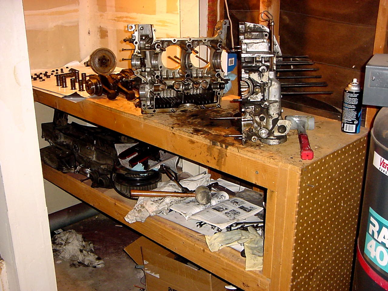

Ok, now I am really frustrated (IMG:style_emoticons/default/mad.gif) . Geoff, I finally got the oil pump off, and it indeed helped by taking off all the fasteners. The crankshaft side is splitting fine (about 1/8 inch open all the way down through the oil pump), but the flywheel side is not. I count 22 fasteners that I have off to the side and I searched four times for others. I didn't pull the fan hub on the cranshaft side, could this have something to do with the flywheel side not splitting and do I have to pull the hub to split the case. I dont have a puller and figured I would split the case and then worry about the fan hub afterwards. Thanks for your help.

You don't have to pull the hub off. But you do have to find the case through-bolt that hides behind the flywheel. There are also several that love to hide under layers of dirt and crud.
"If the case doesn't separate, you've missed a fastener." I've heard that advice many many times so far.

yep, you were right. Went into the garage and stared at the damn case for ten minutes, then found the lonely bolt. Amazing how easy it split after that. Did it by hand actually. I was scared for nothing. (IMG:style_emoticons/default/laugh.gif) OK, so can anyone tell me what's next. Thanks for all the help.
