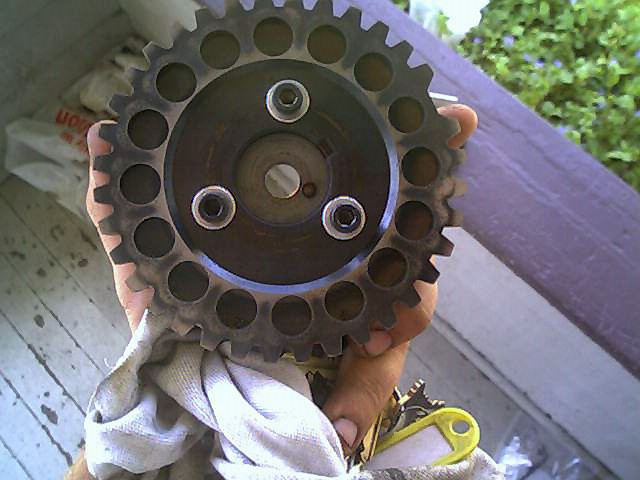

Where/how did you buy/make the EDIS trigger wheel on the crank? I'm very strongly leaning in the same direction, and I hear there are places that just make replacement pulleys with the EDIS wheel there, and sensor mounts. Did you make yours or buy it? Pics?

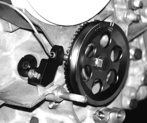

how does clewitt mount their trigger wheel?

QUOTE(Aaron Cox @ Jun 2 2006, 02:23 PM) *
I think they bolt it to the back of the pulley. Nice stuff, but Clewett only makes 60-2 wheels, and only seems interested in selling complete kits, not just the wheel and the sensor mount. Some people on the Bird board mentioned they found a vendor to sell pre-made EDIS wheel setups, but didn't say who that vendor was. (IMG:style_emoticons/default/dry.gif) (years old posts, found by search)

Thomas hooked me up with the mount and the moded wheel.

Here is Clewett's awsome set up.

Did more digging and answered my own question. Found this place: EDIS wheel
They have a lightweight wheel (60-2 or 36-1 for Electromotive or EDIS), pulley, sensor mount, and distributor plug. $300 for a complete kit with sensor.
