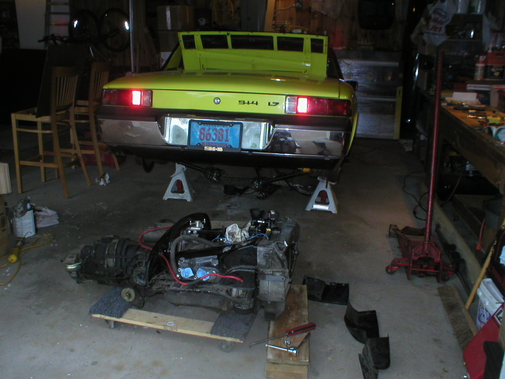

Last night I prepped the motor for the drop, and found some additional things to fix. Theres a big suprize. NOT. While the firewall and shift rod guide bushings were fine, no more than 1/16 play between the rod and bushing, the ball cup bushing was, well, GONE! There was the bottom half of the bushing still in the cup, but where the ball on the shift linkage would contact the nylon, it was worn/broken off into pieces. No wonder it ground a little... and there was a torn motor mount, and I had a couple head studs stick in their EZ outs, and the whole mess backed out of the head, rather than the nut coming off the stud, or the stud coming out of the EZ out...

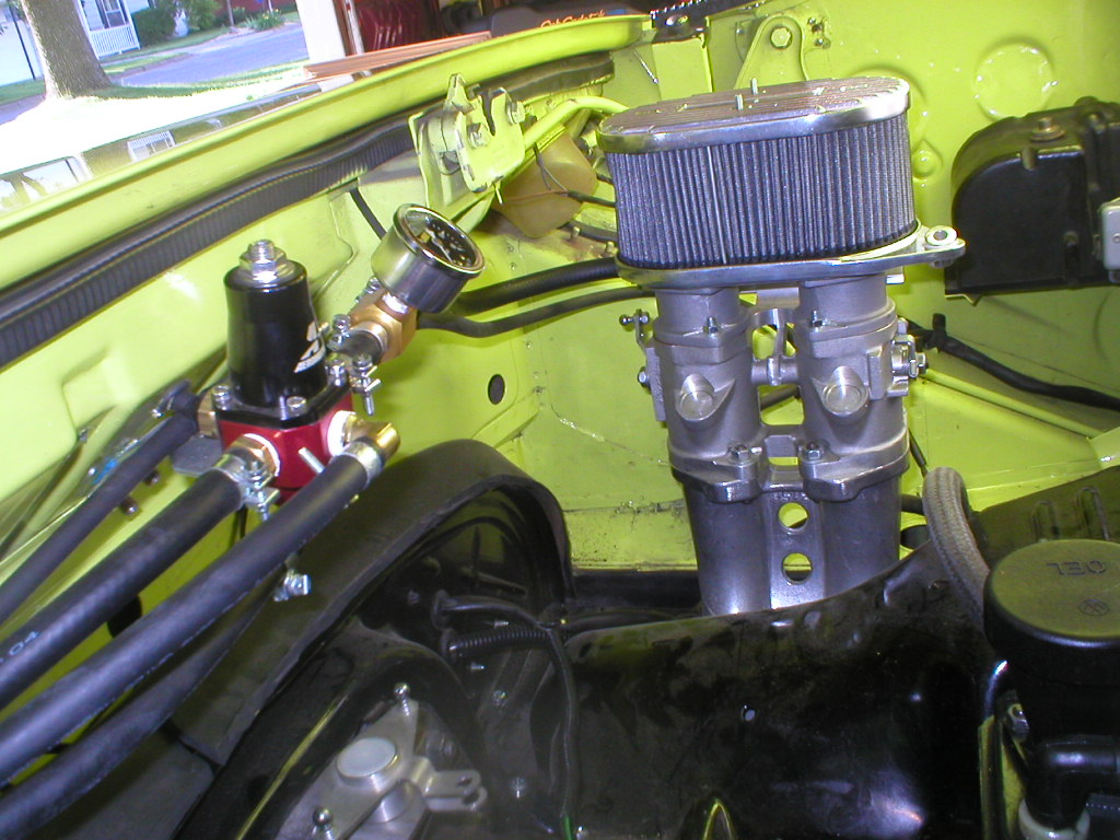

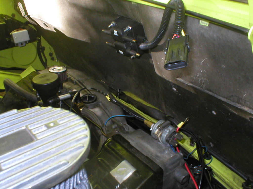

I won't bore you with photos of the drop, we've all done that a hundred times, but here are some photos of the mock up of the ITB's and a spair coil pac floating around the shop, done to get more accurate measurements for the harness to be constructed/supplied by SDS. The wires for the injectors and sensors will run across the back trunk firewall, under all the new fuel lines, and attach to the back firewall with some neat "tree" style zip ties I found, where the plastic "tree" will go into 2 holes in the back trunk firewall, and tuck the wires up and out of the way.

ITB left

ITB right

I forget how long my injector harness is, but the plug in is dead center so I'll measure it and we will make it a hair longer. Then it should go agaist the back firewall nicely.
Also see if you can find a crappy old ashtray and copy my mount for the programmer, it works perfectly.

BTW your aircleaner is crushing because you're cranking it down to tight, use a bit of the weak loctite and leave them a little loose.

Good guess on the aircleaner, but in reality, it was due to un-supervised nephews loose in the garage... generally, you'll NOT find toys on the workbench... thanks guys. I'll be giving you a call tonight to discuss the harness lengths and some other details. Any sign of the $$$ yet?

I'd make the injector harness around 43" to 44" if you want it to run along the rear firewall. This is to the longest wire, 3" spacing.
You will also need:
1- 1 to 5 amp in-line fuse to the ECU
1- 10 amp in-line fuse to the injector harness.
2- 15 amp in-line fuses to the pump and coil pack
I also have a 10 amp in-line fuse to the pump relay, but I don't think it's really needed.
He's using 30cc/min Ford redtops (bosch) I believe for injectors.

Weekend update: Slow progress with relatives in town. Got my brother in law to help with the engine drop, so thats done. Discovered BOTH motor mounts were sheared. And who says 914's got no power? Started taking tin off the engine to scope out the hall sensor mounting options. Got the new engine room rubber seals in. Was thinking of trying this with the motor in, but since it had to come out, no better time than now. I would think it COULD be done with the engine in, but I wouldn' t want to be the guy to try... Ordered some of C.F.'s fuel lines, he's a week or 2 out on those.
If someone can school me on how to load multiple photos on one posting, please do.
Now, some photos.
