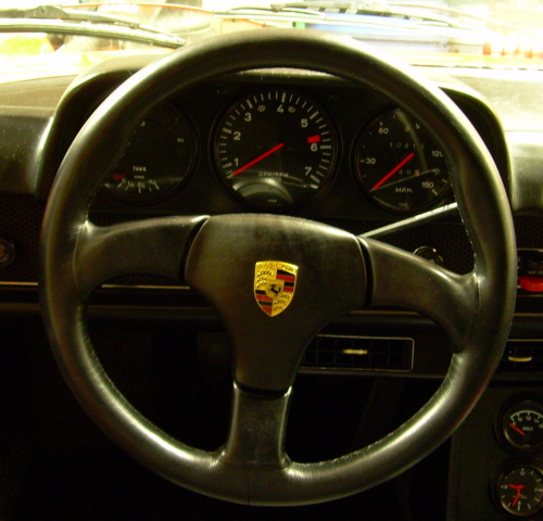

I have one other complicating factor. My 914 has a 930S steering wheel. Anybody know how to remove the horn pad on this wheel? I'd hate to bugger it up getting it off.

Google says:
The horn pad is attached to steering wheel by three pressure snaps at each spoke. Remove the pad by pulling away from the steering wheel

Thanks Doc, and all. Horn pad came of by simply tugging on it (very lightly at that). BTW, you don't have to remove the under dash AC unit to get the lower dash piece off. WHEW!

Wow, 930 wheel is on top of the sexy charts. Better than any MOMO I've ever seen. How much and where can I get one?

QUOTE(JPB @ Jul 4 2006, 05:39 AM) *
(IMG:style_emoticons/default/beer.gif) Grassyas!
JPB,
found 1997 receipt for 930S Steering wheel and adapter from PO. AJ racing Part Numbers, wheel - AJR 348 082, $240, adapter - AJR 347 085 00, $85. (IMG:style_emoticons/default/blink.gif) Remember, that is 1997 $'s. Probably double or triple that now.
