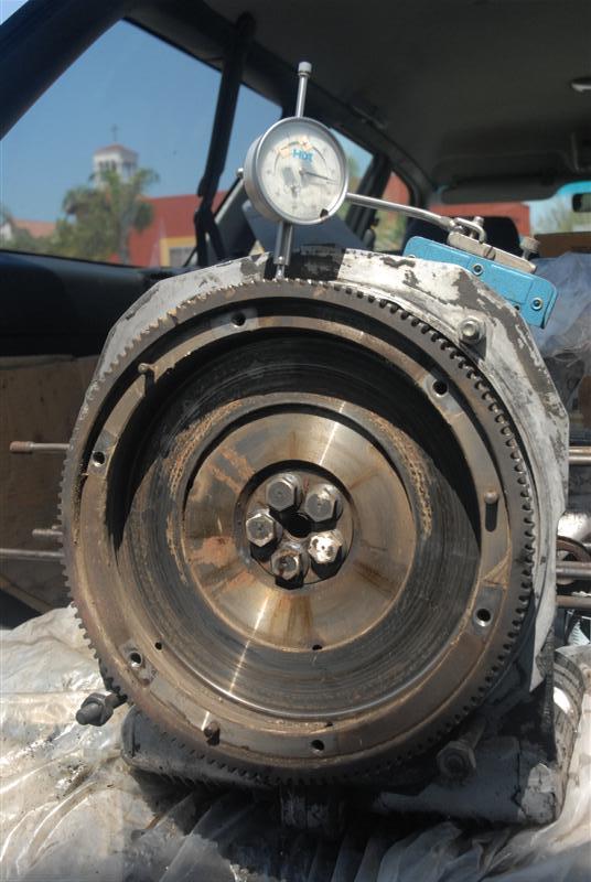

measured the radial play at the flywheel (as shown) by prying from the bottom to find the freeplay.
The result was a solid .005-.006 movement up and down. (IMG:style_emoticons/default/blink.gif)
What do you guys think?
One source tells me any more that .002 and its considered worn. .007 is worn out.
another friend of mine questions the conclusion of this measurement.
So...... need new bearings??
Thats the big decision i need to make right now.

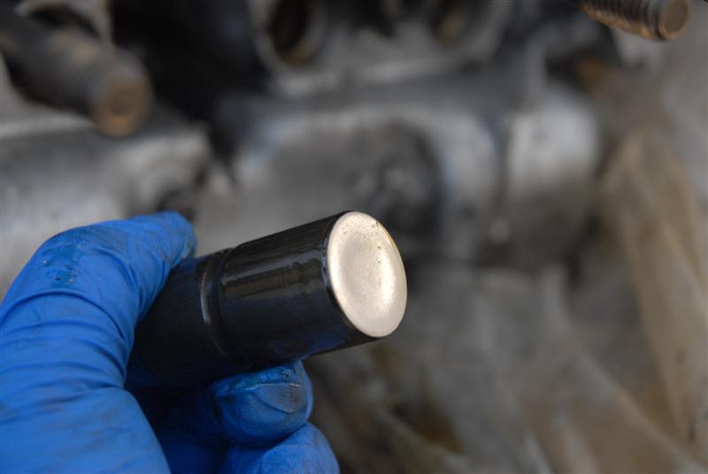

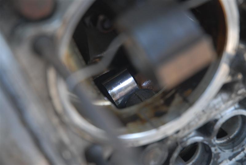

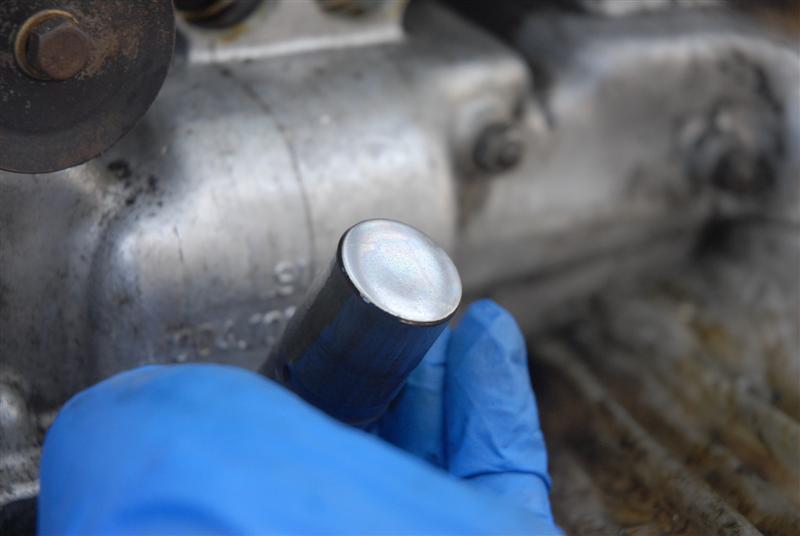

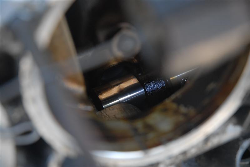

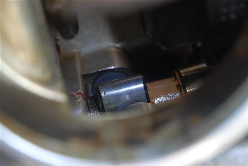

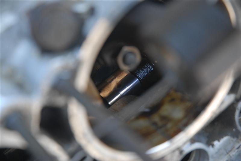

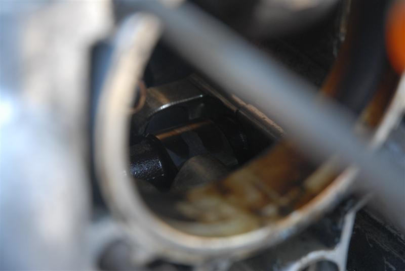

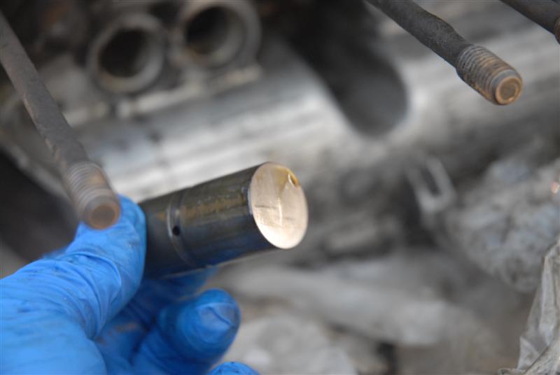

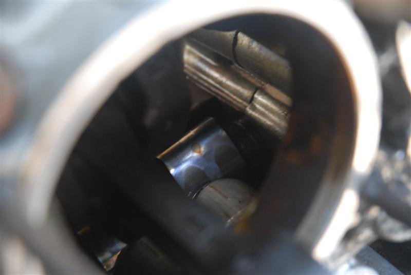

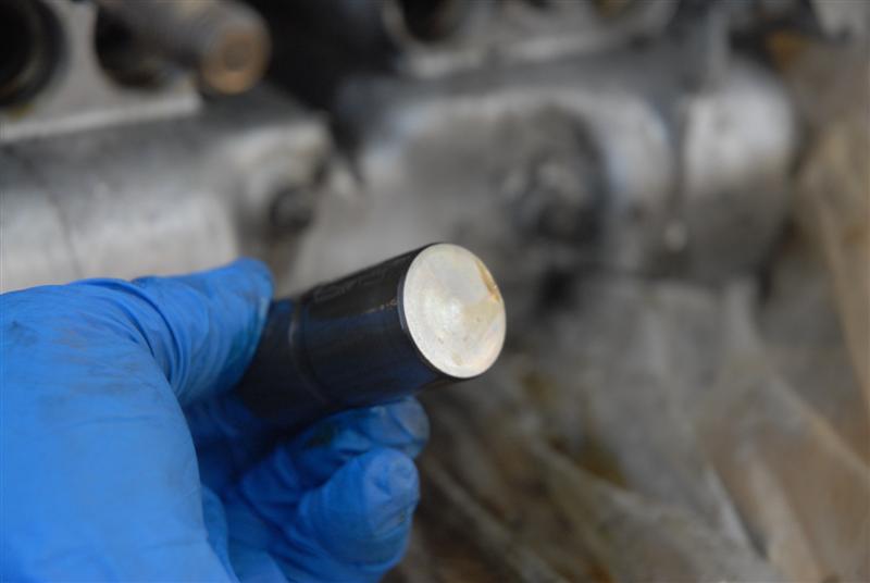

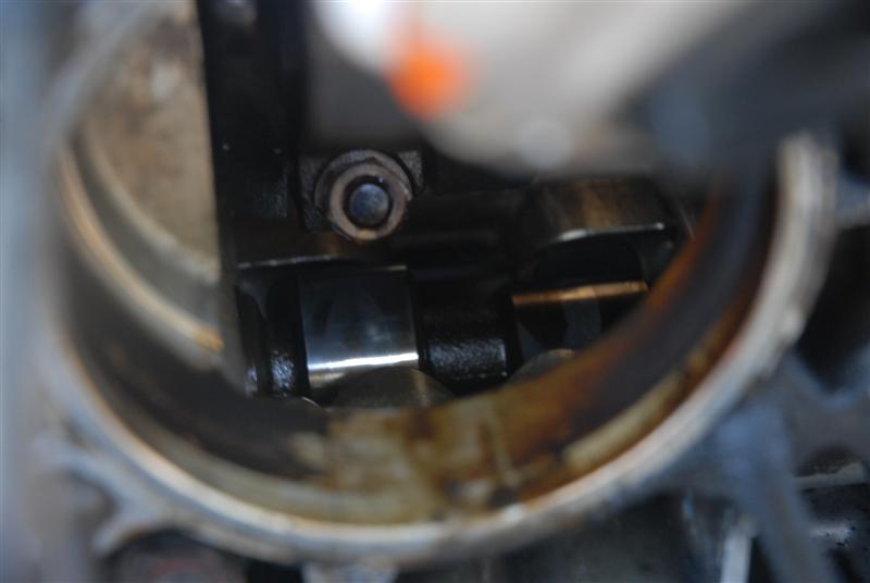

To help this assessment i have attemped to shoot the lobes of the cam, which look to be showing some wear. Maybe the pictures are worthless.. but at least they are in focus. (IMG:style_emoticons/default/beer.gif)

cam lobes

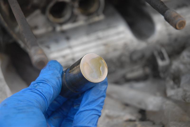

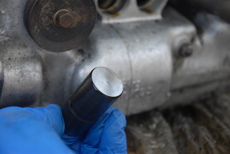

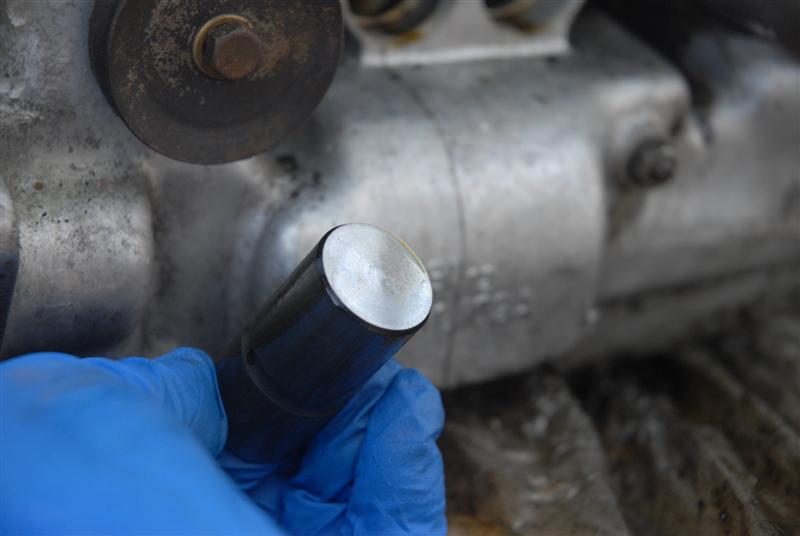

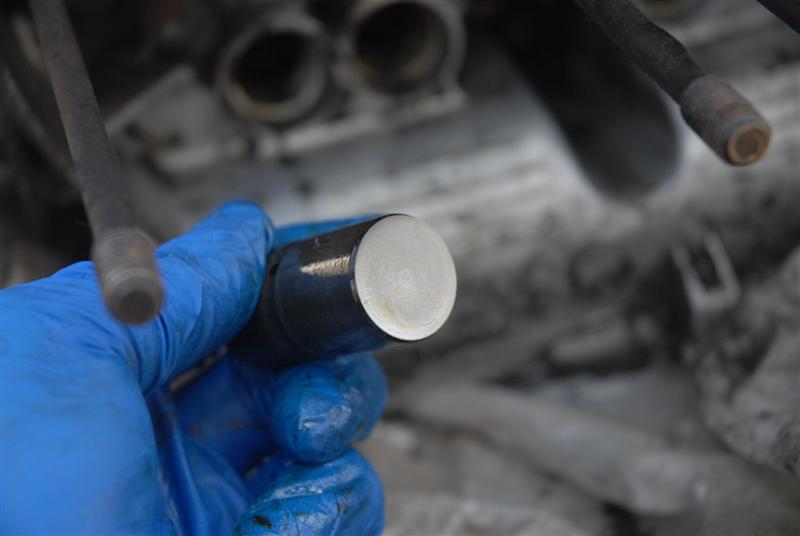

lifters seems to be still decent, no pitting just a little dish in a couple.

Dished! they should be replaced with a new cam and matching lifters.
click on this link
While you are in there replace the main bearing to tighten up the slop you measured and check the bearing crush with plasticgauge.

Some of your lifters show heavy wear. Your cam shows normal wear for a high mileage motor. Neither should be reused. Fix it right the first time. Just your peace of mind after the rebuild is worth the $600.

The pics of the cam and lifters could be used to demonstrate what a text book worn-out set look like! Welcome to rebuild time!
