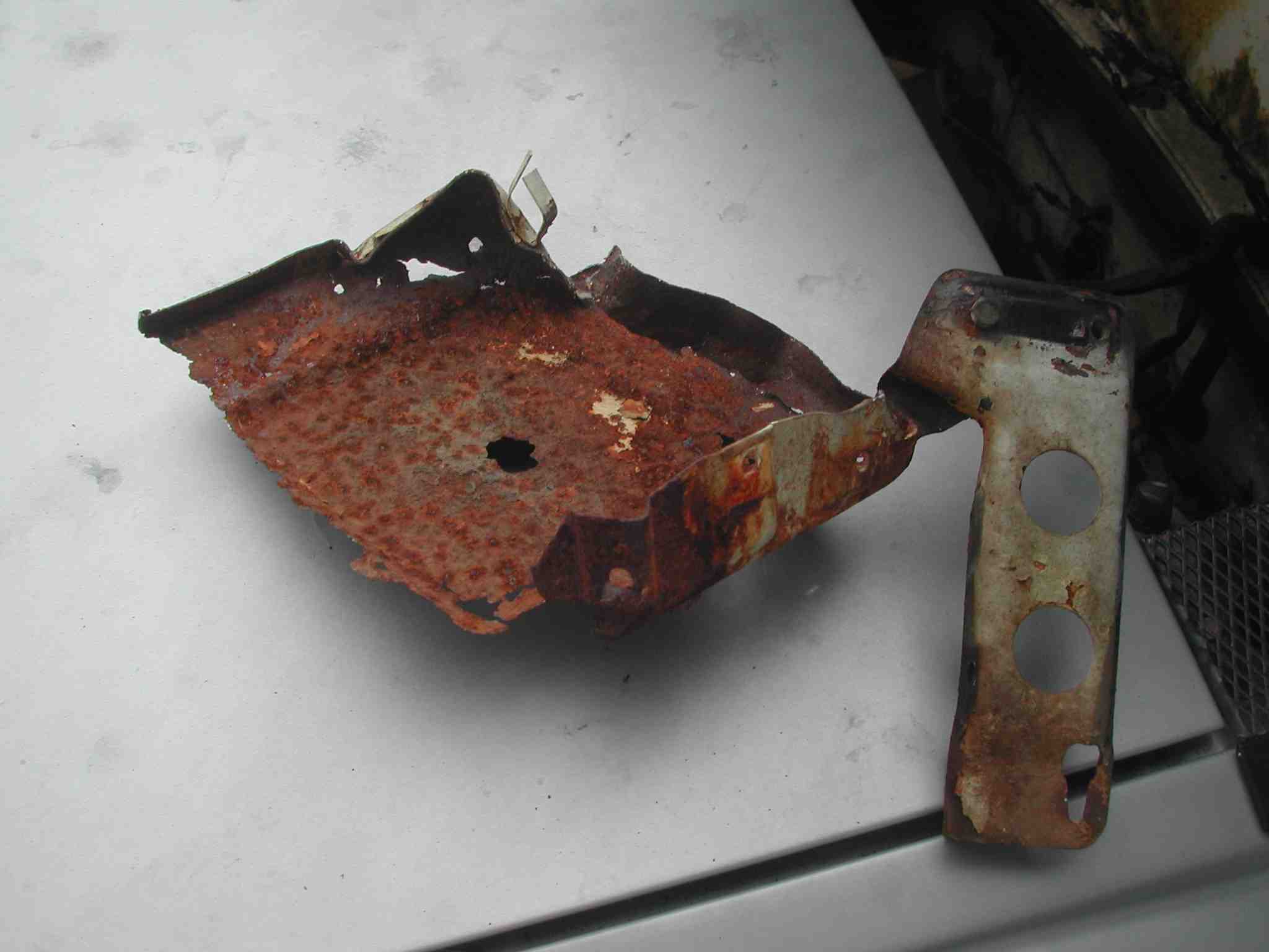

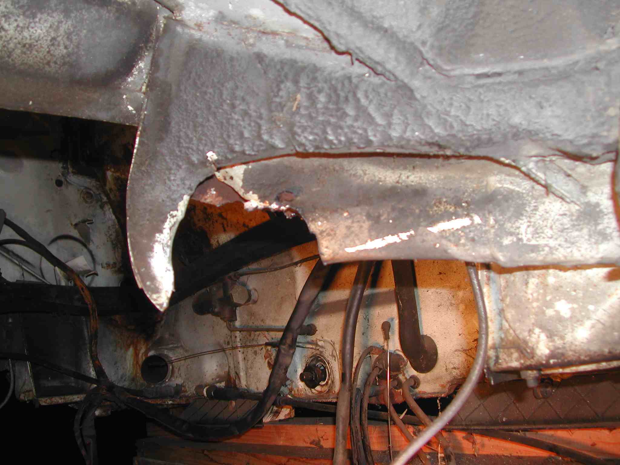

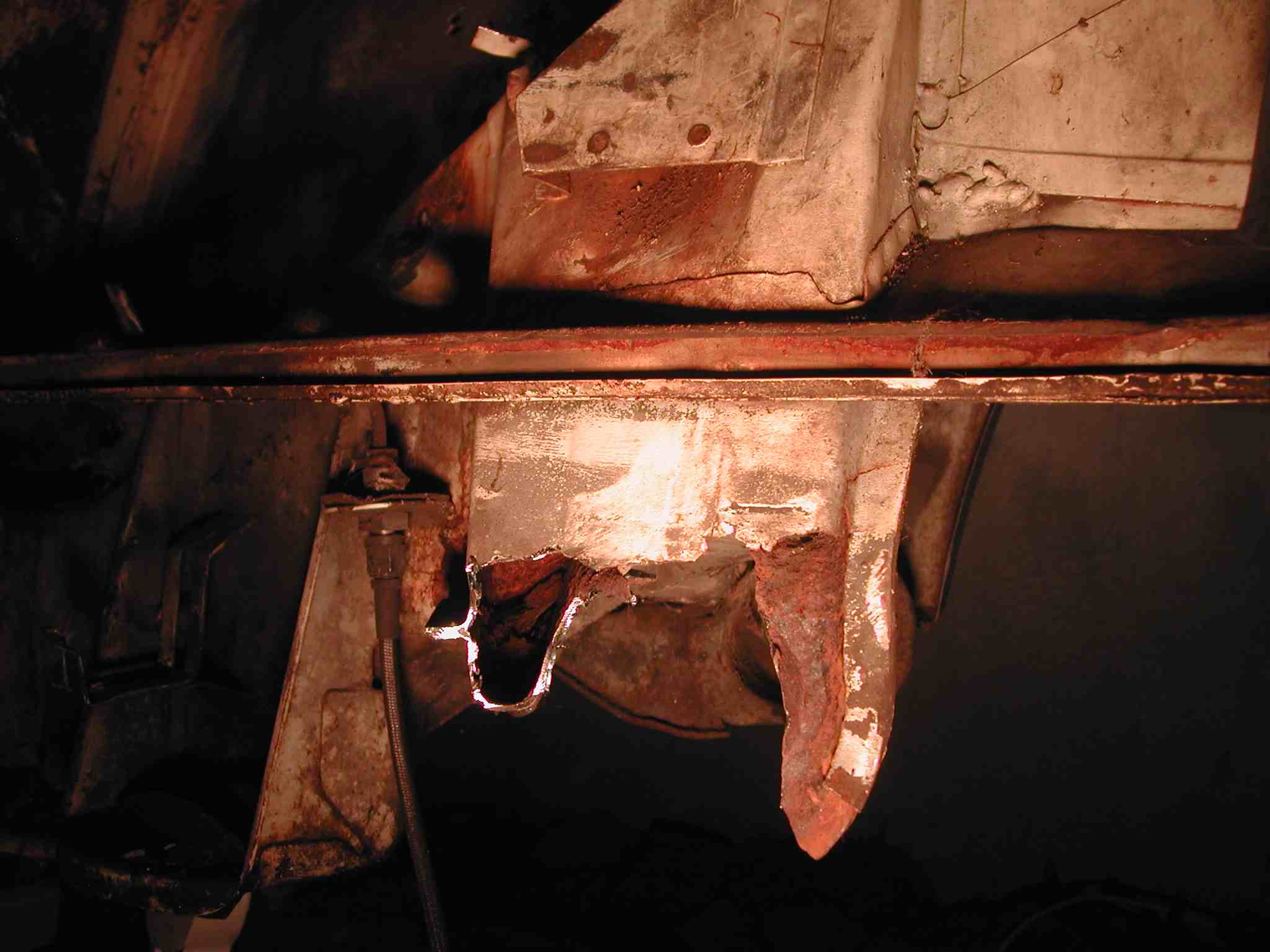

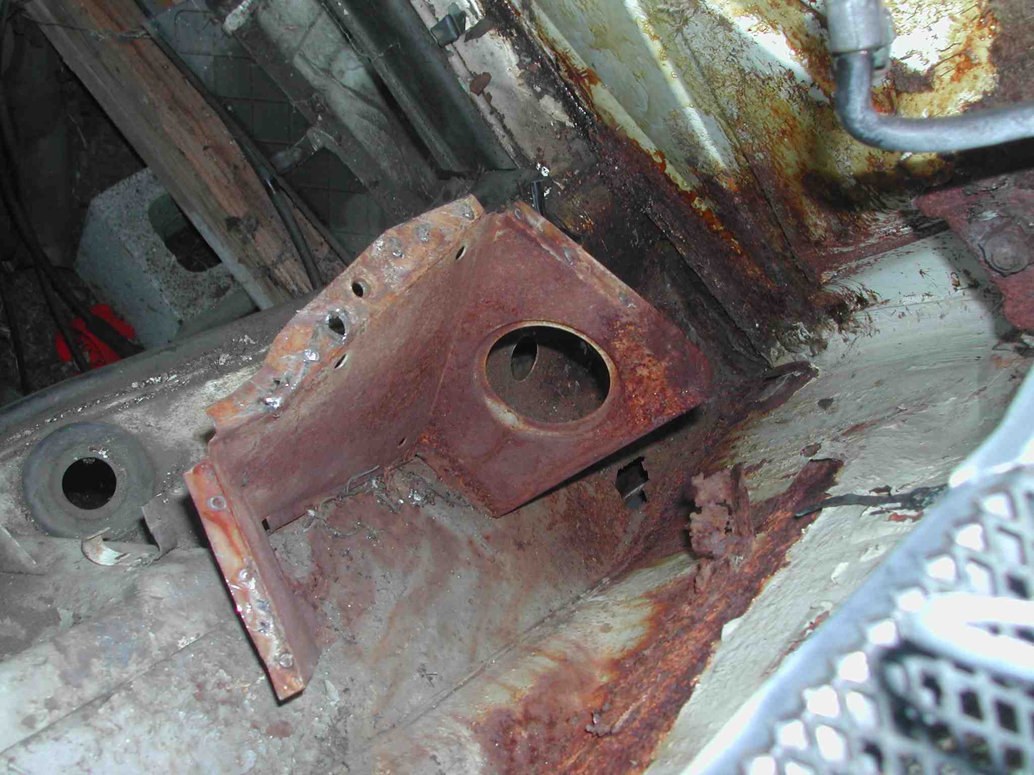

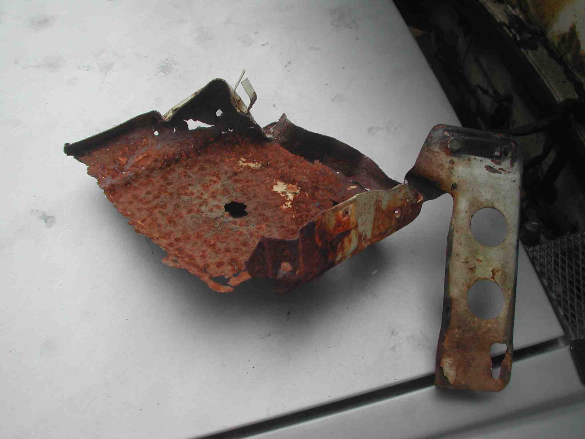

Here is what was left of the Suspension Console.
view from the engine side

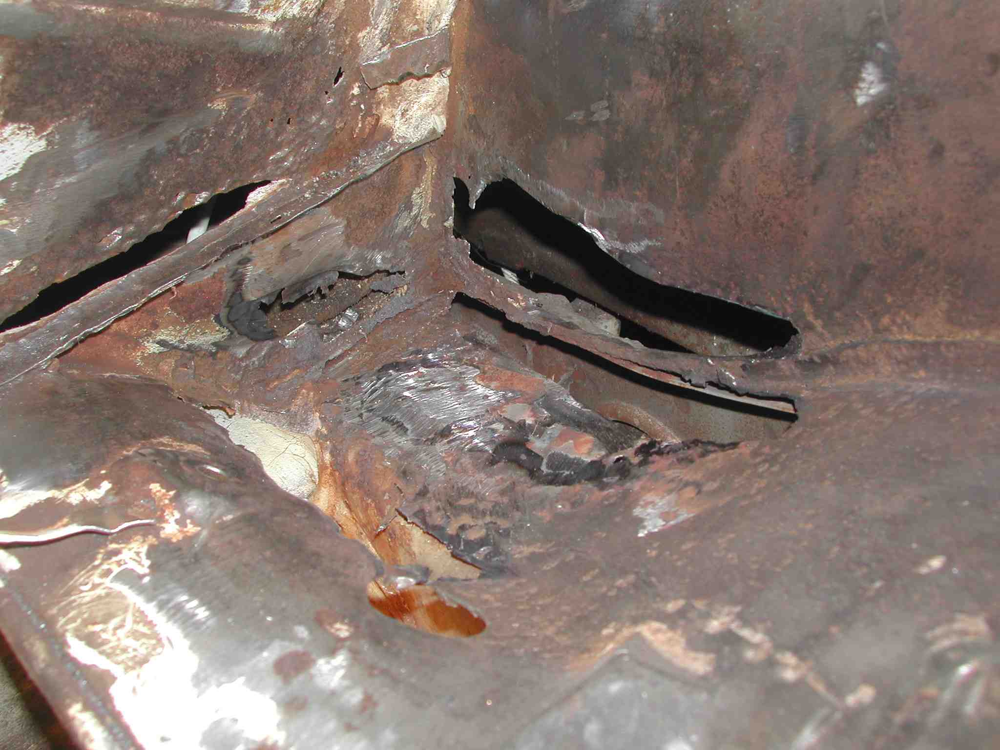

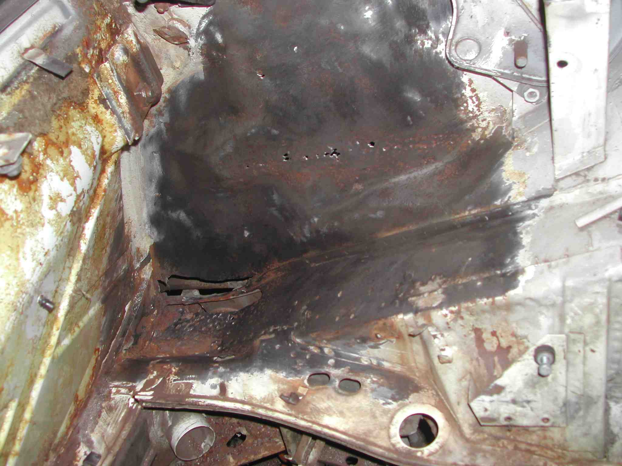

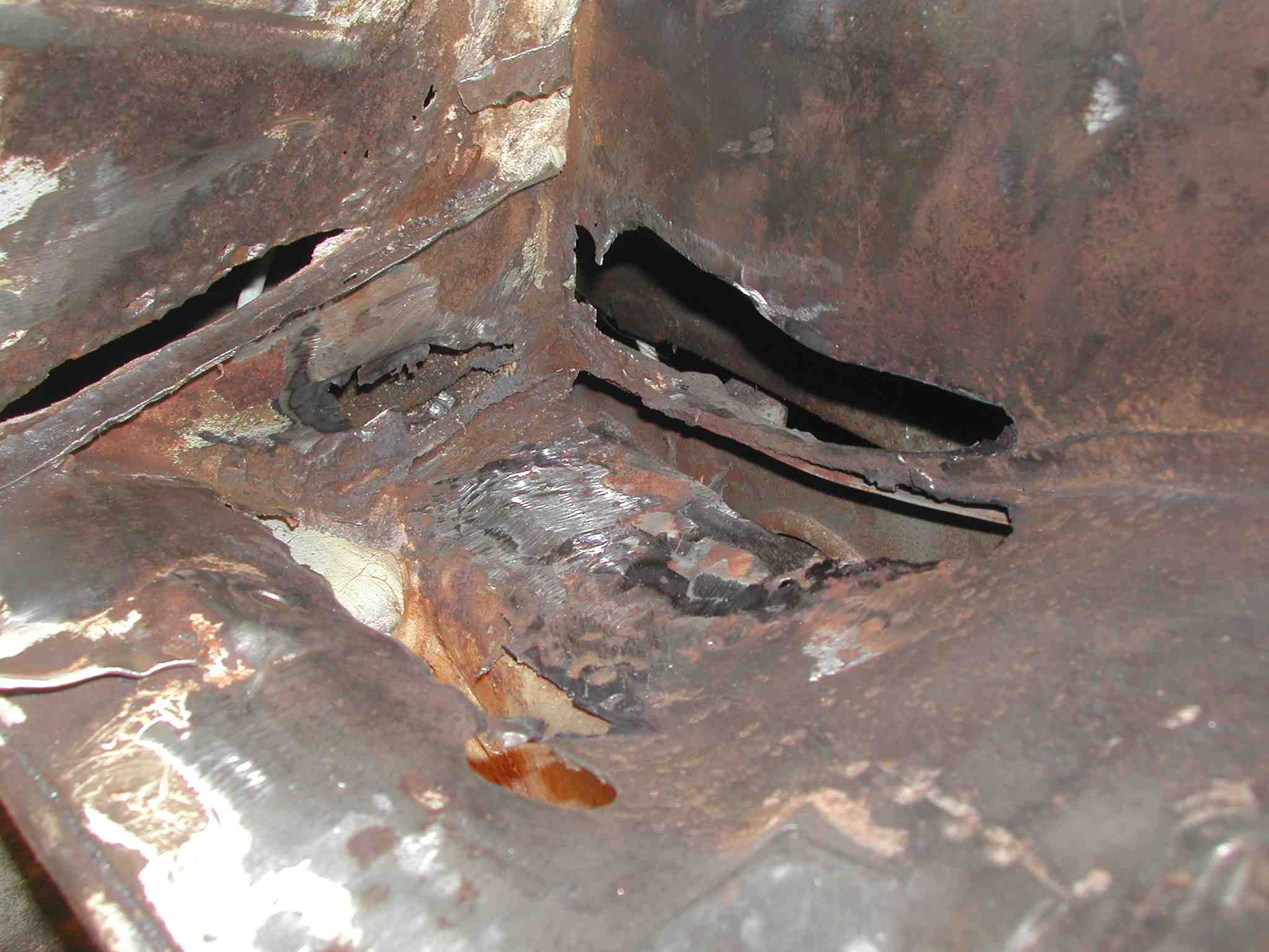

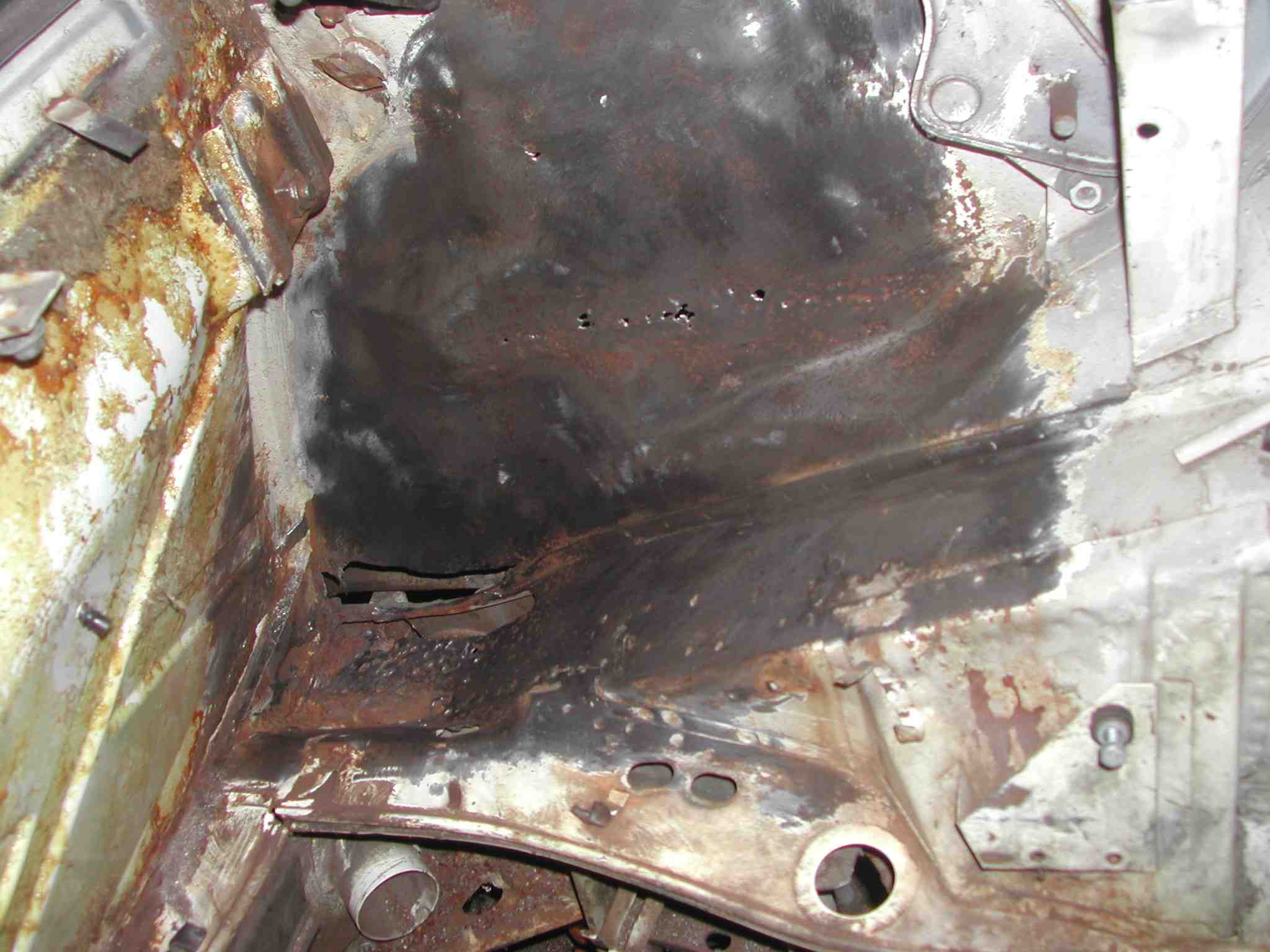

hell hole looking down
hell hole view from engine

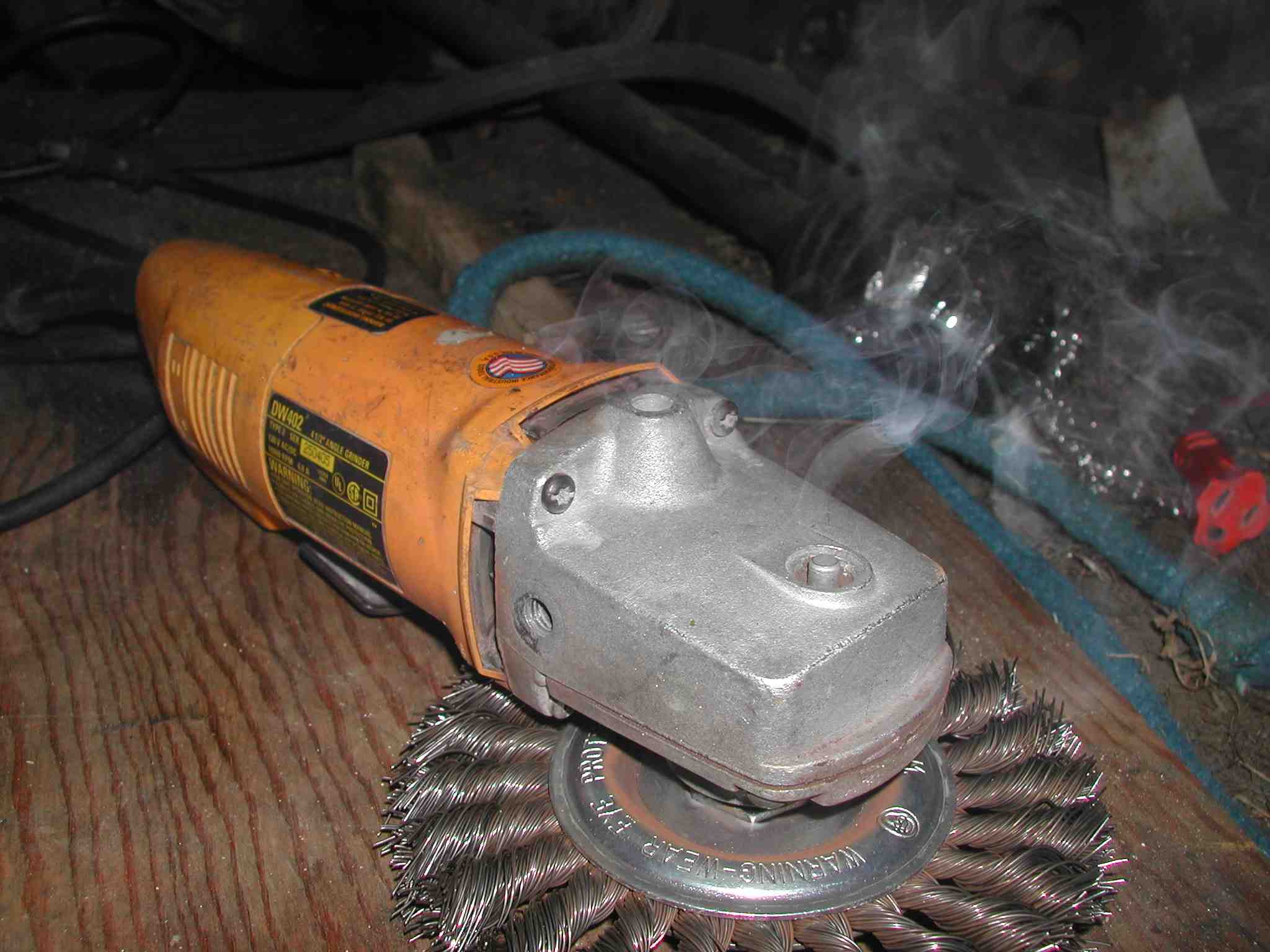

Batteries? We don't need no stinking Batteries!!
I finally saw the light... thank you Dewalt.

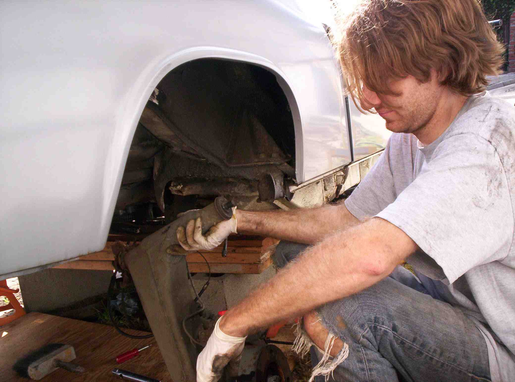

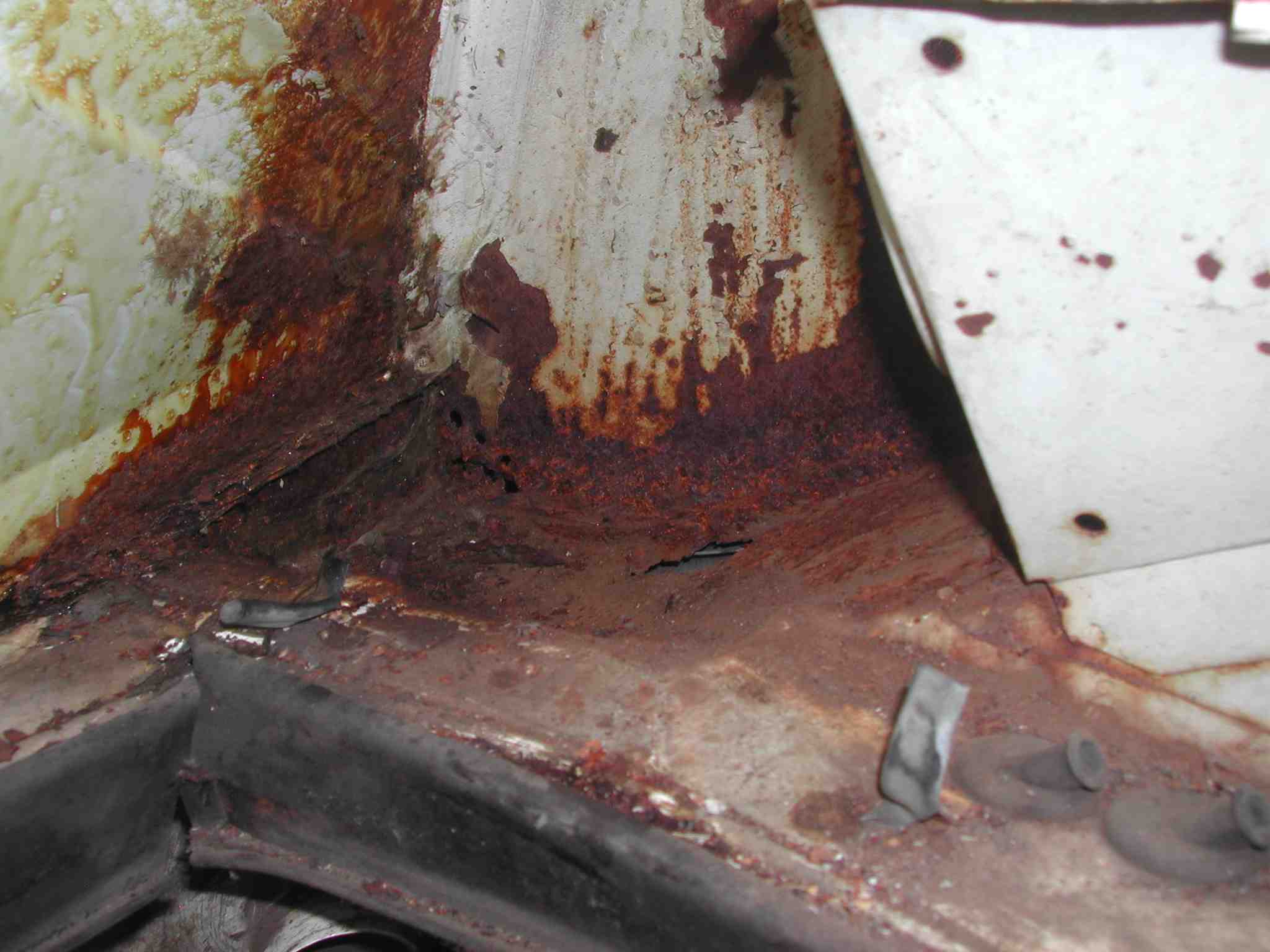

This after I went Ape Crazy on that (IMG:style_emoticons/default/stromberg.gif) (IMG:style_emoticons/default/monkeydance.gif)
here we are close up to hell... is it getting hot in here?
No, I didn't get them yet... send em over... time to post!!!

Yes it's getting hot in here...
It smoked for 15 minutes and was too hot to touch for a full HOUR... I thought it was toast... but it's ALIVE!!!!! (IMG:style_emoticons/default/happy11.gif)

Great picture... now put the bong away and get back to work!
Put some wd 40 or something (not paint. welding doesn't "stick' to paint) over the area you've grinded or it may start to rust again....

Yeah it already started to rust again... 12 hours later and it's rusting. WD40 sounds like a good idea. Anybody else have some suggestions? Proto31 mentioned using a weldable primer paint... anybody have experience with that? Welding is going to happen within the next month, but the rust is a fast mudder fudder. What's the best way to protect the work I get done as I do it? (that I can then weld on ofcourse)

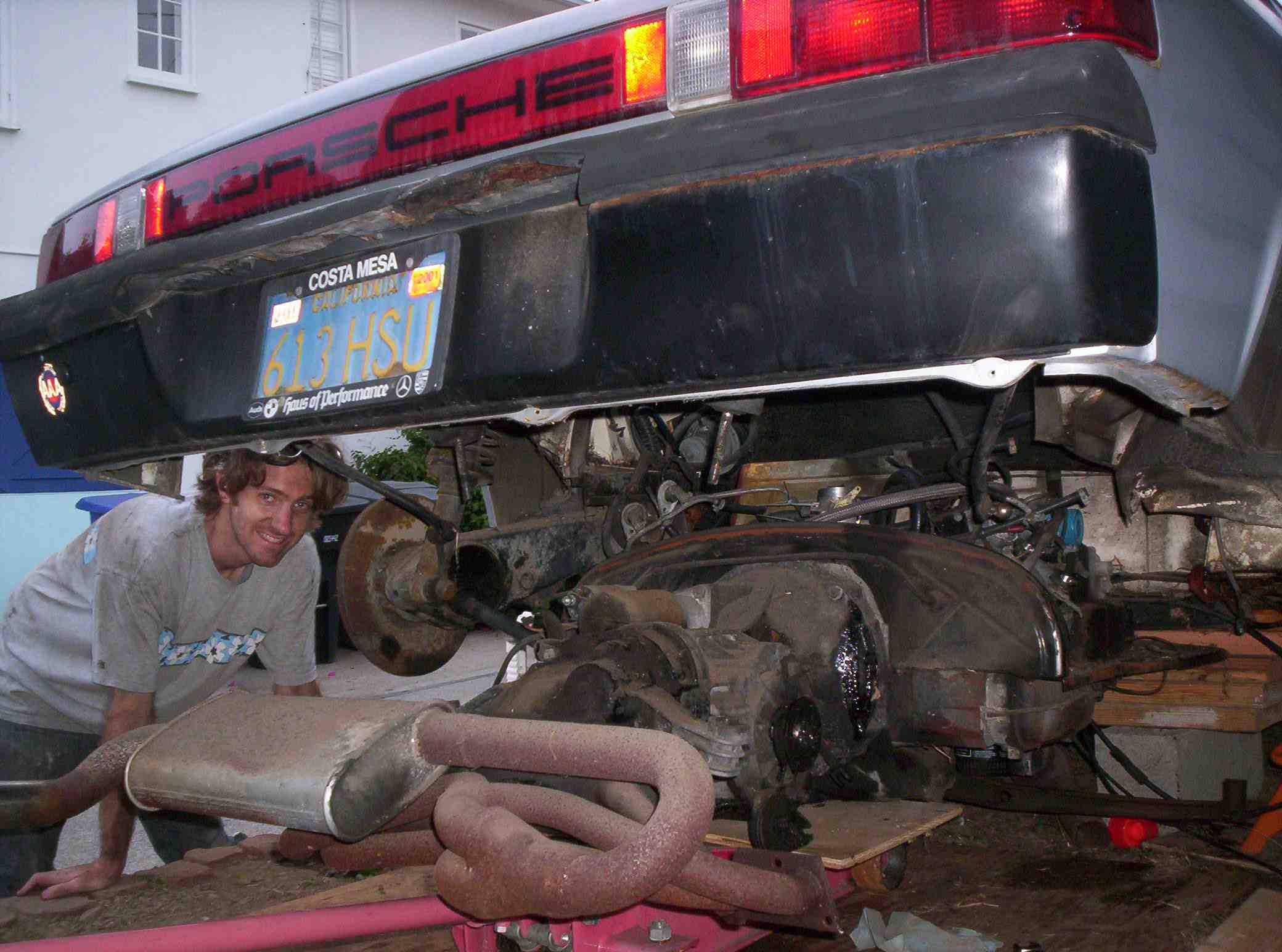

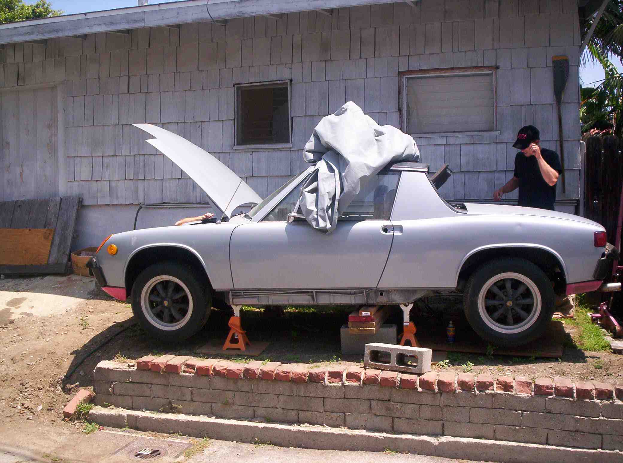

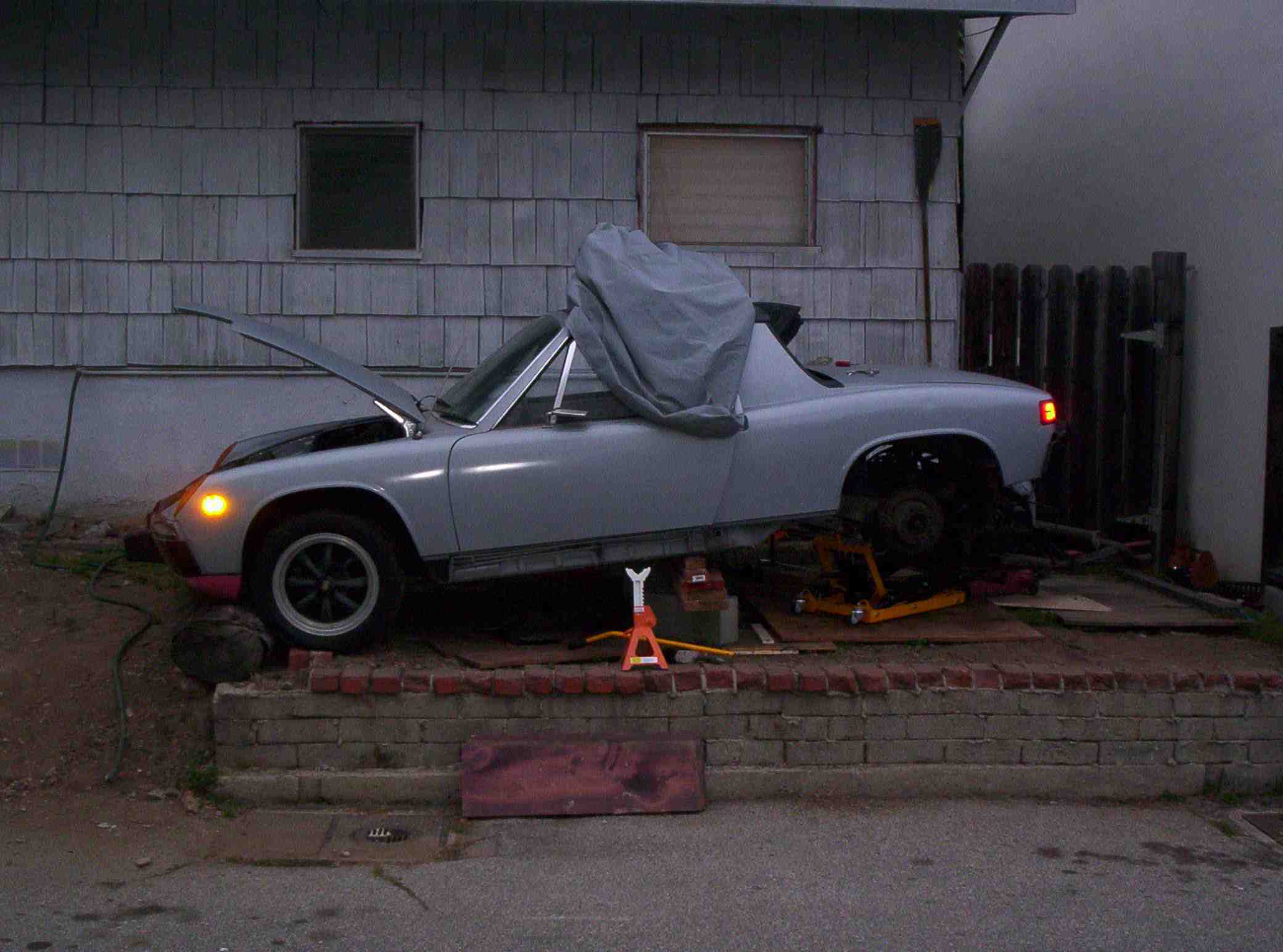

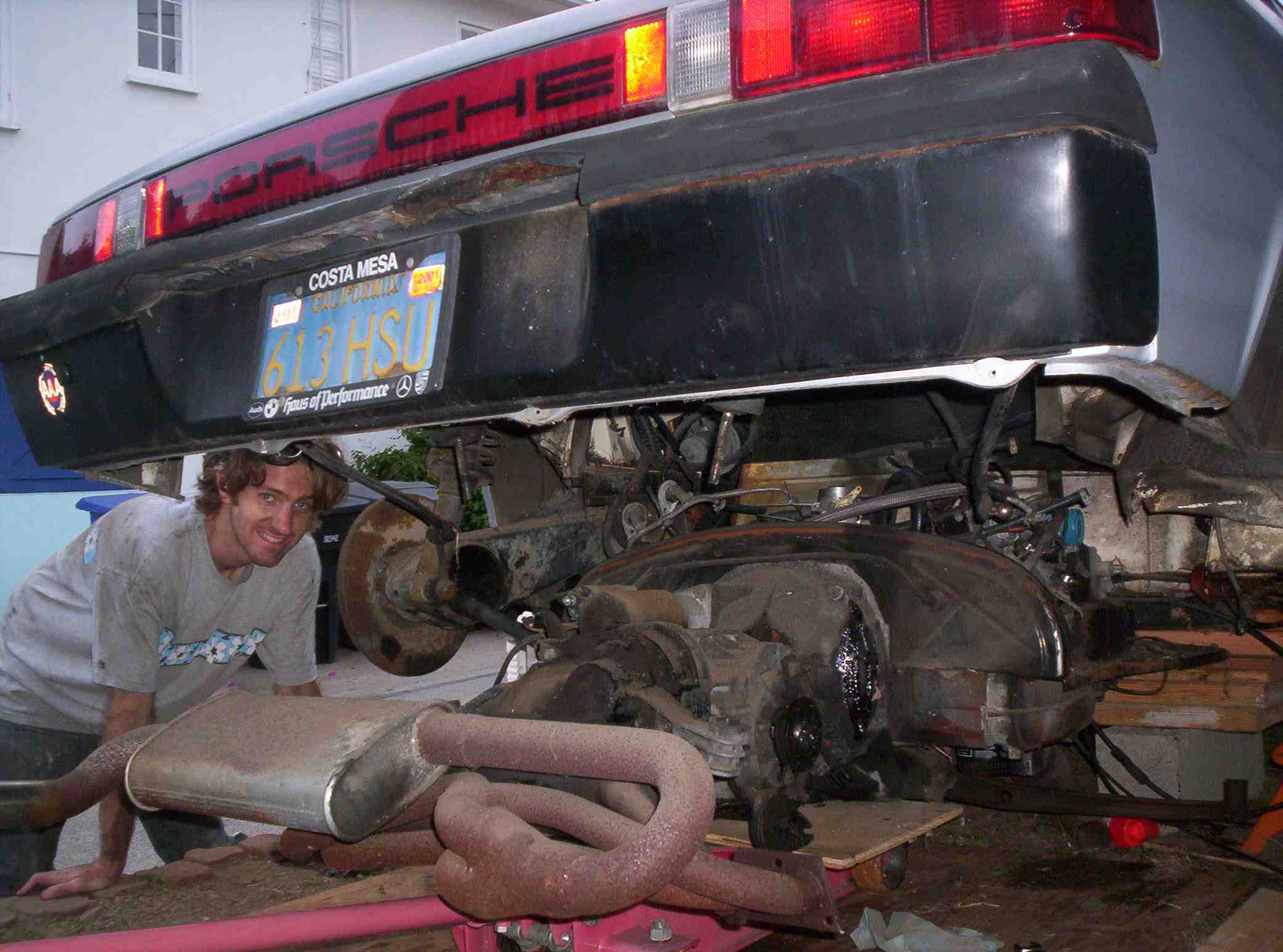

REWIND<<<<< Day One: The Engine Pull
Welcome to the Porsche Restoration Factory @ the Ghetto Garage
Hey!! Is that Proto31 spying on my progress, or is he trying to sabotage my efforts thinking he's got this bet in the bag? (IMG:style_emoticons/default/cool_shades.gif)

dude, we need a timline or something. It took us like... 3 1/2 hours to get to this point, right!? Jacking on dirt is dirty buisness....

No kidding, and it didn't help that my 'driveway' is listing to one side about 15 degrees.
Proto31 ran and hid as soon as I started throwing this (IMG:style_emoticons/default/stromberg.gif) at him

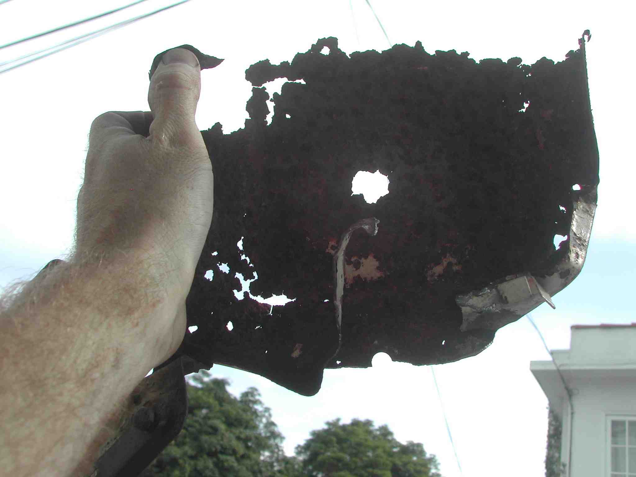

The dissapointement of the family....
Wowsers! Dr. Bottomend what have you done?

Ghetto Garage Engine Drop Manual page 6.9 "Always use your hazard blinkers when playing with big toys"
Aren't we about 8 hours into it at this point? Time to roll it into the backyard, I mean engine vault. Notice the tree stump preventing certain disaster in the Porsche Restoration Alley.

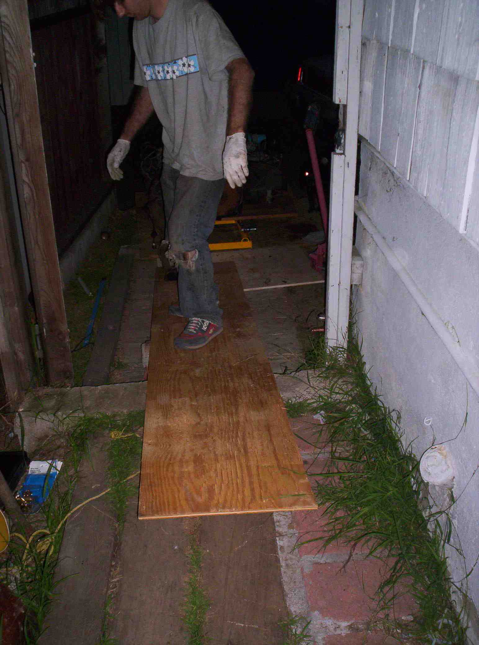

Check out this Egyptian Engineering marvel. We had to roll 'up' into the backyard, I mean engine vault, with about a 8" grade.
And there she lays. If I had followed Proto31's advice... he would've had me digging a hole in the dirt directly under the car, then dropping the engine into it Mexican style. Then he suggested I'd be better off just filling the pit back in with dirt and lay the damn thing to rest. Sorry to dissappoint you Protozoa.

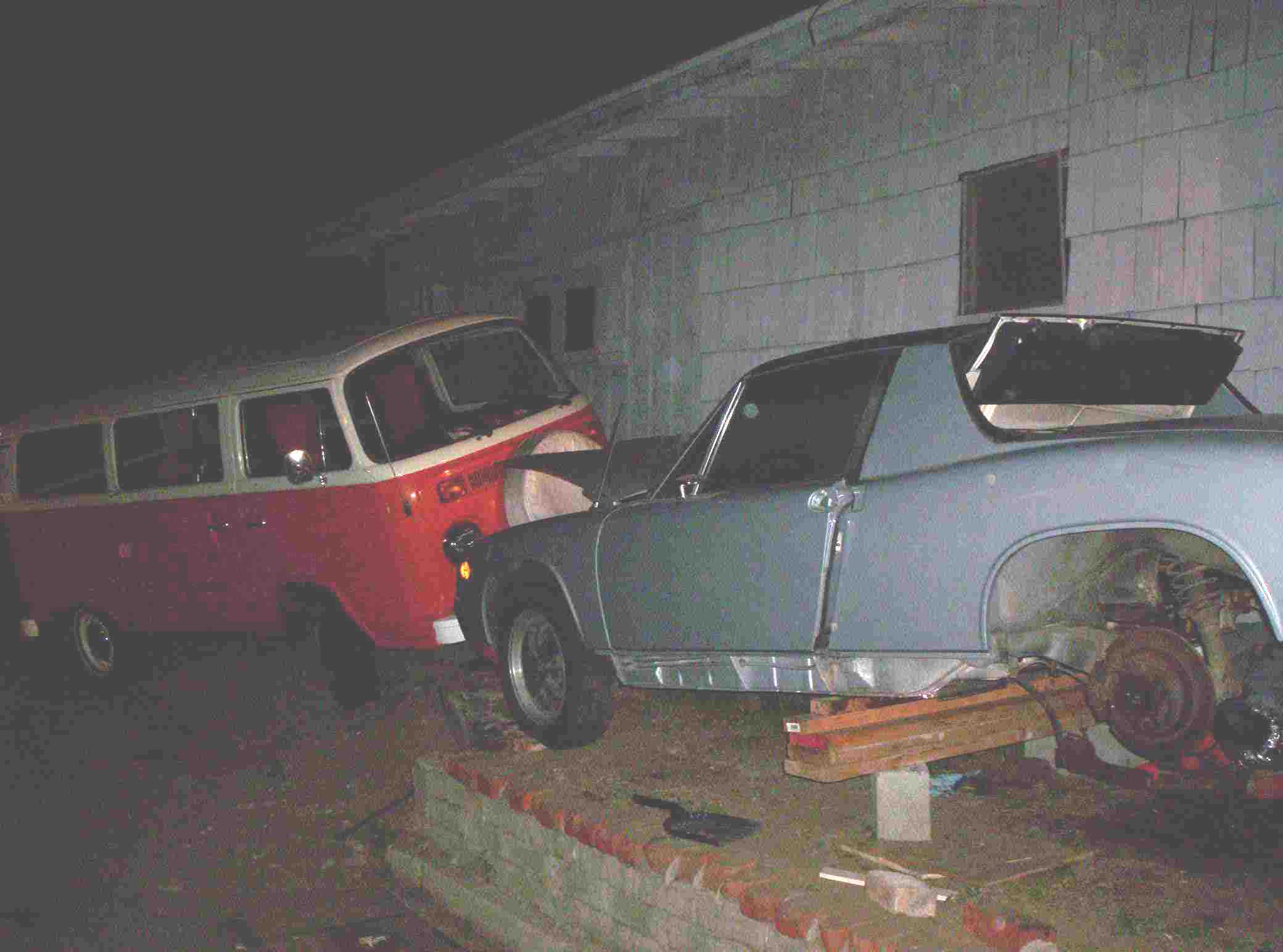

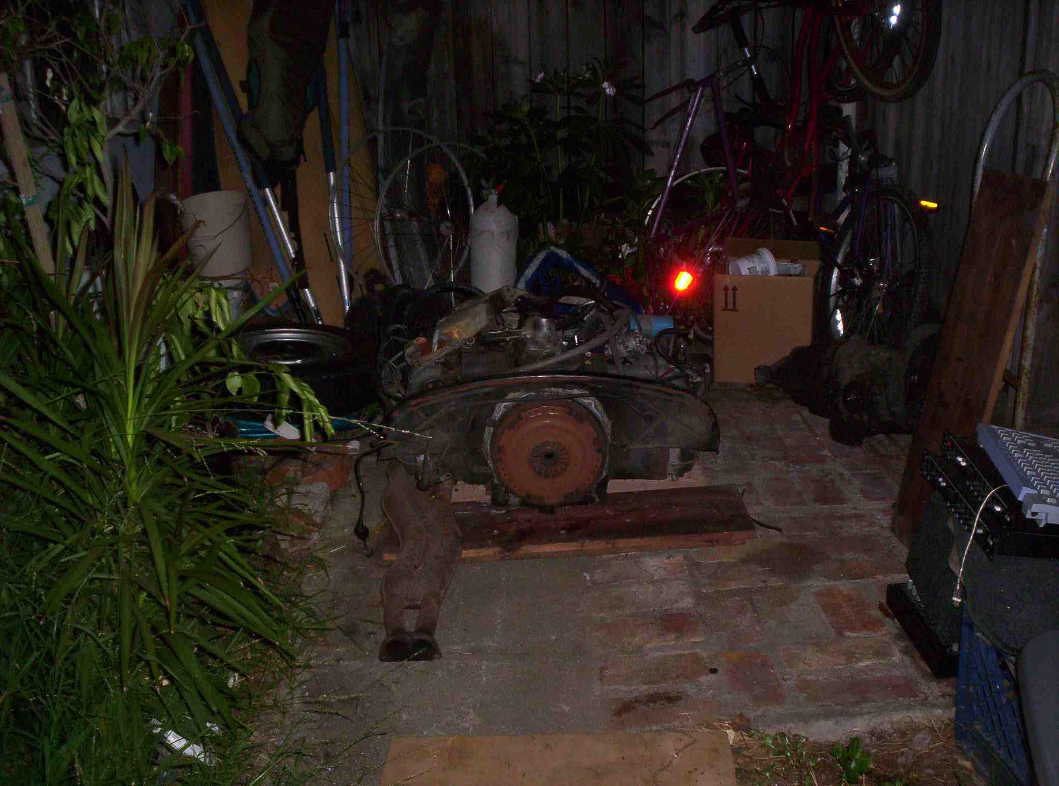

And lastly.....
Here's a VW helping a Porsche. Who said they couldn't get along?
bottomend
post Jun 27 2006, 08:41 AM
Posts: 180
Joined: 27-August 05
From: LA,Ca
Member No.: 4,683
The goodnight kiss.... (IMG:style_emoticons/default/KMA.gif)

I don't know about weldable primer, you do need a good ground and clean metal
to arc to. The liquid in WD40 is a carrier for graphite once the graphite is in place
the liquid is designed to evaporate, you might want to use something more like
gun oil. Sirandy summed it up well, it will be worth it once you are behind the
wheel again, canyons are fun.
