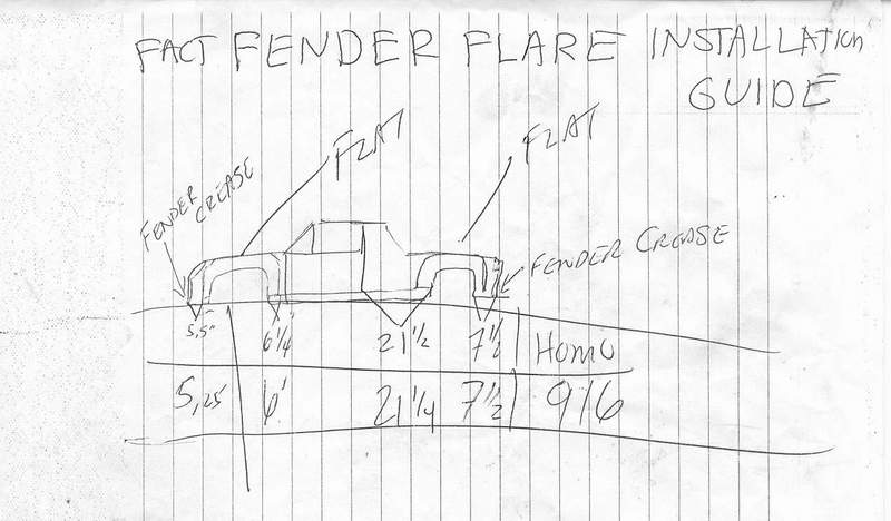

If you use the flared rockers as a reference point for the fenders you will not be centered on the wheels. All the flared rockers are off by about 1-2 inches. I centered my steel flares on the wheel opening. I took a set of AIR flares(pos) and spliced them on another set of fiberglass rockers to make everthing line up.
Phoenix-MN
post Aug 6 2006, 08:20 AM
Posts: 927
Joined: 23-January 04
From: ST. Bonifacius,MN
Member No.: 1,590
Attached ImageDepends on the rockers that you get. I used the dimensions that were measured off a 916 and a 914GT and everything lined up as it should. Check the dimesions on centering over the wheel opening vs. these. I bought several different sets of rockers before I got ones that were right.
