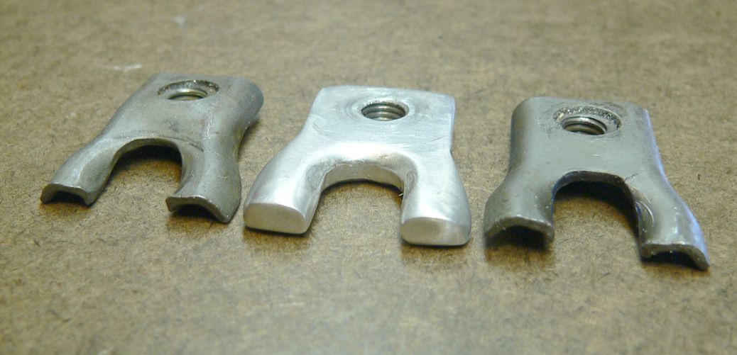

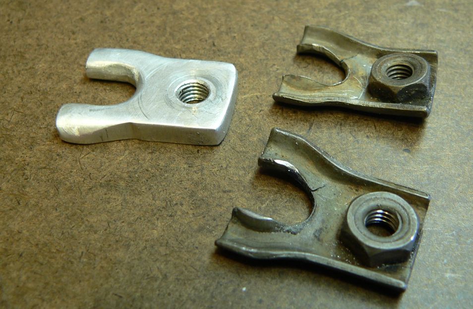

A clube member (Thomas) gave me one of the clips today. After I got it home and cleaned off it was cracked in the EXACT same spot. I have a feeling that like the bushing, this part is probably broken in pretty much every 914 thats seen much time on the road.
So I decided to make one from a plate of aluminum. Its much much thicker than the formed steel pieces, but it is aluminum, so I'm not erally sure how long it will last.
-Tony

Should last forever. This part doesn't do much. The force is on the ball, this just keeps the fork from falling off when you're not pressing on the pedal. I suspect they get cracked from people overshimming the ball, or adding shims behind the cup. If the clutch fork is used at a funny angle or overextended, this piece will see LOTS of force, because it contacts theshaft of the ball. Make sure yours doesn't bind in the full travel of the fork and you'll be fine.

Bondo: I think you are right. In both cases there were lots of shims. I tested this part to make sure it doesn't bind through the full travel. I had to file off a little bit, but it works fine.
So in theory with a new flywheel, clutch disc, PP, and TO bearing, as well as new ball cup bushing, I shouldn't need any shims right?
