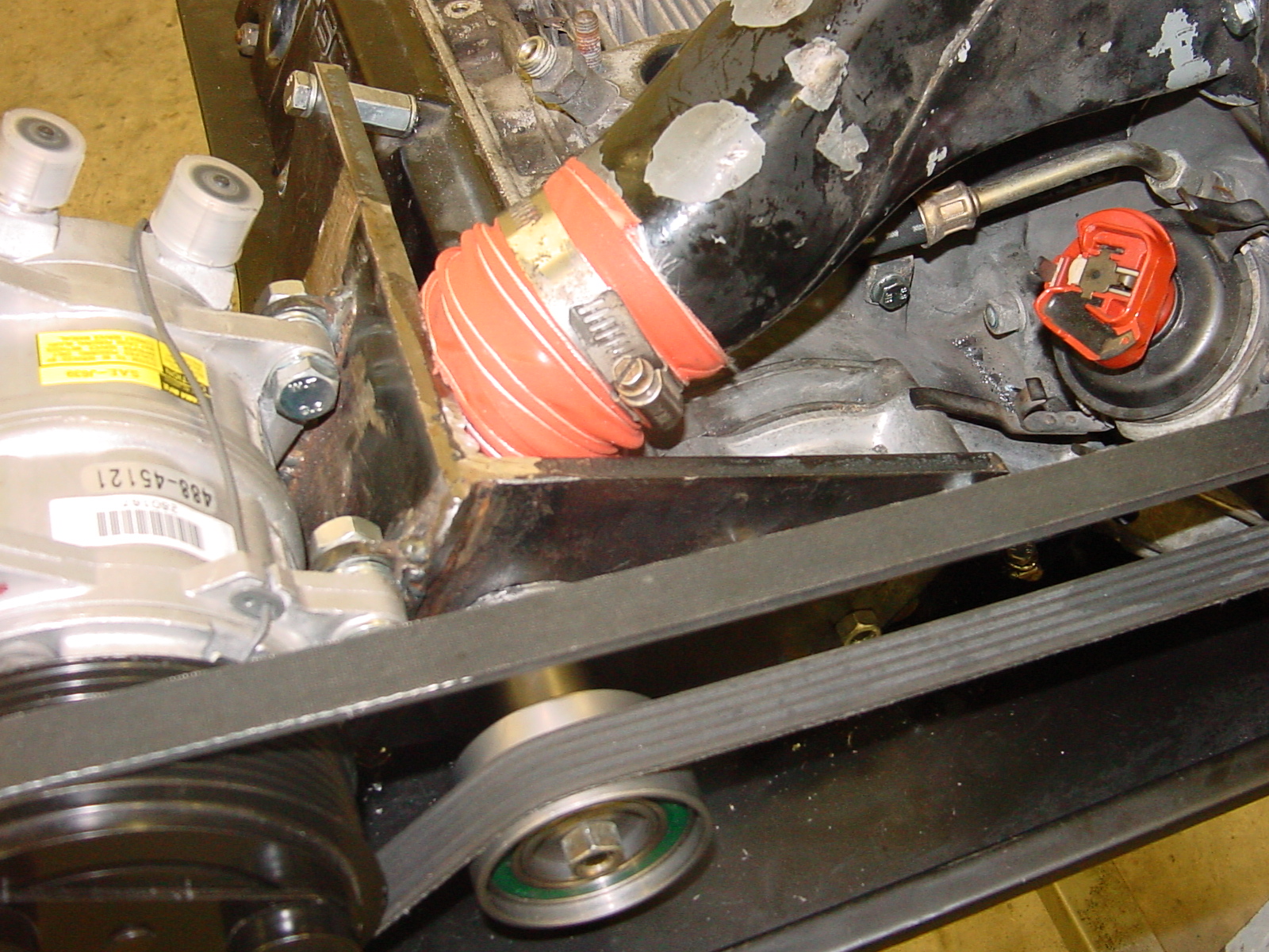

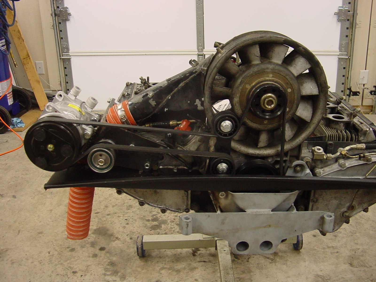

I created this for my 914/6 conversion. It allows you to put the compressor in almost the same location as in the 4 cylinder cars, plus it makes changing the belt extremely easy. No more fooling with the shims behind the fan pulley.

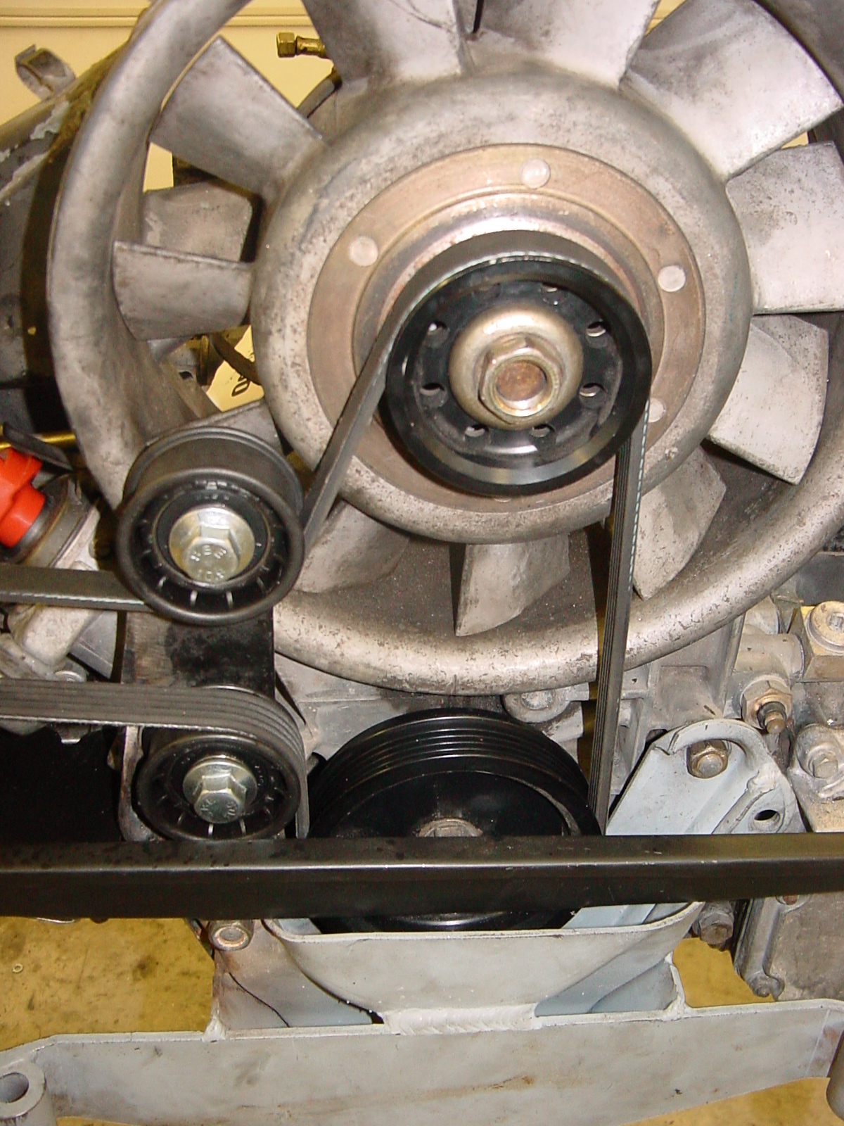

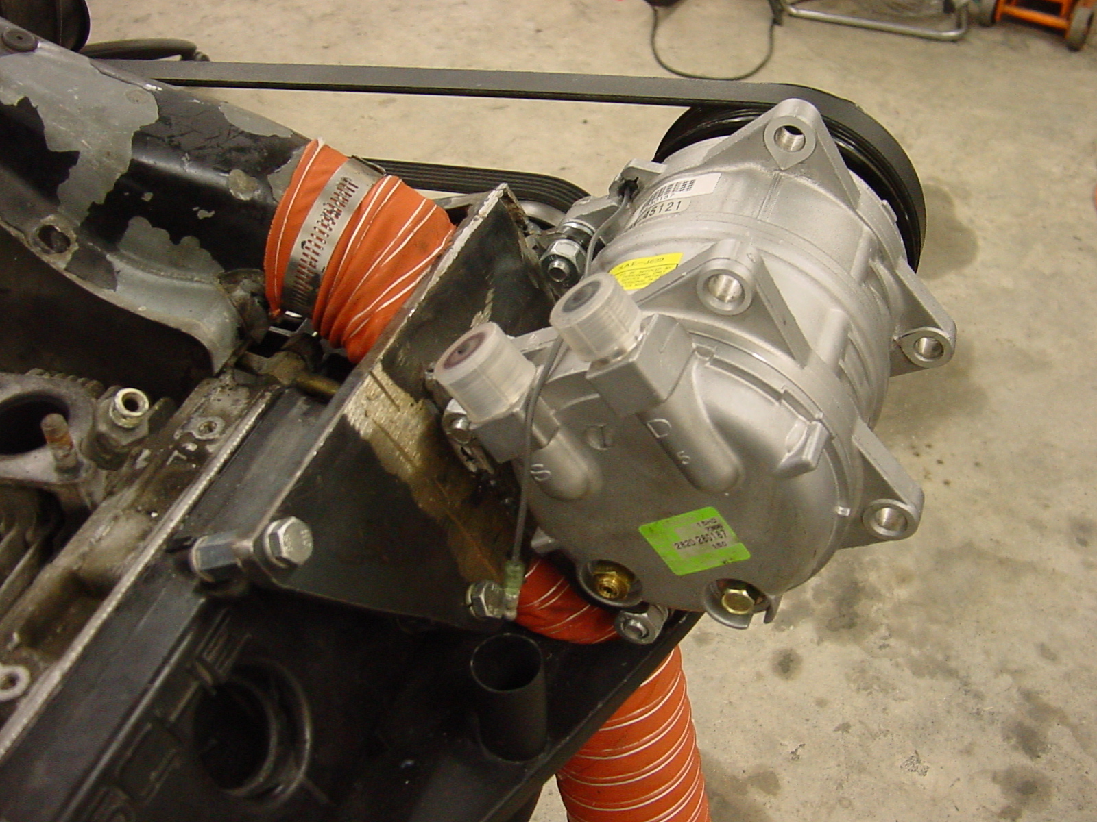

The compressor mount is custom made. The belt is an off the shelf item at FLAPS. The pulleys come from Clewett engineering. The idlers and the compressor come from IceAc. The tensioner is a timing belt tensioner for a Nissan 300ZX motor.
I added a vertical bracket to the Rich Johnson nosecone mount and installed the idler pulleys. The compressor mount sits over the valve cover, and 2 tall spacer nuts replace the valve cover nuts.
I am going to make a second version that uses aluminum, and a automatic tensioner.
But this version is on my car and running.
When I first got it running, I had a problem with pulley alignment, and it ate a belt. I changed the belt in a parking lot in a business suit and tie, in less than 10 minutes, without getting anything but my fingers dirty. The only tool I used was a 13mm wrench to loosen the tensioner. Try that on a standard 914/6 belt setup.
The only bitch I have with it is that you have to pull the compressor to change the #1 spark plug. I am going to rework that in the second version.

Pulleys close up:
Compressor and Tensioner close up:
Rear of the compressor mount:
I later drilled a hole in the bracket above the spark plug. The bracket pushed on the plug wire and damaged the top of it.

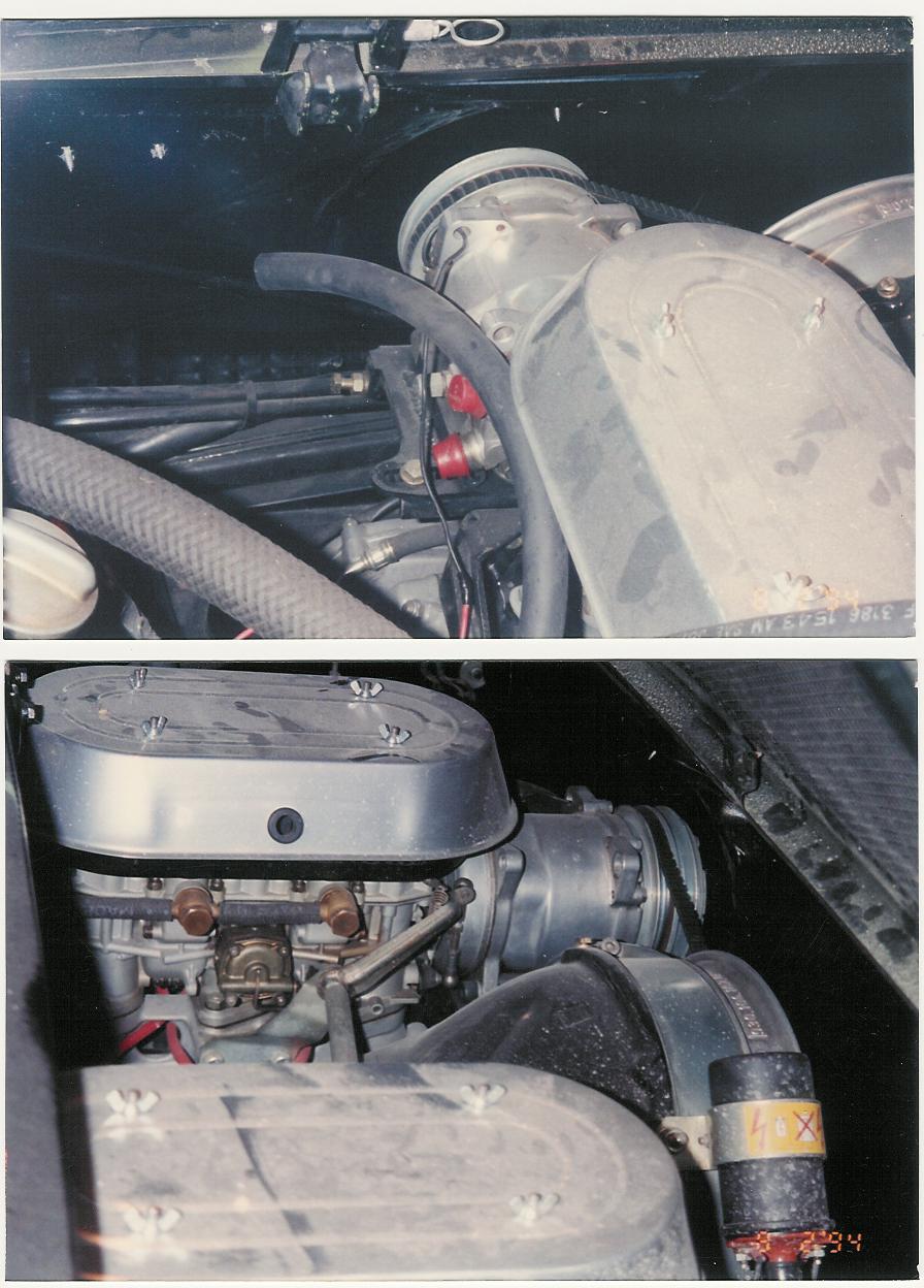

Attached ImageHere's a six with the a/c in the oe 911 location.
Note the small circular depression formed in the bulkhead, which allows for clearence. There was not much protruding into the cabin.

I wonder how much bulkhead modification would need to be done without that double pulley on the compressor. Looks like a big ole York.
I have a nice Sanden - just need a way to mount it.
