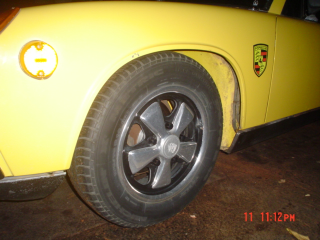

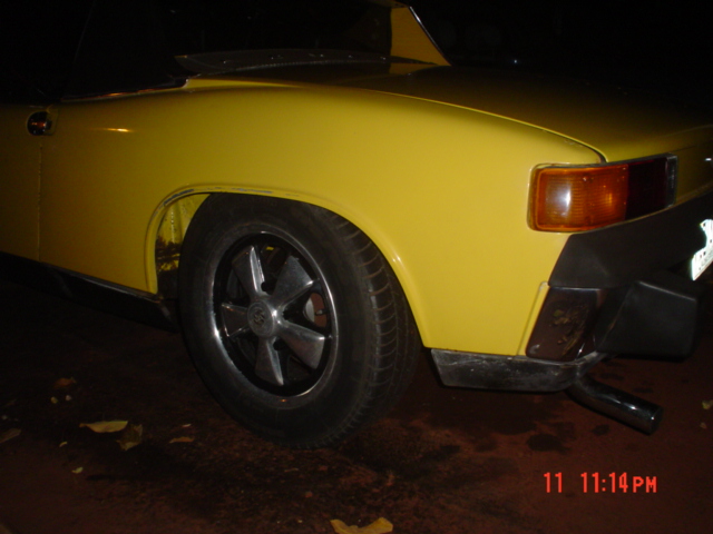

I went the easiest and cheapest route and bought some wheel adapters.
Cost me about $200.00 with the empi repro lug nuts. 14x5.5 Fuch's with 1 inch wheel adapters. Better pic's in the morning.Attached ImageAttached Image

Well....the good part about where YOU live....is that you probably can't go fast enough on the island to hurt yourself.....4-5 lug adapters aren't the most accepted way to do it. Most if not all race scrutineers would fail you at tech inspection.
To me, the construction of most of them reeks of bad chesse....
So, I would periodically check them.
