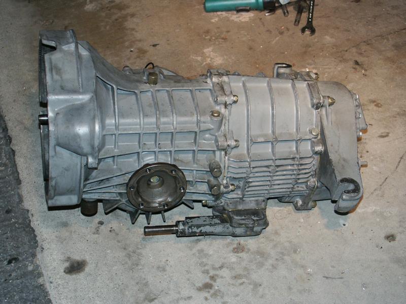

You have a 916 trans?
If so, you DON'T need anything made by Velios.
The Velios kits basically turn the 915 box into a side shift 915 not really a 916.
From the pictures that I have seen on pbase.com, the 916 already has the shifter input shaft relocated as a type of a side shift configuration.
It looks like all you would need is a custom shift rod (from the firewall to the shifter input), and possibly a 915 shifter for inside the car (depending on what the shift pattern is with a 916 gearbox).
With a vellios kit, you need to use a 915 or similar shifter as the shift pattern is that of a 915 (reverse is to the right and back, not to the left and forward).
Post some pics of your 916 transmission.
Does it look like this?
turboman808
post Aug 15 2006, 10:18 PM
Posts: 2,718
Joined: 31-January 06
From: North Jersey
Member No.: 5,505
Yeah looks like the same part coming out the side. I just was under the impression velios made a side part that worked a little better. I still need to fiddle with the shifter I think.
