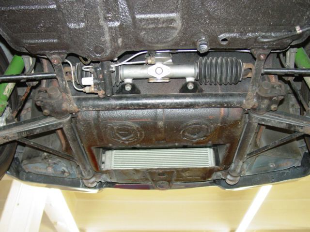

just to add some flame to the fire,, if you look at the last 916 that was auction
http://cgi.ebay.com/ebaymotors/Porsche-911...sspagenameZWDVW
and look at the picture of the underside , you will see the cross menber for the steering rack is steel not aluminium??? is it just me or what

QUOTE(freezing14 @ Sep 6 2006, 10:39 AM) *
and why would it be aluminum ??? *all* 914 came with the steel cross member ...
i'd be more worried that they'll forget to put the protective pan back on and leave the mounting tabs for the rack-support unbolted ...
(IMG:style_emoticons/default/blink.gif) Andy
echocanyons
post Sep 6 2006, 11:47 AM
Posts: 2,107
Joined: 24-December 02
From: Bay Area, CA
Member No.: 7
I think the aluminum crossmember was used on the 911's after '76 maybe even as late as '78.
I could be wrong though

post Sep 6 2006, 12:10 PM
freezing14
Posts: 435
Joined: 21-June 04
From: brockville , Ontario, Canada
Member No.: 2,233
did'nt the -6 had aluminum cross member, like the 911 si is it based on a -4 or -6 ,, i'd be curious to see the spline of the torsion bar(-4 or-6?)
smdubovsky
post Sep 6 2006, 12:28 PM
Posts: 331
Joined: 27-September 04
From: Silver Spring, MD
Member No.: 2,837
Kellys right, the 911 didn't get the aluminum cross member until the later 70s - sort of like how they didn't get the aluminum rear trailing arms either. The 914/6, like all 911s at the time, had steel crossmembers.
The /6 used the 911 torsion bars and A-arms (which makes sense, since thats what porsche had avail to put on the cars) It would also be logical that the 916 would do the same. But, logic and what really happens don't always match;)
SMD
John
post Sep 6 2006, 02:09 PM
member? what's a member?
Posts: 3,393
Joined: 30-January 04
From: Evansville, IN (SIRPCA)
Member No.: 1,615
I know the stock 1973 911's that I have worked on had steel front axles.
I know that one 1974 that is presumably stock has an aluminum front axle. FWIW, In PET it shows both steel and aluminum starting in 1974(on 911's not 914s).
javadog
post Sep 6 2006, 05:42 PM
Posts: 20
Joined: 3-July 06
From: Tulsa, OK
Member No.: 6,358
QUOTE(JOHNMAN @ Sep 6 2006, 03:09 PM) *
The first use of the aluminum crossmember on the street cars was on the '73 RS.
