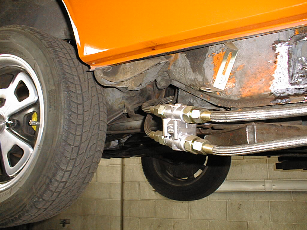

Looking at two oil cooler thermostats and would like the "non club's" experiences, good or bad with Mocal v.s. Troutman.
Don't want to bias your input with what I currently have, or what I've heard, but would like some objective input from you guys who have used them....
Mocal
Troutman
Wondering about quality, reliability, options and/or ease of mounting, failures, etc.
Don't want to make a change without the benefit of everyone's experience!
Thanks in advance for your opinions...
