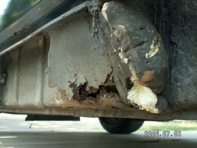

Looking for a referal for someone who can fix this properly.
THX
LukeD
pic 1 and 2 of 3

Nice structural foam! (IMG:style_emoticons/default/ohmy.gif) That's not good... (IMG:style_emoticons/default/huh.gif)

Yes, how nice of someone to remove the A/C and plug up the hole with foam!!
This is what I get for only looking at/around the jack point/hell hole before buying (IMG:style_emoticons/default/headbang.gif)
It's not sagging so can I just cut this piece off another car and take it to a reputable body shop in town? Is it worth the risk?
Better yet, how about I saw zawl the area out and put more foam! LOL

That's the structural support for the doorframe and windsheild that attaches
to the long -
What needs to be determined is if the rust actually goes into the long behind that piece....
Get it cleaned out - the pieces to replace it will need to be fabricated - as far as I know I have never seen any factory or repo parts for that piece -
I had to fab mine as well -
Thom

The question isn't if it goes into the long behind, but how far. You can see it does in Pic#3....

That is right that is just a brace and is not the actual long remocve the foam and see if it has eaten behind it.

GWN7 is correct in that it does go back into the long. I will have to cut off the brace to get a better idea.

looks like the ac installer took the triangular sill supports off as well (same as on my 73'). easier than drilling a few holes and adding grommets i guess. i hate undoing an ac install. luckily my jam support wasn't all rotted away. hopefully, the upper reaches of the inside door jam section are ok. consider sourcing sill supports in your amputated parts search.
