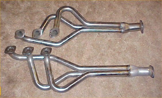

Headers: DONE & RECEIVED
*stock shift rod clearance was cool*

Headers: On eBay from same seller as sheetmetal above. Otherwise headers at about $400 a set ..... stock good effin' luck and if you have luck somewhere between $900 - $1300 a set used

Club member Martin Schneider makes a 914-6 header that many of us use.
http://www.msdsinc.com
