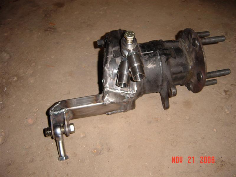

Here's the work I did this morning. That rectangle stock sticking out will be where I attach my toe link. The semi-trailing arm links will mount on the top and bottom of the knuckle (bearing carrier).

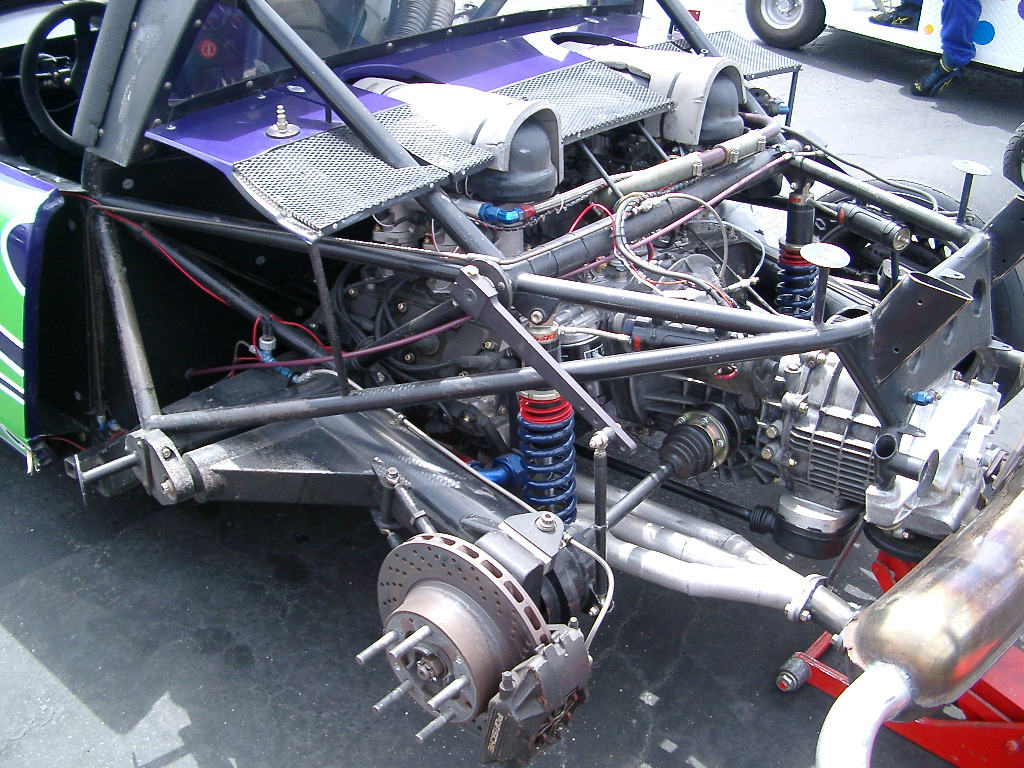

We need to go over and figure out exactly how Kinematic toe works on the Boxsters/993's/996's
Let me show you a little secret:
928's were the first to have Kinematic toe (little to no toe gain in bump)
I'll find a better picture when I get home. This tube chassis has the 928 arms on it.

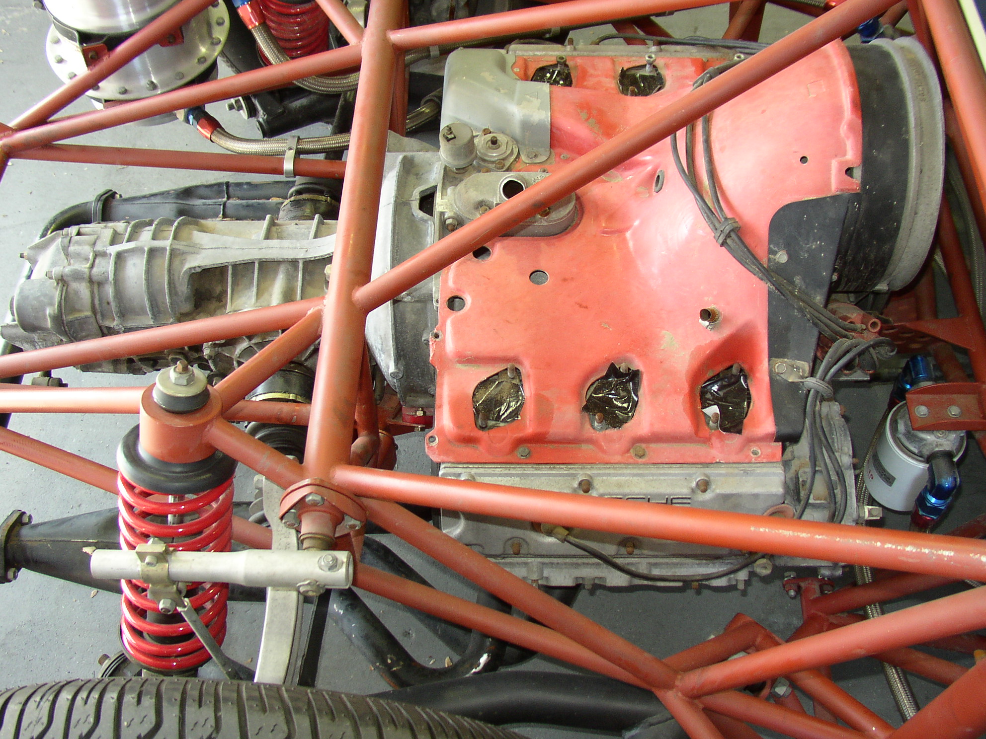

I have been of the belief that you could "fake" the semi trailing arm and do some kind of inboard heim joint control arms that stress the tranny (like an open wheeled car) use the semi arm to make it look like you are using it.
Roger Sheridan does this with an empty strut tube in the front of his car and a Penske shock mounted in-board of the empty strut tube. The rules call for it to be in place but he couldnt get a decent shock for the strut.

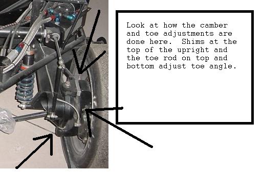

Not sure what your bottom arrow is pointing too, but Roger only runs one toe adjustment rod. The entire wheel carrier pivots on that lower spherical bearing.
His car passes SCCA GT2 rules with flying colors. Jim Blakewells rear arms are VERY similar to Rogers and the ones we worked on back in 1996.

Sheridan runs two toe adjustment rods on his car. Check this next picture notice the upper and lower rods. Sheridans car is grandfathered in as is Blakewell's car. SCCA put a change in the rules that require the shock/strut to run inside the spring. SO all further cars built after, I think 1997 (I don't have my rule book here) ahve to abide to the new rules. Also newer cars built after a certain date can run any type of rear suspension, in GT. But back to Production racing.
When you adjust our rear suspensions you have to deal with moving the roll centers around. It will change the handling every time you adjust it. Now Finch likes to set the rear suspension where it needs to be and re-weld the stock trailing arms into position. Other than dealing with compliance in the rear suspension arms this is not a bad way to go. I would build a new arm all together and set it where you need to be. Problem with this approach is you are pretty much fixed as far as suspension settings go. Having adjustment is good which keeps bringing me back to Sheridan's rear suspension design.
