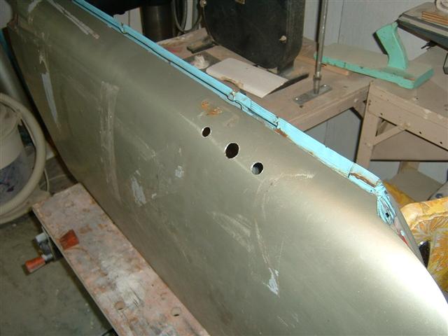

The door drilled out to match the pattern...

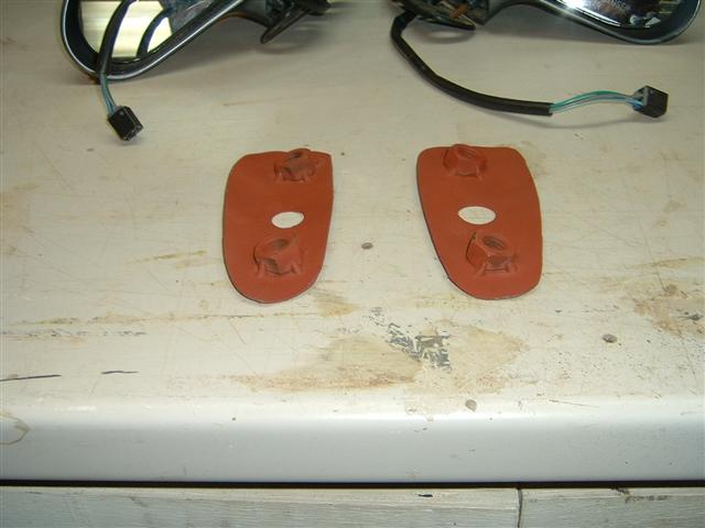

The steel supports...
These were welded inside the doors between the mounting holes. When the mirrors were installed they pulled nice and tight and the mirrors are firm. Without them the mirrors might wobble a bit on the thin sheet metal.

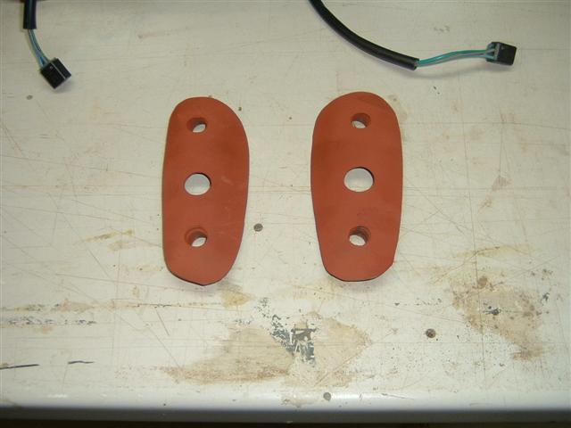

Other side...
Nuts were ground on an angle before welding to pull the mirror square to the door.

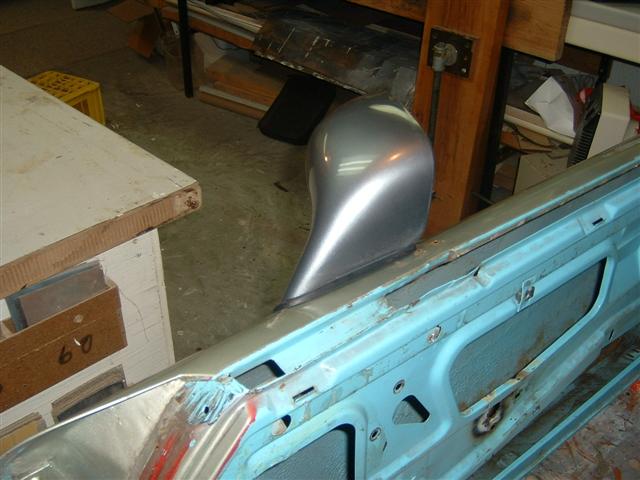

Mirror on door..

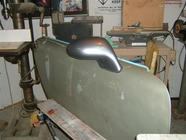

more

and last for now
I'll post again in a year or two to show the final product.

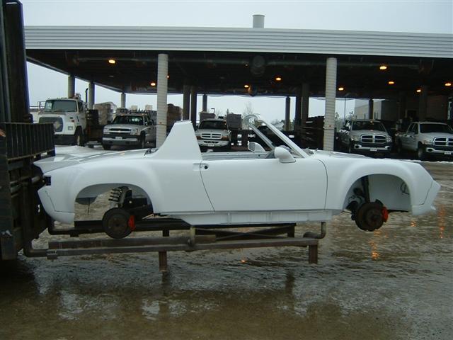

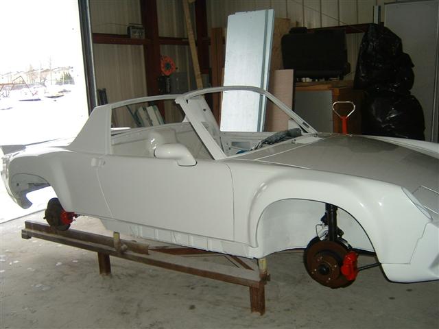

And here they are on the freshly painted P2 project car.
tracks914
post Jan 10 2008, 07:43 PM
Canadian Member
Posts: 2,083
Joined: 15-January 03
From: Timmins, Ontario, Canada
Member No.: 153
Nuther one

Allan
post Jan 10 2008, 08:02 PM
Teenerless Weenie
Posts: 8,373
Joined: 5-July 04
From: Western Mesopotamia
Member No.: 2,304
Nice work!!!!
Let us know about visibility/adjustability, etc....
roadster fan
post Jan 10 2008, 08:16 PM
Project Frankenstein !!!!!!!!
Posts: 1,009
Joined: 24-November 05
From: Aptos, CA
Member No.: 5,184
QUOTE(tracks914 @ Jan 10 2008, 05:43 PM) *
Nuther one
Let me take a wild guess why the car is white...........oh wait all the vehicles in this pic are white (IMG:style_emoticons/default/biggrin.gif)
Did you have the wing/quarter window in place when you chose the mounting spot? I had to adjust my Miata mirror for that on the passenger side so the window channel didnt partially block my view of it.
Looks nice, good choice IMHO.
