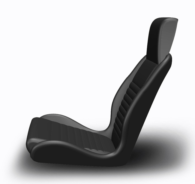

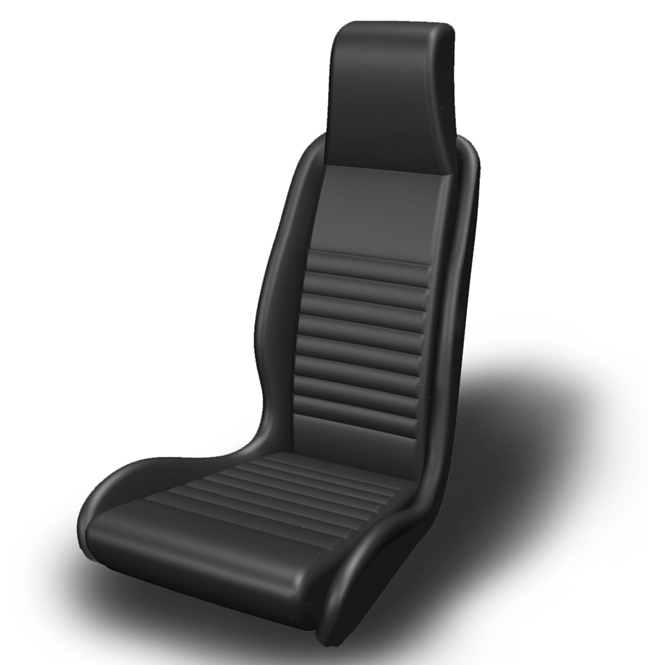

Here is my solution to the 914 seat problem.
I have the seats in data, and I will make a set this spring and see how they go.
I was planning on using the stock insert and either modifying the base or making a mold for new one.
I just modified the blosters, keeping hard points for the carryover insert and stock 3-point seat belt reach zones.
Mark

QUOTE(marks914 @ Dec 10 2006, 12:39 PM) *
Mark
that looks good.... (IMG:style_emoticons/default/aktion035.gif)
