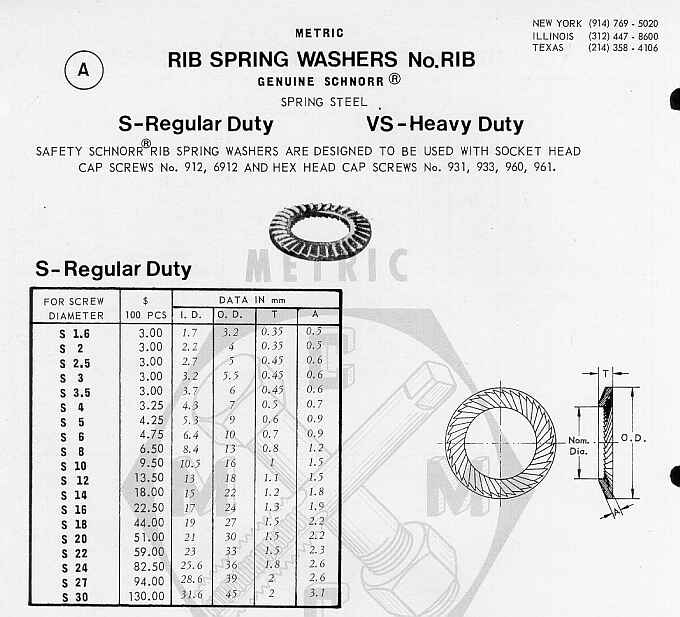

Neither - it is a Schnorr washer and it is serated on both sides and dished.

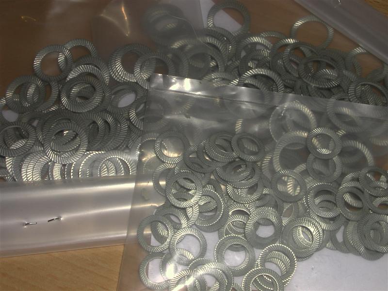

Lookie lookie... 3 bags of schnorr washers came today!
