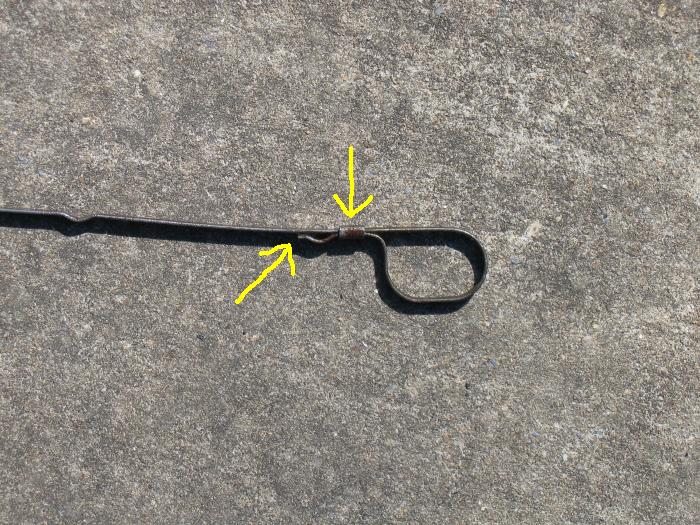

I've never been, am trying very hard to go this year & that's good to know, thanks. I use K&N oil filters on the 4 & was shocked, yet not surprised, that there are none for the six. In reading everyone's replies to my simple oil change I think I discovered why I overfilled my engine... the dip stick. The stick on the 6 rests inside the mouth of the oil tank. It's made from one piece of metal that was looped over on one end to make a finger hold. Where the rod ends, after the loop & back onto it'self, it gets hung up on the rim of the retaining tube where it lives. I squeezed it together & shoved it all the way into the tube & voila... I'm 1/2qt over. Oh well, it's not like she's not messy already w/ leaks from the strainer & stock cooler. Another thing I realized is how much room I have to work on the engine down there. While lying under the car & looking up I realized why there is so much room... headers. So there I was last January, driving the car & freezing my a** off dreaming about Patrick Motorsports complete SS exhaust system for the six. When I say dreaming I mean $2500.00 + shipping. Yesterday I realized that if I put the heat back in I loose all that wonderful, lightweight working room. Crap! (IMG:style_emoticons/default/headbang.gif)

Well I went in & fired her up... I hate cliche's; "once you go six you can't go back" (IMG:style_emoticons/default/biggrin.gif) . I took a photo of the culprits that can lead to false readings; see below. That 1st one gets hung up onto the tube every time. Anyway, like a true Dumb A** I checked while stone cold & sure enough it looked to be about 1/2 a qt. high. So I rolled her out into the sunlight & let her warm up. While warming up I took advantage of the weather, the warm dry & level parking lot & adjusted the new rear sway bar while she was on all 4's. Not so "Dumass" (IMG:style_emoticons/default/biggrin.gif) .
I ran her today & let's just say I think I know how Vader felt the 1st time in his little black Tie fighter (IMG:style_emoticons/default/happy11.gif) . The power & handling were phenomenal. Back end was noticeably tight... I like it. Got home & let her idle on level ground & the reading was perfect... right on the line (IMG:style_emoticons/default/confused24.gif) ?

That's not the line, that's the handle. The bump you see to the left of the image is overfull, so you're REALLY overfill. There should be 2 lines stamped into the dipstick, and the fully warmed up oil level should be somewhere below the upper line, maybe half way. The Cap'n

I'm aware that those are not the line. Those aspects of the handle or loop I highlighted get hung up in the mouth of the measuring tube, inside the filler neck. I have to make sure those go all the way into the tube to get an accurate reading.

I have always used the lower "hook" over the tube as a stop. Gives me a consistent reading since I always have the stick at the same point each time. Checked with the engine hot and at idle.
