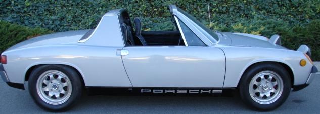

Im almost ready for the ramble !!!!! Im switching over 72 to 75 suspension and brakes(THanks ERIC!!!) and factory sways where there was never any before. Next is drop motor put in new clutch, adjust valves and tune carbs. And im done.

That's a sweet lookin' car. I can't wait to see it in person.

Definitely a great looking 914. Who's carpet?

You should not be having a problem with this. I can see by the picture that Sir Andy is helping you with this project and he knows how to do this.... (IMG:style_emoticons/default/biggrin.gif)
Oh wait! Maybe you are just using Andy's camera? (IMG:style_emoticons/default/cool.gif)

My friend does interiors for cars and ordered it from somewhere. Not sure where. It looks nice but if you look at it close in person the seams don't really look strong. I dont know. It works. Im just going to put mats in anyways to protect them.
Robby::: No Andy..... Im doing this all on my own with a little help from people giving me advise tips here and there. The camera is mine.
