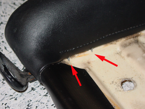

The only problem that I had was that the seat headrest fabric fit too loosely. Autos International would have fixed it, but I took care of it myself by re-stitching some of the seams. I am sure that they would have done it better than I did, but I did not want to send them the headrests and wait to get them back. If you choose Autos International, I recommend that you send them your headrests for proper fitting.

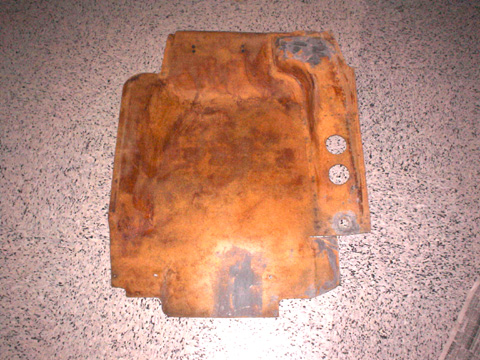

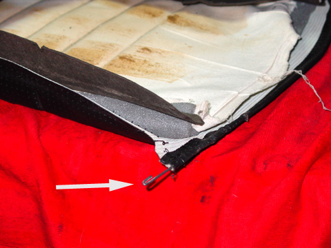

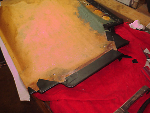

Backpad re-upholstering:
First remove the seats.

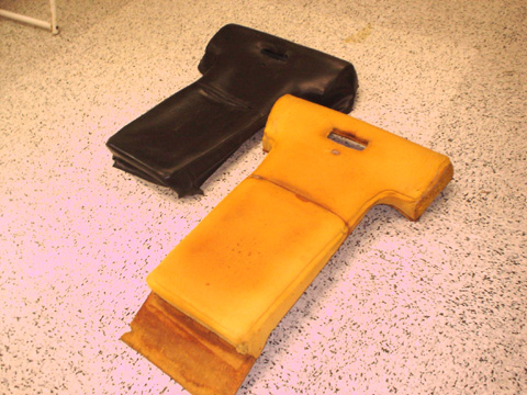

Remove the backpad by removing the four screws at the bottom. Slide the bottom of the packpad down and toward the front of the car. Disassemble the backpad into three pieces by unscrewing the screws at the joints.

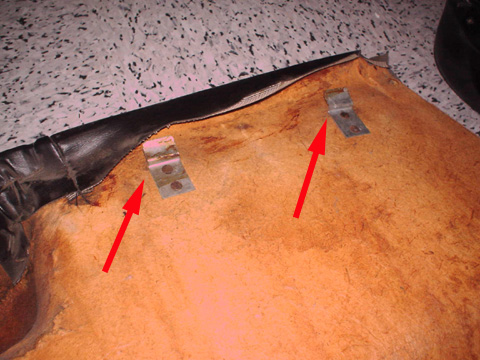

The first picture shows the backpad removed and disassembled - backside view. The second picture shows the brackets at the tops of a side-piece of the backpad that hold the backpad in place against the rear firewall. Note that the hooks face up, so that is why it gets removed by pulling it down.

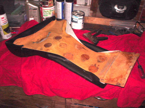

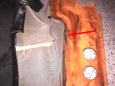

Remove all of the staples form the back and then peel off the old vinyl upholstery until you expose the foam padding. Carefully peel the foam off the backing board to expose the stapled bead. Remove the staples (prying with a small screwdriver) from the bead that holds the upholstery in place along the edge of the foam, attempting to save the bead. If you damage it, you will need to come up with a replacement. It is likely fragile and will break. Even so, you can still re-use it as long as it is not completely trashed.

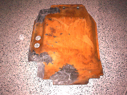

Repair any damage to the backing board. I used fiberglass resin and mesh. Any repairs on the front need to be made smooth because any imperfection will telegraph through the new vinyl upholstery covering you will be gluing down later. Repairs on the back can be rough - up to you.

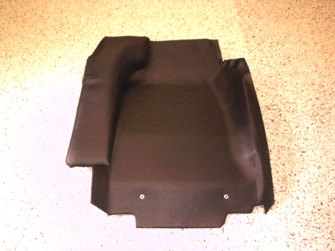

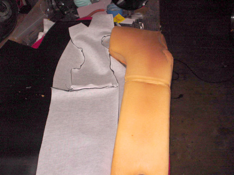

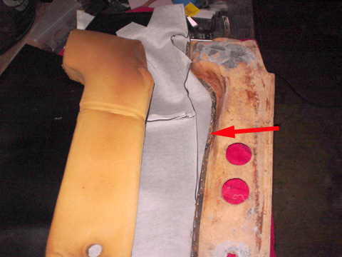

Now you are ready to install the new upholstery.

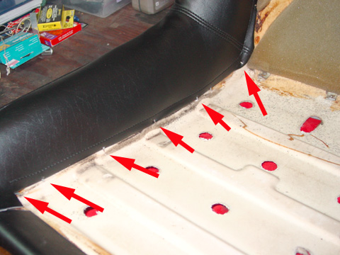

Start by laying the seam into the heel of the contour and then overlay the bead you salvaged over the seam. Start stapling form the top and stretch the seam away from the top as you staple from top to bottom - very important.
The first picture shows the foam pad just laying there on the left. Its final position is to the right of the bead. The second picture shows the foam pad glued in place. The installed foam pad must cover the bead, otherwise the fabric will not be in contact with the foam and will have air pockets.

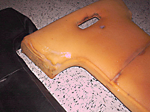

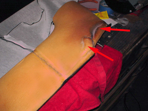

Fill any tears and gouges in the padding with clear silicone seal and let it set. I found that silicone seal had a similar density to the foam after it dried and later, after the upholstery was finished, I could not tell where it was applied.

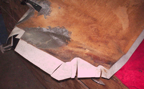

Start by stretching the fabric over the foam padding and stapling the back. This can be hard work on your fingers - really pull on the material. Then spray the entire backboard and back of the fabric with the spray-on contact adhesive. Let it dry - very important. Go do something else while it dries. If you do not let it dry, the two parts will not stick to each other and you will have serious problems. Don't rush the drying process - very, very important.
When the spray-on adhesive is dry, stretch the fabric over the front of the backboard, careully filling in the nooks and crannys with fabric using your fingers to push it in place - it will stick. The adhesive is fairly forgiving, so you can still pull it up and redo somthing if you make a mistake.
After you are done with the front, turn the backboard over and trim the ends (look at the original installation to see the techniques used for both inside and outside corners. Apply spray adhesive to both the backboard and the material, let dry, and then stretch around.

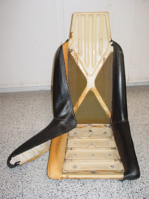

The seats are next.
Disassemble only one at a time - you will need the un-touched seat to remember the various details. Take pictures as well.
Start by removing the bottom seat cushion. Pull up on the back of it, and then pull it out. Note the small hook/bracket on the front that holds it to the seat frame.

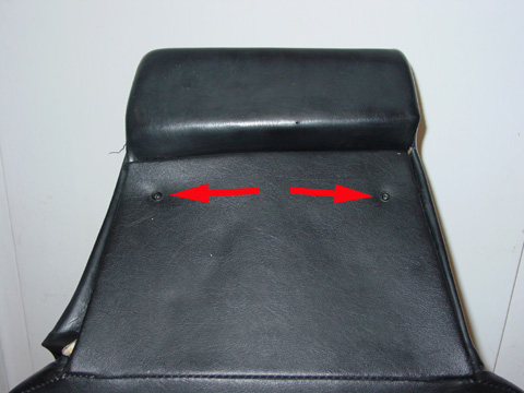

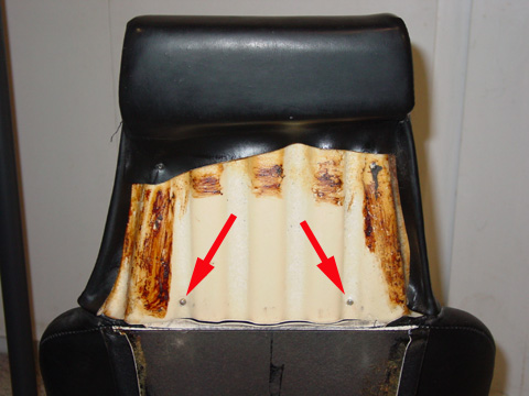

Remove two screws on the back of the headrest that hold the cover flap in place. Then remove the two srews behind the flap. The inner screws hold the headrest to the seat.

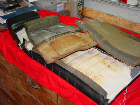

Remove the backpad. Note the three hooks at the base of the backpad at the back of the seat. Starighten them out with needlenose pliers and unhook the bottom of the backpad - see second picture. Swing the bottom of the backpad up and the top will come right off. It comes off very easy - if you need to force something, you have not completely freed the backpad from the seat.
nick mironov
post May 14 2007, 11:09 PM
nickm
Posts: 204
Joined: 12-June 05
From: San Francisco, CA
Member No.: 4,264
This picture shows the backside of the backpad. Note the locations and arrangment of the pieces.

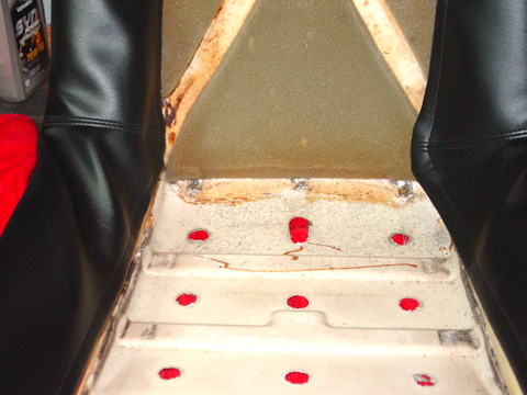

Now remove the seat rails using a hex key on the attachment bolts.

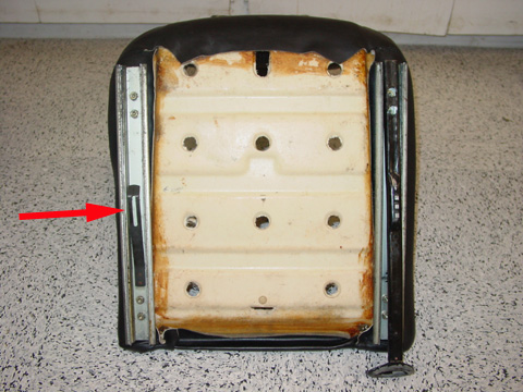

For eveyone who ever wanted to know how to remove the seats from the car, note the bracket that you need to push in addition to operating the regular slider bracket. You need to release both brackets on both tracks at the same time to release the seat. It then simply slides forward and off the tracks.

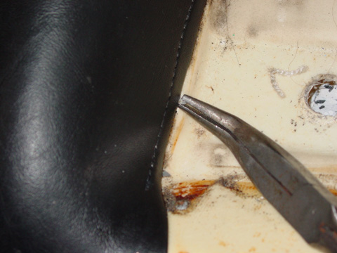

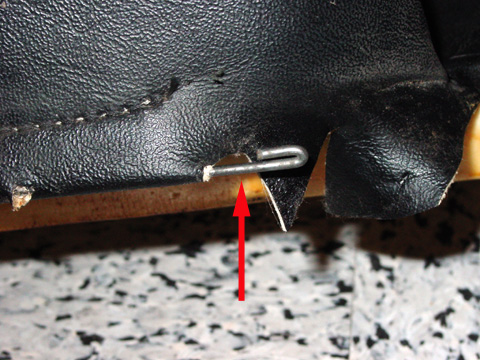

Remove the seat cover fabric. Note that it is held in place along the inside of the seat using bent hooks - same as the bottom of the backpad. Straighten them out with needlenose pliers. Then pull the bead off the hooks.

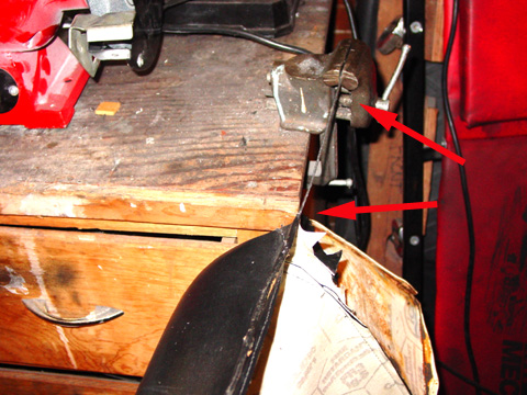

Pull the wire beads out from the side pockets. I put one end in the vise to hold it and then pulled the fabric off of it.

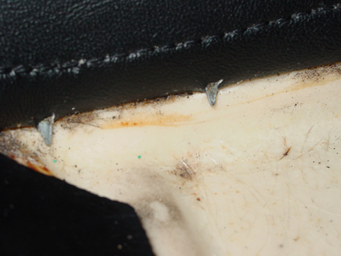

Make sure that each of the hooks has a sharp point and is pointing outward.
Insert the wire beads into the pockets on both sides.
Wrap the new kit fabric around the back of the seat - like putting a coat on it.
Start in the heel of the seat - by piercing the pointed hooks through the fabric above the wire bead.
Stretch the fabric and work you way toward the front and up. Bend the hooks over as you go to secure the bead down.
