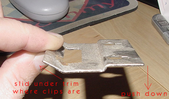

I made a tool I use that slips under the chrome and pops it up from the clip side. It's essentially a thin lever just made out of an old bracket put in a vice and hammered over slightly. Takes it off w/o any trouble. They key is to place it under the trim right where the clips are or you will distort the chrome. You can slide it along and feel where the trim is tighter, and that is where the clips are.
Regardless, if you are reinstalling the chrome, you will need new clips if you want it secure.

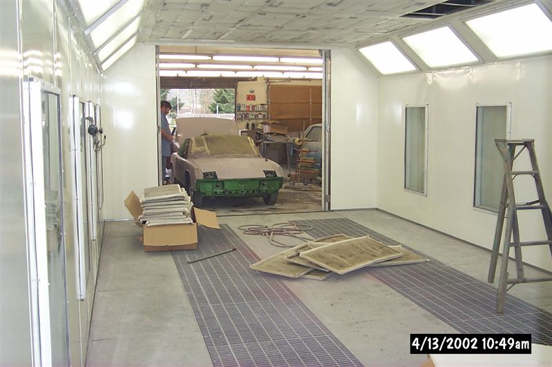

Yea I would get other bids also. Lenny was comparable to another shop that I went to price wise. His paint booth was WAY nicer then the others. Have you seen it yet? The hard part is finding "willing" people who want to do a full repaint.
If you want to stop by and see my car lets set up a time. I'll also show you some of things I'm not happy with.
Here's a photo of the booth...downdraft ventilation and heated. They were putting in new filters when I took this photo.

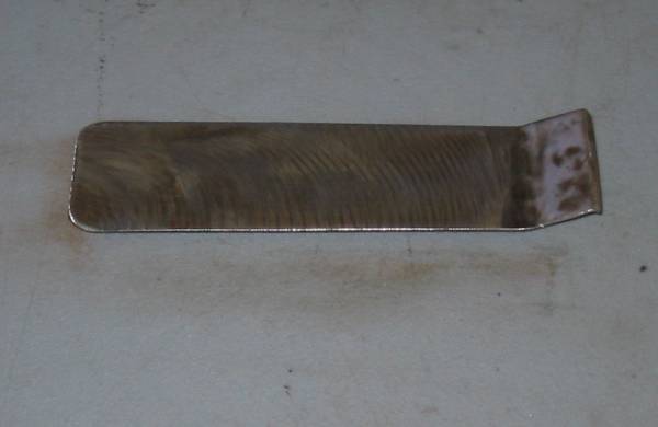

Here's a pic of the tool I made from a piece of Chrome-moly sheet. It is possible to "unlatch" the plastic clips with this tool so they don't break when lifting the trim. This is important if you aren't replacing the windshield, just the trim.
By sliding the tool sideways after inserting it under the trim, I can catch the clip and pull it away from the lip of the trim, thereby releasing it easily without risk of breaking the delicate old plastic.

Yeah, it takes a light touch to make it look smooth. You can't just press it into place and expect it to flatten out against the windshield by itself.
