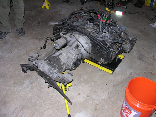

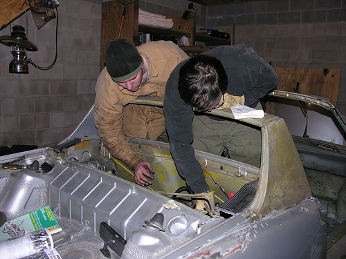

Posted 12-08-2005
Luke asked for them, and that was enough to get me to post them up.
These are from my 914 Flickr page here:http://www.flickr.com/photos/17886282@N00/sets/1537526/
All of these pics were taken the saturday after Thanksgiving. I suckered my buddy Ross to brave the cold and help get the engine out of the 914.
Me unblolting somehting - either heat exchanger or engine crossbar.
(IMG:http://www.914world.com/bbs2/uploads_offsite/static.flickr.com-1435-1274376265.1.jpg)
What do you mean it caught on somehting?
(IMG:http://www.914world.com/bbs2/uploads_offsite/static.flickr.com-1435-1274376267.3.jpg)
Ross throws the horns before the engine is out. Could have jinxed the whole thing!
(IMG:http://www.914world.com/bbs2/uploads_offsite/static.flickr.com-1435-1274376268.4.jpg)
And ITS OUT!
(IMG:http://www.914world.com/bbs2/uploads_offsite/static.flickr.com-1435-1274376268.5.jpg)
This is the proper time to throw the horns.
(IMG:http://www.914world.com/bbs2/uploads_offsite/static.flickr.com-1435-1274376269.6.jpg)

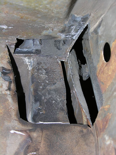

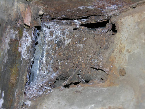

VaccaRabite
post May 21 2007, 09:34 AM
En Garde!
Posts: 13,878
Joined: 15-December 03
From: Dallastown, PA
Member No.: 1,435
Update for 12-16-05

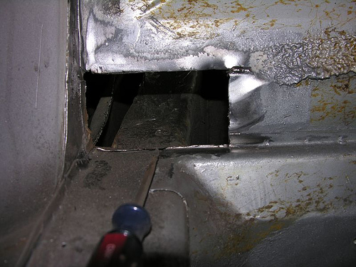

Well, today I tackled one of the cars "problem areas." And if you know 914s, i'll give you one guess as to what is was.
When I bought the car, I could not see any rust in the hell hole area. As I dug into it over the past couple of months, I found some, and then some more. So, today I took care of it.
The day started with the hell hole looking like this (keep in mind, this is _LIGHT_ rust for a 914 hell hole):
(IMG:http://www.914world.com/bbs2/uploads_offsite/static.flickr.com-179-1274377052.1.jpg)
4 hours later, it looked like this:
(IMG:http://www.914world.com/bbs2/uploads_offsite/static.flickr.com-179-1274377053.2.jpg)
And from the cabin side:
(IMG:http://www.914world.com/bbs2/uploads_offsite/static.flickr.com-179-1274377054.3.jpg)
I tried to grind it out with my angle grinder and a 4 1/2 inch cutting disk. But my grinder is too bulky to get int here. So, I swapped over to a dremel, and burned through about 15 heavy duty cutting disks. The I used my grinder to wire brush it, then hit it withthe dremel again.
Last part of this repair will be to cut some patches out of sheet steel, and weld them in. But, alas, I have yet to buy a welder. I looked at them today, but I refuse to buy one till after all my Christmas holiday shopping is over.
Anyhow, patches will be welded in, and the hole mess will be POR-15ed. Hopefully that will be that for rust in the hell hole. At least for the next 30 years.
Zach

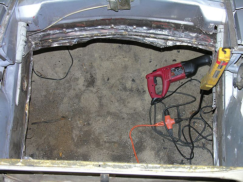

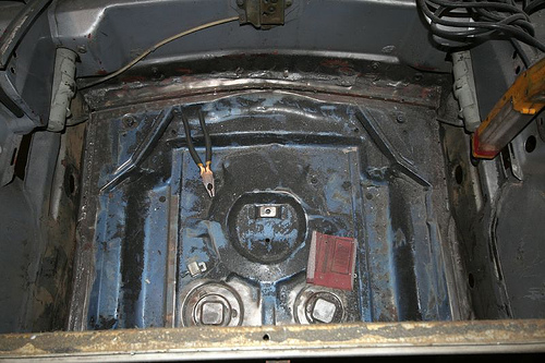

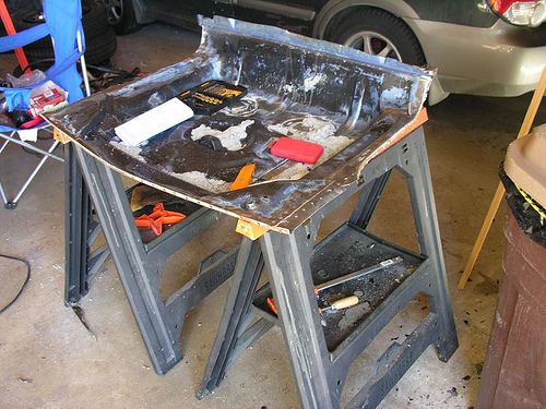

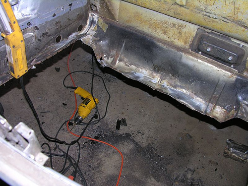

Posted 03-06-2006
I did more work on the 914 this weekend, and remembered to take some pictures. Hopefully, as spring startes to warm up my garage, I'll be able to spend more time out there on the car.
The mission: get the crappy, rusty front trunk out and replaced with a new clean one.
The task this weekend started when a body panel that I got from a salvage car showed up in the mail. The weather was nice, so off to work I went.
(IMG:http://www.914world.com/bbs2/uploads_offsite/static.flickr.com-179-1274377083.1.jpg)
This was what needed to come out. The big hole in the bottom was a cut out for the dealer installed AC (which will notr be going back in). Notice how crumpled this metal is. There are rust holes at the top left and bottom right corners. The top left suspension triangle is really rusty. What is left there is a patch work of steel welded and brazed in. This car has had several front enders... The more I dig into this car, the more I think it was raced pretty hard. There is lots of front end work on it.
(IMG:http://www.914world.com/bbs2/uploads_offsite/static.flickr.com-179-1274377084.2.jpg)
Almost all the metal is cut out. The front still needs to be cut away. At the factory this area was attached by spot welding. But the DPO brazed it on. The spot weld are drilled, but i need to grind off the brazing as well.
(IMG:http://www.914world.com/bbs2/uploads_offsite/static.flickr.com-179-1274377084.3.jpg)
Here it is looking at it from the front. You can still see a rust hole near the top left. The drilled holes along the left are spot welds that I drilled out. Before I cut that last bit out, I need to take very precise measurements so that I can replicate the cut on the new panel. The goal is not to have to have a gap when I weld in the new piece.
(IMG:http://www.914world.com/bbs2/uploads_offsite/static.flickr.com-179-1274377085.4.jpg)
This is the part to be welded up after a lot of cleaning. The guy who was cutting up his car left much of the fenders, nose and fuel wall on. the fenders and nose I took off (drilling out the spot welds) and when I get my measurments for the back rise, I'll make the same cut here. If doen right, it will make a very tight fit and be easy to weld in. All the white junk in it is ground out seam sealer. I wanted to take it all out to make sure that there was no rust hiding under there. Before the piece gets welded into the car, it will be bare metal, and right after welding it will get the POR-15 treatment.
Around 1AM Erin came out and asked if I was planning to come to bed. Time had gotten away from me. I work pretty slow, but I am teaching myself all this stuff as I go along. Sunday I had other tasks to do, but today is supposed to be nice out. Maybe I'll have the new front trunk welded in by this weekend. If so, it will be one of the big steps in my restoration.
Along the way this weekend, I realized that I had gotten a 2 for 1 deal on my sawzall. I bought one, on sale. Put it away without opening it. Saturday night, I take off the cellophane and 2 bozes of saws come out! They were packaged in bundles of 2, and never unpacked at the store. The checkout person just rang the barcode, and neither of us ever new any better!
Also, while wire wheeling the seam sealer out of the new piece, I felt something hit me in the forehead. Not too uncommon (and I was wearing goggles, a hat, and ear muffs). My neighbor stopped by to chat, and while brushing the dirt off my face, I felt something that was not right. Reached up and pulled out a 1/2 inch piece of wire that had embedded itself in my forehead.
Zach

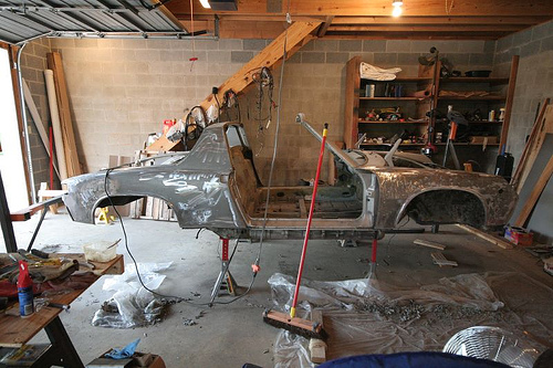

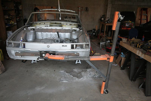

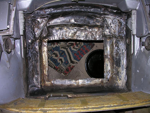

So, I have alsmot had the car for a year now. It pretty different from the way it looked when I bought it.
(IMG:http://www.914world.com/bbs2/uploads_offsite/static.flickr.com-1435-1274376344.1.jpg)
That was today. I have begun stripping the old paint and bondo off the car. It had several coats of paint on it, and the most recent job was pretty crappy. I've stripped about 1/4 of the car at theis point and the good news is there was ZERO rust under the paint. The bad news is that there was a ton of bondo on the front. This was expected, and I am going to try and work the lumps back into shape with a hammer and a shrinking disk.
The front trunk is welded back into place.
(IMG:http://www.914world.com/bbs2/uploads_offsite/static.flickr.com-1435-1274376345.2.jpg)
The back rise (not pictured) has a slight gap to it. I'll need to patch it, and I will get to that soonish.
The hell hole is totally fixed, por-15ed and seam sealed. It should never be a rust magnate again. The single biggest weak point for these cars has been tended to.
(IMG:http://www.914world.com/bbs2/uploads_offsite/static.flickr.com-1435-1274376346.3.jpg)
This pic is part of the rotisserie that I built. It should be on it by the end of the month. I just need to bribe enough freinds to come over and muscle the thing up. The tub alone can be lifted by 4 people at this point, so it should be pretty easy.
By the end of the month I will have had this thing for a year. I've not bought a lot for it this summer, as all my money has been being saved for my wedding and honeymoon. I have a bunch of winter projects to keep me busy, and I want to have all the body work done for a spring painting.
I'll probably bump this for the day crew tomorrow, but I thought I'd update tonight.
Zach
