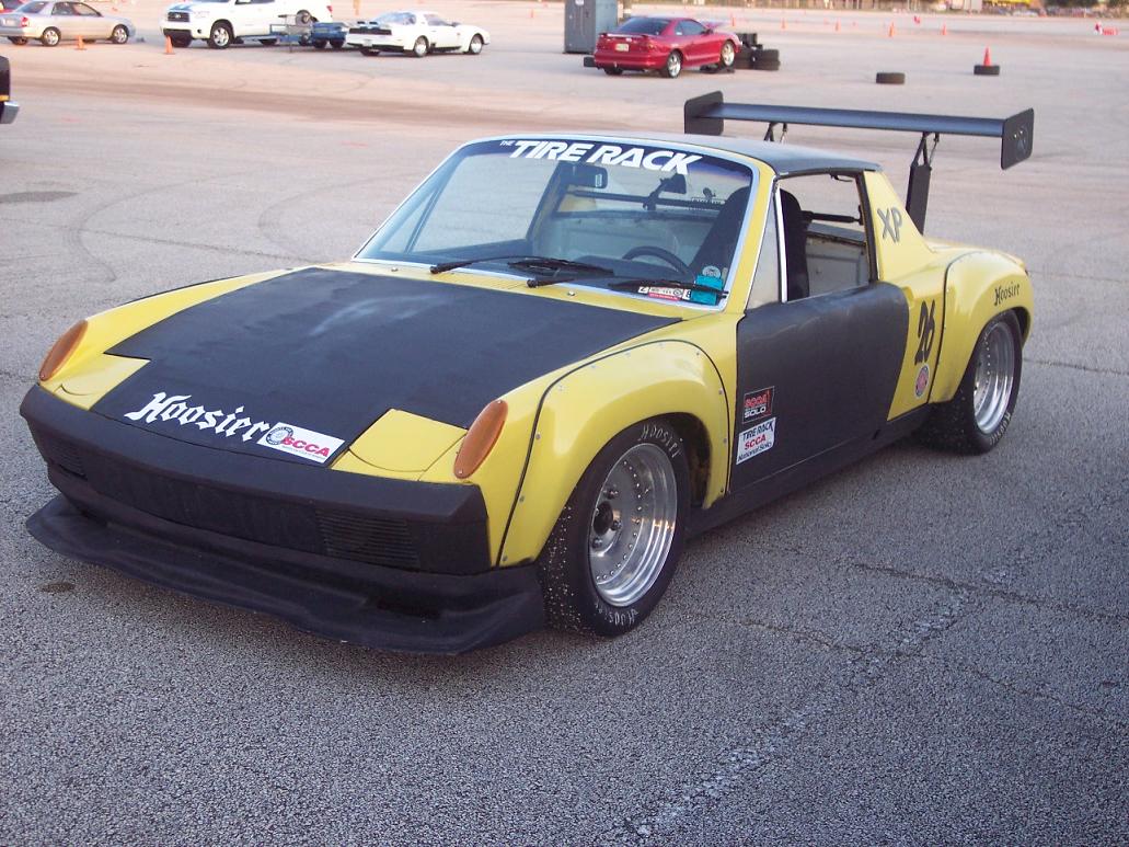

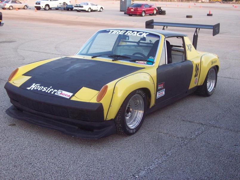

QUOTE(Joe Ricard @ May 23 2007, 08:09 PM) *
I see your 914 and I raise you like 30 TTODs out of the last 33 events ( approximate )
(IMG:http://www.thextremeresources.com/boshi/images/cars/Library_4125crop.jpg)
Those wins were with the old built 2.0L, now we have around double the horses trying to eat our tires.
