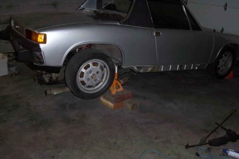

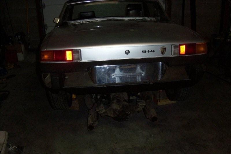

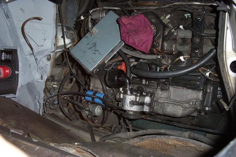

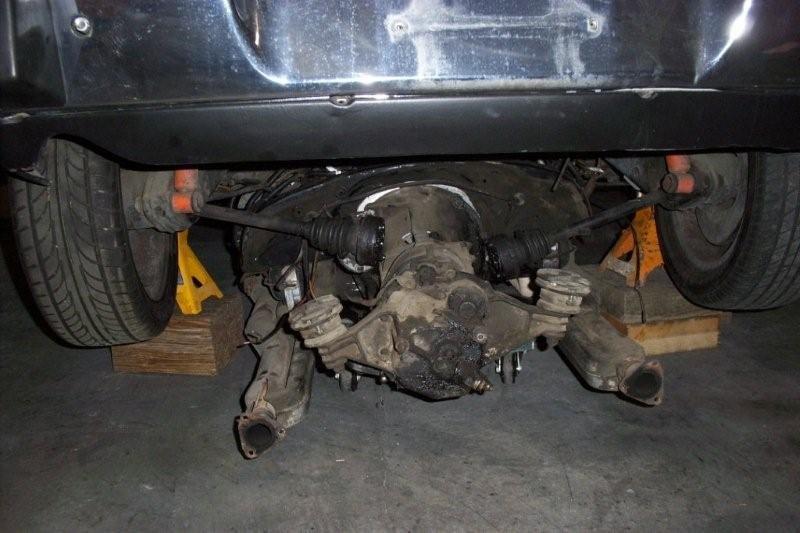

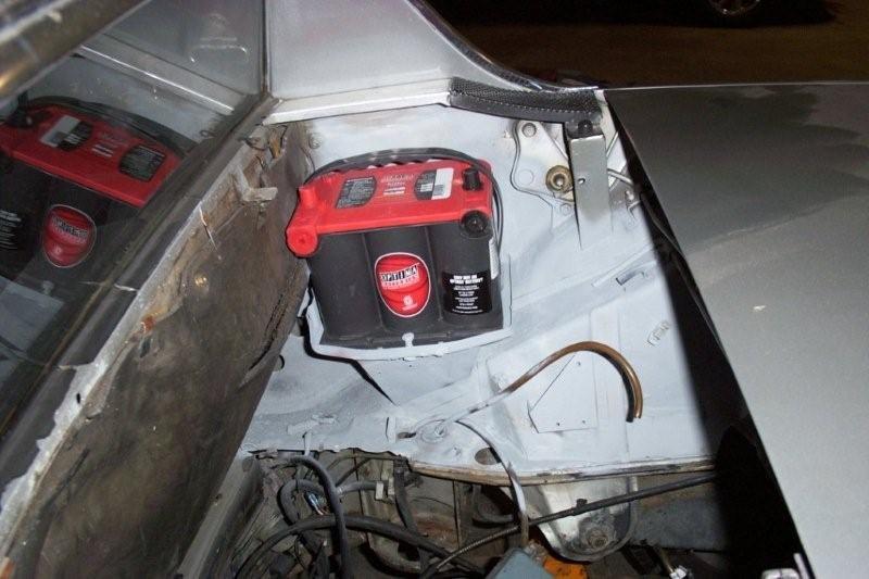

post Jun 30 2007, 12:17 AM
Posts: 6,317
Joined: 10-January 03
From: Albany Oregon
Member No.: 129
A couple pics! These were last weekend. I've got it up in place now. Just got to connect everything, Add some oil, Gas & fire this puppy up! Well hope it fires anyway (IMG:style_emoticons/default/thumb3d.gif)
