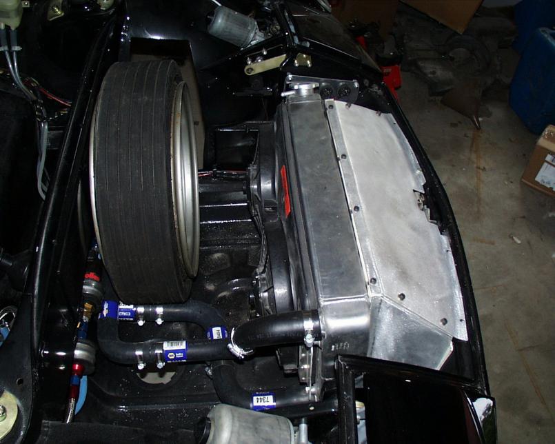

Mine is a custom made dual pass unit, cost me 275 bucks, no problems with heat for 2 years now.
Mark
(IMG:http://inlinethumb61.webshots.com/4988/2033403670057582025S500x500Q85.jpg)

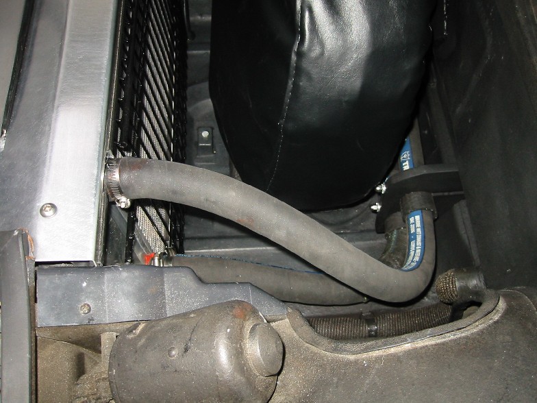

post Jul 17 2007, 07:13 PM
Posts: 2,439
Joined: 4-June 06
Member No.: 6,146
I enjoy looking at all of the monster holes you guys had to cut in your wheel wells to let all that hot air out. Please post more pics like that. Looks like a lot of hose clamps to try to keep tight too.

QUOTE(sww914 @ Jul 17 2007, 05:13 PM) *
skline
post Jul 17 2007, 09:06 PM
Born to Drive
Posts: 7,910
Joined: 26-December 02
From: Costa Mesa, CA
Member No.: 17
I have to agree on the part about the hose clamps, there should only be the ones holding it to the radiator and the one at the rear where it connects to the components. Too many clamps make more chances for failure. Ask Joe Buckle how many we took out of his when he bought it, that car was so screwed up and mickey moused it was pathetic. He has or will be pretty much rebuilding that whole car. This time, he is doing it right however.

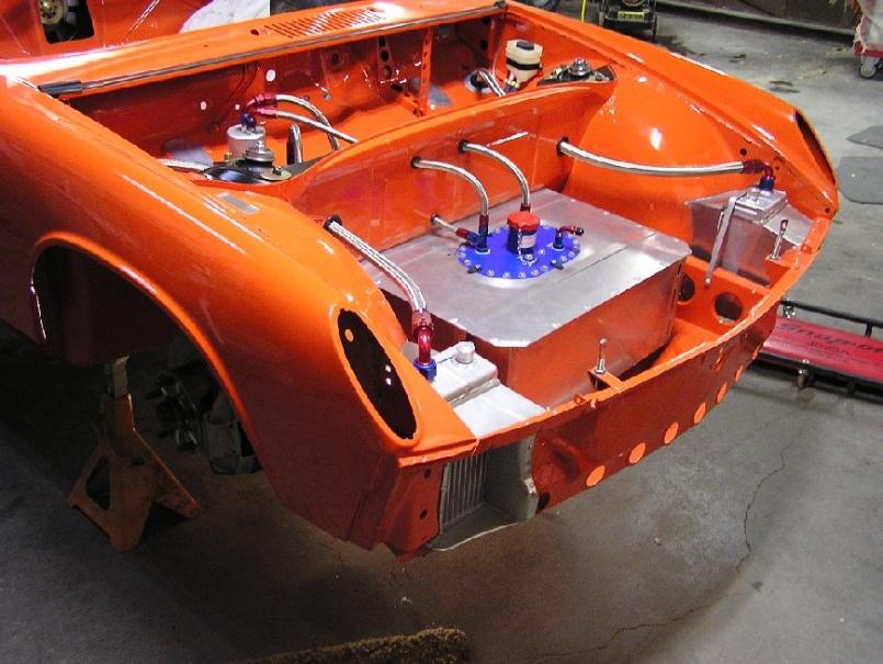

these two?

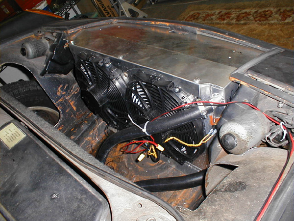

Griffin single pass from Summit Racing. $250.
Fans with electronic thermostat from craigslist. Almost new. $40
Custom made aluminum shroud. Chopped up cookie sheet from a local garage sale. $1.00
Remote electric pump from Summit. Forgot how much....
Ran it on the hottest day this summer in stop and go traffic and it never saw 200.
Good luck!

QUOTE(skline @ Jul 17 2007, 07:06 PM) *
But the choices we have for these cars is growing everyday, I still like the SBC option and I am sticking with it. (IMG:style_emoticons/default/smile.gif)
Yup, as pictured way too many clamps. What I am doing is to mock up a hose from pieces to use as a template to get aluminum tubing bent to match. I am running hard lines under the car that fit into the recesses of the center tunnel.

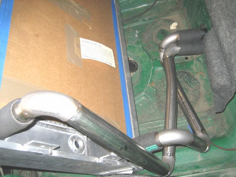

QUOTE(Phoenix-MN @ Jul 18 2007, 06:57 AM) *
Just a word of caution; Be sure to allow for both expansion of the tubing and vibration/movement allowances. The tubing, especially aluminum, will grow considerably in length and may cause unwanted bind leading to failure. While it is true that the more joints the more potential for failure, the rubber hose will dampen a lot of vibration.
I also did under car hard lines.
Here's a shot of the radiator hard lines done in stailnless tubing (tacked together). Didn't want to, but had to cross them over for best routing.
Andys

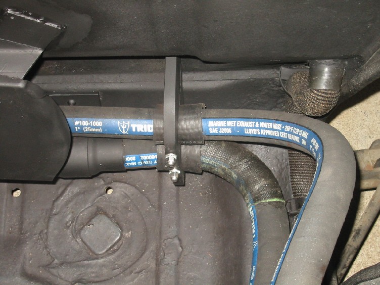

Member No.: 1,192
Griffin aluminum 2 pass, about $275, fits great and works so good I can run pusher fans. even on the hottest days, one fan is all it takes, I have the second one on manual. The guys are right about minimum joints, it's the only way to go. I ran my hoses thru copper 90 degree ells to get them to turn neatly into the front compartment and used the good (and very expensive) marine hose with the wire in it. i really wanted to have an auxiliary electric pump to run for a minute or two after the car was shut down but gave up the idea because of the extra joints it would take.

QUOTE(tyler @ Jul 20 2007, 12:40 PM) *
Tyler,
Just how expensive is that marine hose ? Apart from the copper ells in the front compartment, do you run the marine hose all the way to the engine ?
And for anybody running tubing in those channels on the underside of the car : what kind of clamps do you use ?
Thx
skline
post Jul 20 2007, 01:33 PM
Born to Drive
Posts: 7,910
Member No.: 17
That is the only hose I would run on my car. It's really not that expensive either. To buy the hoses from Renegade or Rod Simpson, you would spend $100 just for the hoses, I get it across the street from my house from Mesa Hose and it cost me $80 for both hoses. We used it on Joe Buckles car too when we replaced all the hoses on his car. It is some really tough hose. The only hose better would be the Silicone hose they sell, that however, is expensive, it was like $13 something a foot.
Yes, you run it from the radiator to the engine, no connections in between.
