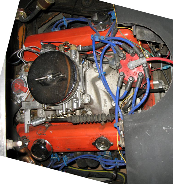

denatured alcohol is what I heard - i am gonna run my gas tank near empty and put a little in and then get it tested again at dmv.
pic of my engine today
http://www.pbase.com/jimkelly/image/82652516
jim

messix
post Jul 22 2007, 08:16 PM
AKA "CLUTCH KILLER"!
Posts: 6,995
Joined: 14-April 05
From: between shit kickers and pinky lifters/ puget sound wa.north of Seattle south of Canada
Member No.: 3,931
that air cleaner is to restrictive. not enough media area on the filter.
jimkelly
post Jul 22 2007, 08:31 PM
Delaware USA
Posts: 4,969
Joined: 5-August 04
From: Delaware, USA
Member No.: 2,460
too restrictive - i was wondering about that - i'll see if i can find another - jim
