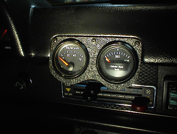

Demick
post Dec 16 2003, 05:28 PM
Ernie made me do it!
Posts: 2,312
Joined: 6-February 03
From: Pleasanton, CA
Member No.: 257
This makes beter use of where the ashtray used to be. I have an identical one that hangs below it under the dash for the remaining 2 gauges (total of 4). Simply made out of a textured flat piece of black ABS plastic and mounted with a right angle piece of aluminum behind it.

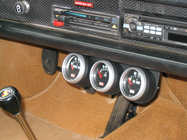

I removed the console and added the gauges for my SBC conversion. The car does seem like it has alot more room without the console.

Demick
post Dec 16 2003, 05:34 PM
Posts: 2,312
Member No.: 257
QUOTE(acox914 @ Dec 16 2003, 03:31 PM)
post more pics of your dash. is that out of ABS also?
That's all I've got. Yes, dash is an ABS cover so the gauge mount matches very nicely (better than it looks in the photo). Biggest problem with the ABS dash covers is that the ashtray no longer matches - so the gauge mount solves that problem.

BIGKAT_83
post Dec 16 2003, 05:38 PM
Posts: 1,800
Joined: 25-January 03
From: Way down south Bogart,GA
Member No.: 194
QUOTE(1973914 @ Dec 16 2003, 03:32 PM)
Is that a WATER guage?   (IMG:style_emoticons/default/cool_shades.gif)
Its a water temp. gauge for the V8 conversion.

BIGKAT_83
post Dec 16 2003, 07:03 PM
Posts: 1,800
Member No.: 194
QUOTE(bwilless @ Dec 16 2003, 04:48 PM)
BigKat,
That setup looks pretty good. Where did you get the mount?
Its a standard autometer 3 gauge mount with the angle rings.

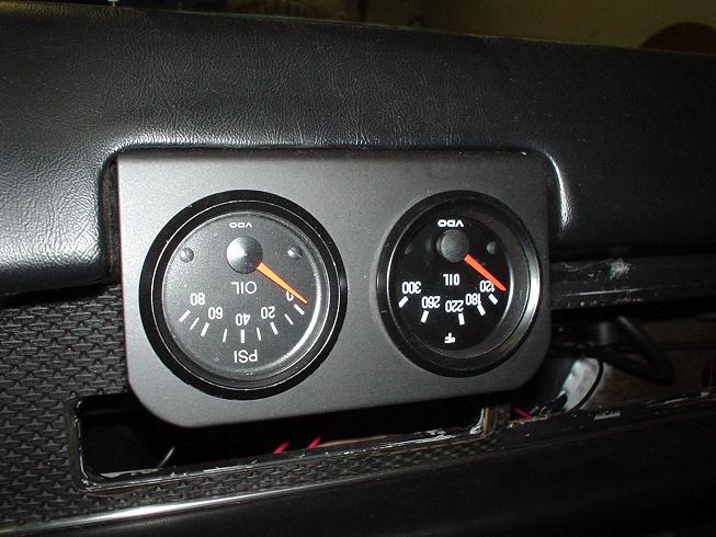

BravoHotel
post Dec 16 2003, 08:33 PM
Posts: 153
Joined: 5-March 03
From: Columbus, MS
Member No.: 399
standard 2-gauge panel from Jegs...like $7.00 or something.
and, yes they are mounted upside down... (IMG:style_emoticons/default/cool.gif)

BravoHotel
post Dec 17 2003, 08:19 AM
Posts: 153
Joined: 5-March 03
From: Columbus, MS
Member No.: 399
QUOTE(bwilless @ Dec 16 2003, 07:38 PM)
Can't you spin thoes gauges over? That would drive me crazy (IMG:style_emoticons/default/headbang.gif)
I wanted the front face of the gauge panel to be flush w/ the front of the dash. The conglomeration of wires and "thickness" of the guage assembly would not allow them to be mounted rightside up w/o running into the dash....so upside down, it was. By now I'm used to it, and it makes for a good conversation starter.
