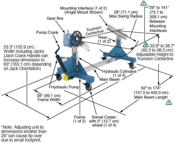

I've been eyeing some holding fixtures at work that look really cool ... they have a 'Boston Gear' gearbox for rotating. These are beefy, made by a company called Flotron.
I gotta keep my eyes open for surplus sale!
