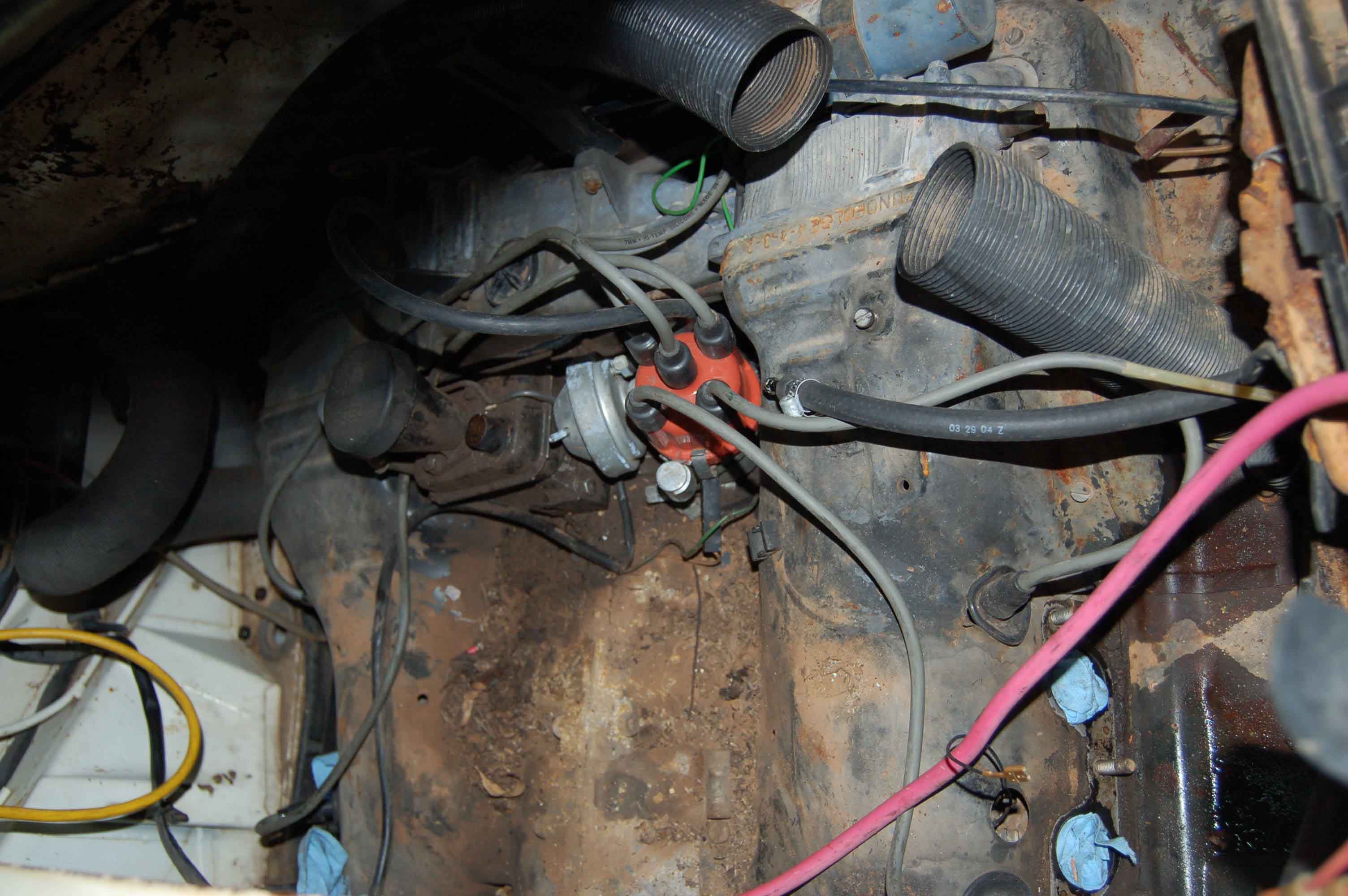

I'm going to go over my FI system. I took everything out of the car tonight. I'll install Solex H40 carbs in the meantime. What a vast difference the engine bay looks after the FI is gone. This is the before pic.

This is after FI removal.

Looks bare. Dirty...but bare. Clean that puppy up.
So, are you going to recondition the FI? What would that process entail?

First, I'm sending the injectors to be tested/cleaned. I found about a pound of dirt and rust in the tank. Then I'll test the fuel pump or get a new one. Look at the trigger points, get all new FI hose/lines... All of the components seemed to test OK while in the car like the MPS, CSV, TPS, pressure regulator but I was running very lean. I think not enough fuel was getting into the engine through some fault of the FI system.
