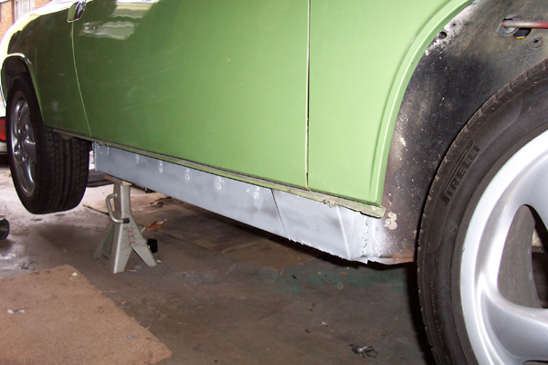

Is this the kit you're talking about? (not my photo)
(IMG:http://www.sayegh.org/Paul/IMG_0157.JPG)
Did some research and found this installation thread:
http://www.914world.com/bbs2/index.php?act...t=14508&st=

QUOTE(TeenerTim @ Nov 8 2007, 07:17 AM) *
Yes,
That's the one ! (IMG:style_emoticons/default/aktion035.gif)
