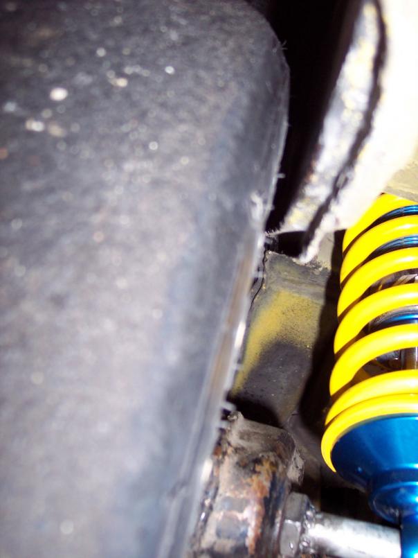

15 x 10 wheel and a 22 x 9.5 x 15 Hoosier slick PERIOD no bigger
I got my new wheels for the rear in Saturday. Diamond Racing made me a custom set in 6 days with shipping. Backspace is 5.75" and that's all that matters. 19 lbs and $295.00 for the pair shipped.

inside

That is TIGHT! Both in the teenage dialect, as well as in the classic definition. (IMG:style_emoticons/default/wink.gif)
How's your inside clearance?

I'm curious to hear how close the inner wheel well clearance is. The slick size you mention 22x9.5-15 has a listed section width of 10.7" on a 10" rim. Does that agree with what you can measure? If so, then there's hope that the new 275/35-15 radials MIGHT fit under off-the-shelf GT flares.

Right now I am worried about ripping the suspension consoles off the car. Cage and ear re-inforcements are in the works.
This is my 2nd set of these wheels and they are pretty dang tough.

Well, it looks like the race is on!! Although mine is strictly a street ride, I'm working on stuffing 285/30/18's under stock GT flares on 18x10's in the rear. The 18x8.5's fit like a glove on my 5 lug SC suspension up front with a 1" spacer. I could push them to 1.5" spacers if I wanted to fill out the wells completely. Eric Shea has just built me a set of new five lug trailing arms with 100mm studs to work with the high offset wheels. I'm looking at 42mm of spacers in the rear. The tires clear the trailing arms, but I'll have to see how much room is left on the inner fender wells. I may end up going down to 265/35's to ensure good clearance (and much cheaper, too!). I have been curious about "massaging" the inside of the rear fender wells to address any clearance issues. If the suspension points were supported, would it be possible to "stretch" the inner fender wells a-la John's video?

Fiberglass GT flares are held on with large head pop rivets and medium strength RTV adhesive. No massaging of the structure but I did cut off the entire lip and ground it smooth. there is a roundish edge lip left over from the mold as it formed the corner so it gives me a bit more strength.

I would worry about sidewall flex....

Shouldn't be too much as this is the size rim that the tire was designed for.
and if it rubs well I olny got 2 Diamond rims made not Like I bought a full set of CCW's
