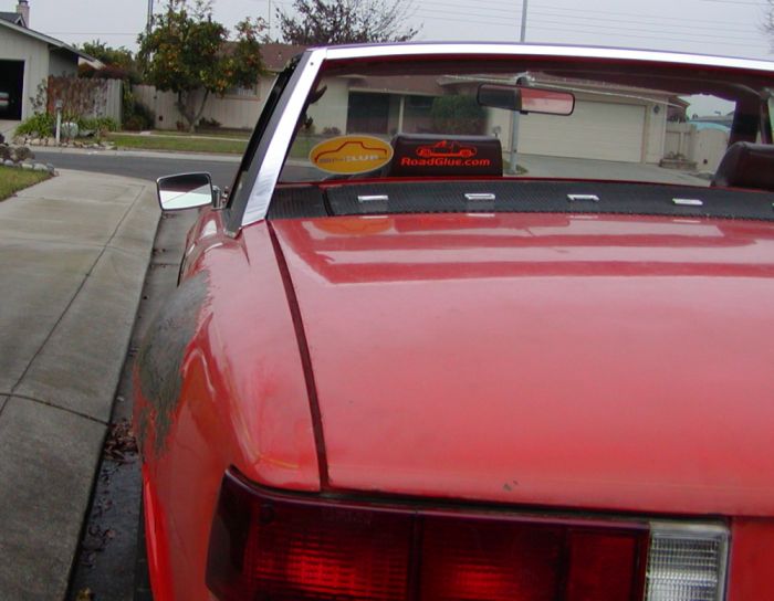

Anyways, heres a pic of my newly finished flare. Im debating on doing more or not.. it would be finishing work, dont want it bigger. It fits 245 on 8in Gotties.. It was my test rim.. What do you guys think?
Andrew

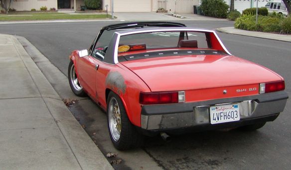

lazy me

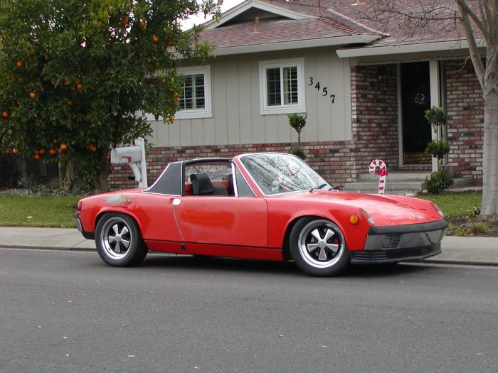

more

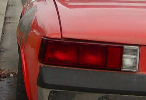

And reason for question
havent done much on this flare

Man are those oranges on that tree. It sure looks good to me sitting watching the snow come down. It's snowing so hard it knocked out the satelite. I can't even watch the football games (IMG:style_emoticons/default/sad.gif)

Ouch, not much of a football fan, but I can say that the oranges taste pretty good (IMG:style_emoticons/default/chowtime.gif)

May just be the wheel in the gutter, but looks like a teeny little bit of camber on the rear there already.

Oh and heres what the flare has space wise, My fuch's that I run have about an inch more room than these gotties.. loadsa room..
