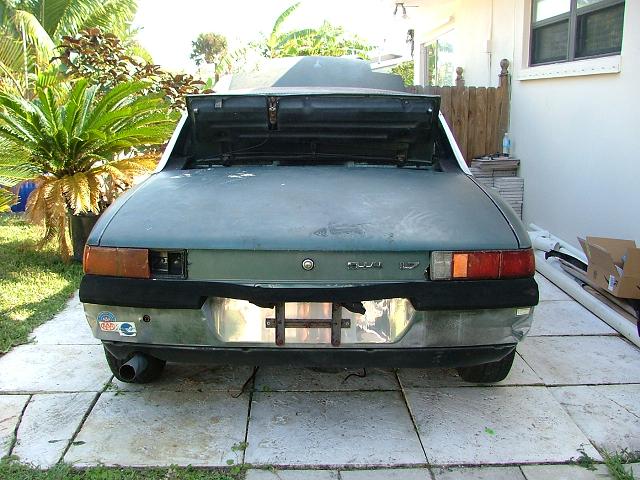

I am starting on restoring a $500 914 that was left in a field for several years with no windshield. The car belonged to the POs older brother and thus has sentimental value. The sold it to me on the condition that I not part it out. I was looking for a project so this was fine with me. This is my first restoration project so I figured I would learn a lot (IMG:style_emoticons/default/biggrin.gif) (IMG:style_emoticons/default/biggrin.gif) (IMG:style_emoticons/default/biggrin.gif)
The car is a mixture of really good sections, appears to have suffered no major accidents, is straight, never been repainted--but it has totally rusted out floors and hell hole. All the suspension mounting points are not rusted. The door gaps are all even and good. If I can replace the floors, I think it will be a good straight car. Many small parts were stolen while it was "stored" and the wiring loom is a complete loss.
Thanks for any comments...John

Some pictures in my restoration "garage".

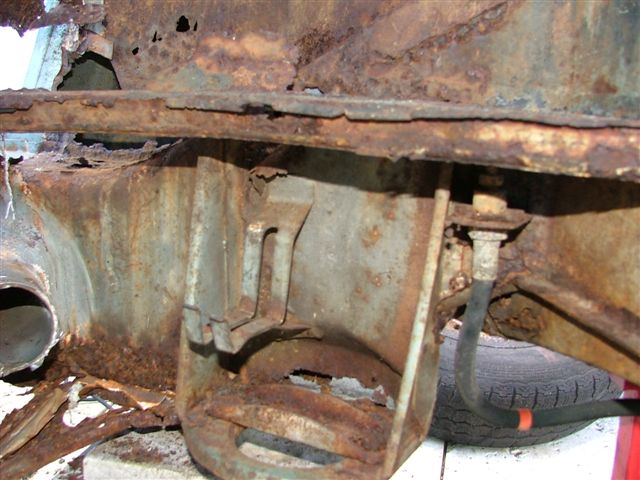

Thanks for the encouragement. I can see this is a road many of you have taken already. It looks like the floor pan is a total loss. I pried up a lot of the tar and the floor is basically falling out. The lower, inner edges of the longs are rusted through, the rest is not too bad.
It is finally cool enough down here in FL to work outside and be somewhat comfortable. Brevard county is nice but you get tired of the humidity all the time.
If the inside edge of the longs are rusted out (the part closest to the cabin) and the floor pan needs replacing, should I replace the floor pan first and then patch the longs or the other way around? I assume the floor pan is spot welded to the bottom of the inner long, right?

You're correct. The floorpan is spot welded to the longs. You'll need to patch and repair the longs before you weld in the new floorpan.

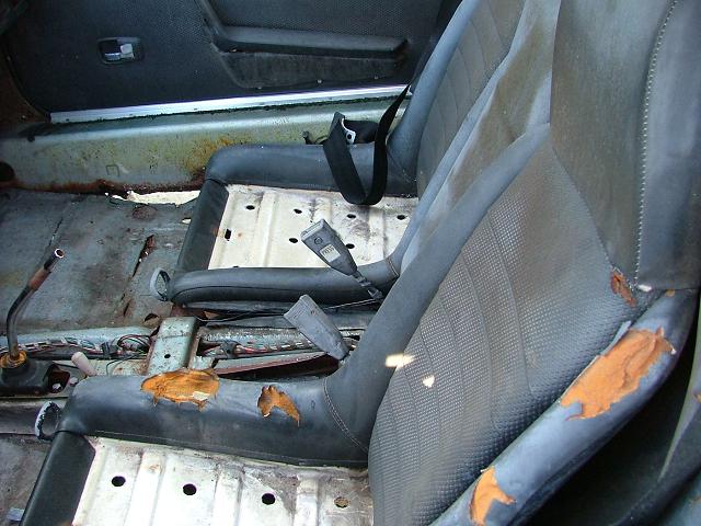

I hate to be a spoil sport but that interior picture tells me you have more than floor board problems. The longs are badly rusted at the bottom and if the pattern is the same as mine then the rust started inside and there is no steel left down there. It can be repaired - see the thread 'digging into hell'. I think it is now in the classics.
Get out your ice pick and go poking around. Look at the outer longs as well particularly passenger side rear.

QUOTE(swl @ Dec 16 2007, 05:46 AM) *
Yes, you are right. The inside part of both longs are rusted through. Strangely, the outside longs are in good shape except at the front and back ends. Passenger rear is in bad shape, I guess from hell hole rust through. (IMG:style_emoticons/default/sad.gif) (IMG:style_emoticons/default/sad.gif)

I had to accept that my car was beyond my ability to restore. I went out and bought another project with a strong frame - lot cheaper in the long run. Took a lot of soul searching to make that decision. I had that car since college days.
Without doubt the passenger rear is from the battery acid. You will probably find more of the same behind the passenger seat on the firewall.

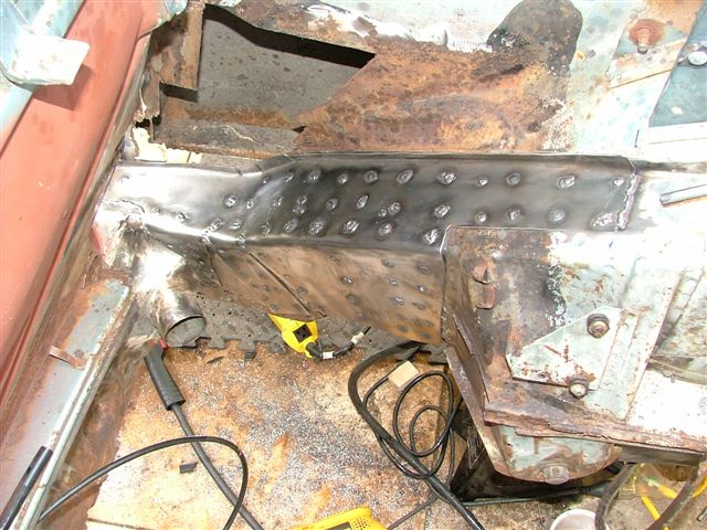

Cleaned to good metal, primed, patched and added home brewed 16 guage hell hole/long stiffener. I primed it right after this shot but the shiny metal looks nice after all the rust.
McMark is sending me a new motor mount.
Now I need to determine if I need a new suspension console as well.

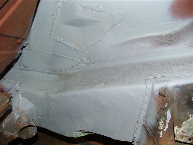

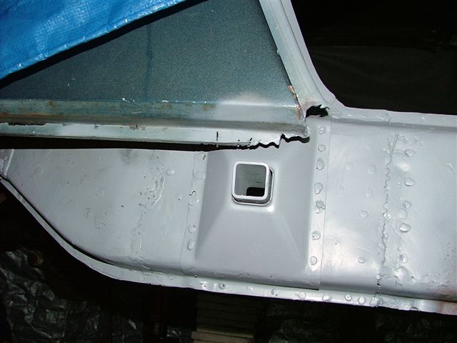

Hell hole finally makes it to primer heaven! I don't like the look of the welds sticking up but I would rather not weaken it with too much grinding.
Outside of long patched up and new jack hole stuff. Not sure I stuck the jack hole tube out far enough, I don't want to have to weld on an extension. Should I weld the end of the jack hole tube to the jack hole cover?
Still need to weld on a new motor mount and probably need to replace my suspension console. The bottom of it is pretty much crumbling with rust.
