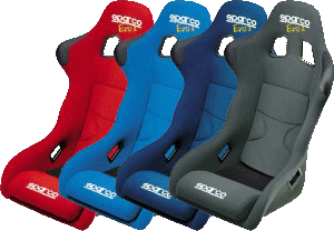

i just got a set of the Sparco Evo L seats ... i have yet to mount them, but a initial test fit shows that they'll fit just fine.
however, i will remove the stock seat rails and hinges and weld in two steel crossbar reinforcements for the sparco mounting brackets.
that will move the seats closer to the floor, giving me more headroom ...

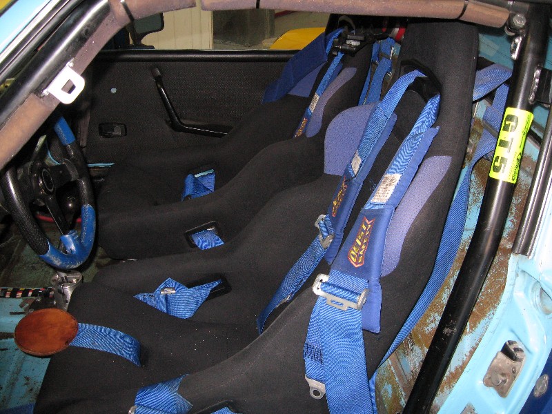

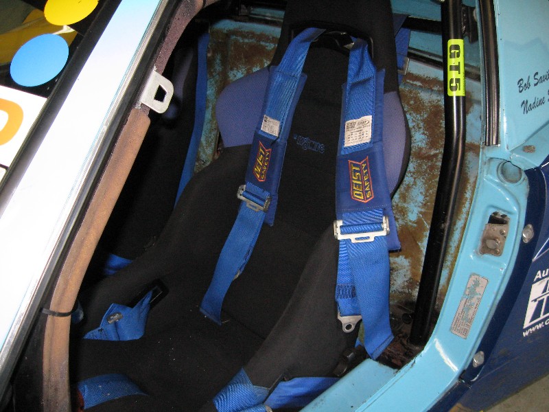

Konig makes a great seat just for 914's. I run them in both my club race car, and our Targa Newfoundland/street car (once it gets rebuilt). Very comfortable, lightweight, and pretty easy to install without a lot of modifications...
Now, the bad part. It's my understanding that the Konig sliders are not available, or EXTREMELY expensive. I got a set of generic ones from the supplier and had to redrill a few mounting holes on them to fit the seats, but not a big deal.
I need slider because my wife drives with the seat up somewhere near the hood badge, and I have the seat against the rear firewall.... (IMG:style_emoticons/default/smile.gif)
Anyway, i get them from Stable Energies. Ask Bob about seats and fits, he has been racing a 914 forever, and knows them very well.
