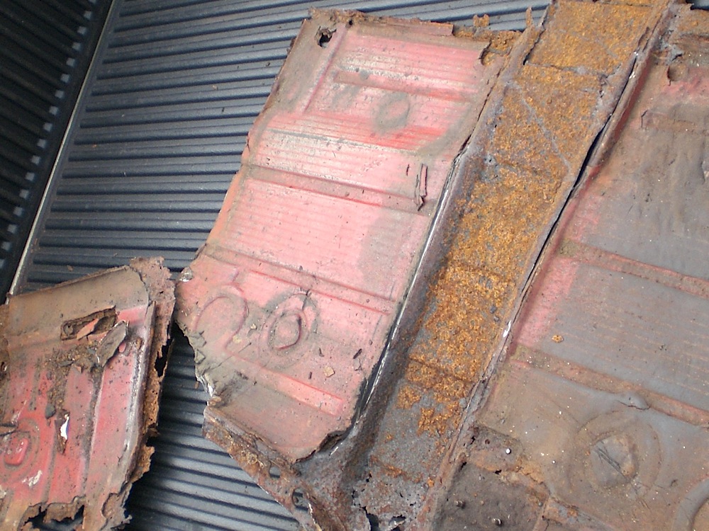

this wasn't the worst area
rufio0205
post Feb 12 2008, 06:27 PM
Posts: 134
Joined: 9-September 07
From: Orlando, FL
Member No.: 8,099
...probably not the best way....Attached Image

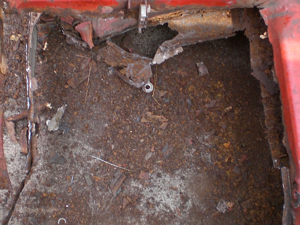

partially out
rufio0205
post Feb 12 2008, 06:29 PM
Posts: 134
From: Orlando, FL
Member No.: 8,099
dirty work

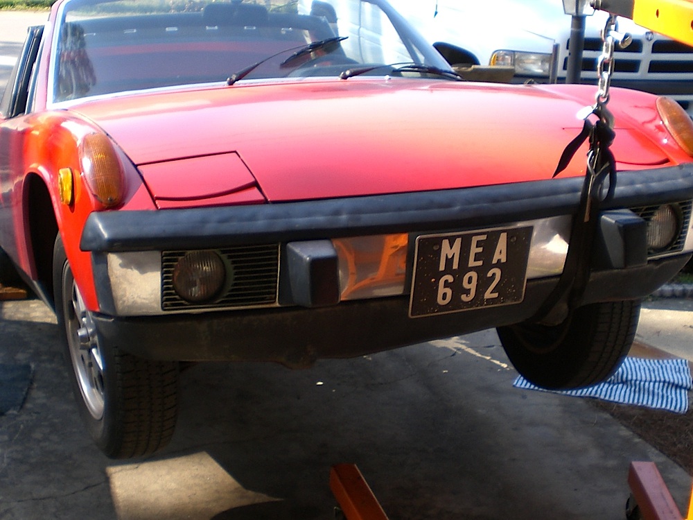

almost done...sorry about all the posts. didnt know how else to do this

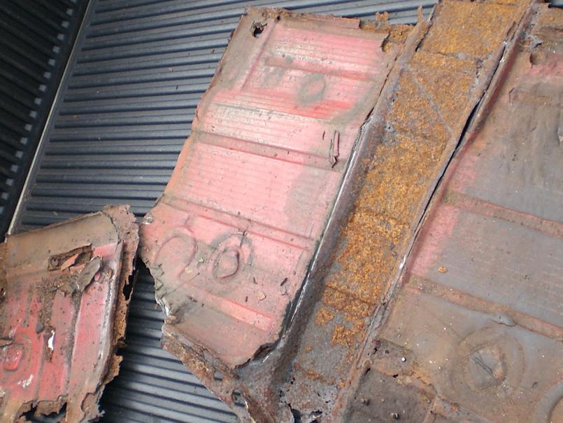

the floors are out...in my pickup...

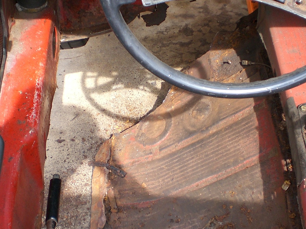

and lastly before pictures of new floors....

Wow you got your work cut out, is there anything to weld the new floors too?!!
Plenty of (IMG:style_emoticons/default/welder.gif) and fabbing, look forward to seeing your progress.

i am actually paying a guy to fab the pieces and weld them in...there isnt much to weld to...but we will figure it out.

After seeing that floor rot... I think I'm going to weld in some extra material along the seams of the center tunnel, inside longs and both firewalls. So do you stop and go like the flinstones?
