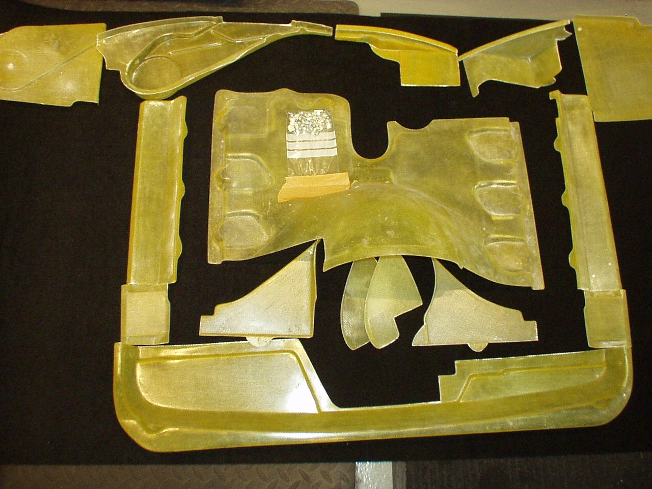

I think it's a great idea Pete. Got any good pictures of 'naked' fiberglass for members who aren't familiar?
McMark
post Mar 18 2008, 05:52 PM
914 Freak!
Posts: 20,180
Joined: 13-March 03
From: Grand Rapids, MI
Member No.: 419
This look, right?

QUOTE(McMark @ Mar 18 2008, 04:52 PM) *
This look, right?
THAT'S the look...
I think the key would be getting the over-the-top obvious weave and high gloss that Morspeed favors. Or not? Wonder if someone could photoshop a couple of 914-4 engine bay shots to give us a rough idea of what this might look like.
pete

It's simple...
We can easily do this by just using a clear gelcoat rather than a colored gelcoat. I have made DTMs like this for demonstration purposes and it does look very cool.
I have a mold for 2.0 cylinder tins and could pretty easily finish our blower housing molds for the hybrid vanagon/914 shroud kit if I knew people would buy them.(superior cooling air discharge volume and pressure compared to stock)
Its just a matter of volume, there are many things we could offer but the market just won't support it. These things are very cool, but it takes a certain breed of enthusiast to appreciate them- others just think its ugly.

"Natural"? Since when is red gel-coat "natural"?
Sure, it matches the car, that's cool. But Pete is talking about the translucent yellowish un-painted fiberglass, like in the picture of the 914-6 engine tin that McMark posted.
And after seeing the cover of Pano (sorry, Pete) a couple of months ago, with the sixteen-cylinder 917 engine, I won't disagree that it would be a really cool thing!!

Some of the ridges are there, but a few have to be removed to make the units from glass inside molds.
The only killer is the "llok" can't be achieved with components that need to be super strong as the glass gets too thick to allow the transparency. Thats what would make the blower housing difficult to make because it has to accomodate an alternator bracket and needs rigidity.
The cylinder tins would be fairly easy to do since they need little strength or rigidity.
My X4CS DTM Carrera cooling system should do enough in the looks department to take things to the next level and its being made for effectiveness more than a "look" as I have little to no desire to make blingy items that don't increase the longevity/reliability/efficiency or power of an engine while looking good.
I don't think we'll have any "attractiveness" issues after I reveal this baby in mid 2009
I think the only way this idea makes sense is for those who don't need/don't want/can't afford the DTM setup.
So, as a replacement for the stock tin on the engine (which many building your motors retain) could it be done? I get the sense you mean the structural issues are only issues with your upgraded cooling systems. And the setup you hint at here, as well as the Fat IV setup (too bad it seems to need an internal redesign), don't need any aesthetic help. Just some gloss black paint, or whatever color people want.
I am also not interested in items that look blingy, either. Period. But, as someone wise once said, once the man is made, clothing greatly improves his appearance. The 914's Type IV has never been, uh, particularly nice looking, even with carbs. Just trying to think of ways to address that... I also like the idea of the appearance of the engine bay reflecting the idea that 100-150 pounds have been saved over installing a 911 engine... and nothing says "lightweight" like 911R cues.
The opposite of bling, in my book.
