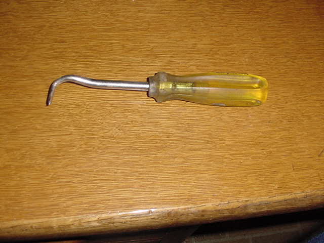

You can pull the gasket, its a copper gasket, just use a pick, like the dentist uses...

use a 1/4" drive socket on the he nuts. the thin wall gives you more wiggle room. often, if you feel around the inner edge of the copper gasket you can find an edge that protudes slightly inside the exhaust port in the head and you can hook it with one of these. i've used a extreemely small dab of grease on the top side of the gasket to stick it in place when putting the he on. you have to work fast.

I used a combo of ideas posted and given. I purchased a curved pick to pull the gaskets and that worked great. Using a cobo of ideas on the gaskets, I decided to use a bead of Automotive Goop around the perimeter of the gasket, doing my best to ensure that none gets on either face, and stuck the gaskets in place. I reamed out the flanges where the studs go through and mounted the one HE in place. It all went well but I won't know how well 'till all is in place.
