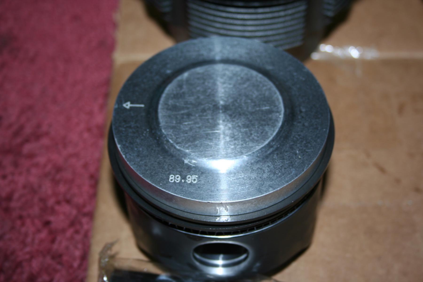

Well, anyone who's used them? Does the arrow point up or down?

The piston industry standard is to make a mark that points to the flywheel. Are these the pistons with the valve relief pocket? If so, the pocket does DOWN, regardless of anything else.

No, they're basically 1.7 Euro stockers, but the arrow points up or down? WTF?

Look inside the pistons and see if there is a little crank looking mark. Kinda looks like a zig-zag with a straight line at one end.

Only the mystery arrow and a number (89.95). I'm guessing it's either weight or bore. No marks on the inside either except an AA logo cast into one side. BTW, what's the difference? Is the wrist pin hole offset or something? I'm emailing AA today, but I probably won't hear from them 'till tomorrow.

Pic.

The arrows above point up and down. That is not the norm. The norm is fore and aft. The flywheel is on one of those points and the arrow fore or aft woudl point to the fly wheel.

I know the arrow always points toward the exhaust on Stihl products. That's what I have the most experience with. It may or may not be correct in this instance though.

doc, but wouldn't that flip the pistion by 180deg from "left" to "right" side. i.e. if my left bank points to the flywheel, i would have to flip the pisiton by 180deg on the right side in order to point to the flywheel.

Yes, one would have to flip the pistons to point all in the same direction. If this conflicts with the piston pocket orientation (if there are any) then you have 4 of the same side. Not good.

I've seen arrows both flywheel and nose, but never up or down.

measure the wrist pin placement to see if it is centered in the diameter of the piston.
If it is offset (somewhere around 8mm) that would be the bottom of the piston on a stock motor....and the top in a race motor...lol
If they are offset, you want the rod closer to the bottom of the motor...I hope that makes sense.
Makes it quieter with less piston slap when it reverses direction.
Early 911 had this...then it went away..then it came back again.
beetle and 356 and type 4 have the offset pins.
