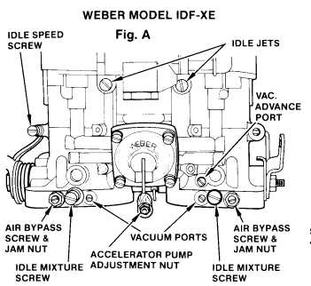

I've got a 2056 with cam and Webers. An electronic point module and the Crane HI-6/PS-91 each made a significant diference to the running of the car. When I drew this up I was still using the 009 distributor that the PO installed. Since replaced with the original 2.0 distributor, but haven't updated the drawing.

Kargeek asked:
HarveyH, You bring up an interesting question... are you running the 2.0 dist with your carbs utilizing it's vacuum advance?
I am. My webers have a tubular port just below the throttle plate area. Had to take out a small threaded plug (IMG:style_emoticons/default/smash.gif) to access the port, but it's there. Hooked up a hose from there to the distributor canister advance side and it works like a champ. Seems to give smoother acceleration comming off-idle.

Rouser
post Jan 23 2004, 06:02 PM
Anti-Post Whore
Posts: 597
From: Citrus Park, Florida
Member No.: 54
If you're using the ports next to the mixture screws, those aren't the correct vacuum ports.
Those provide constant vacuum, not variable, and are used with a manometer for syncing the throats/carbs. Distributor vacuum advance occurs above the throttle plates, not below. Just for clarification ...
Kargeek
post Jan 23 2004, 07:38 PM
Posts: 555
Joined: 14-March 03
From: Orange, CA
Member No.: 430
The vacuum advance issue is interesting as I was reading on the Air cooled net website about their custom curved dist with vaccuum advance. The 050 and 009 dist's really don't have the proper advance curve- the 050 is close but at low-mid range rpm, timing is retarded and a vacuum advance is supposed to help. Now, are you running vacuum off both carbs? This is what is recommended. My delorttos (sic) only have one carb with the off idle vacuum port and i'm thinking that the vacuum signal would be unbalanced and weak.

Gary
post Jan 23 2004, 08:31 PM
Posts: 749
Joined: 12-January 03
From: Mount Airy, MD
Member No.: 134
A port on the second carb isn't hard - there's a boss there for it. I drilled it out carefully and bought a brass tube to fit. As I recall, I used a very small bit first for the vacuum port and a bigger bit for the tube. Comes out right above the plate, just like on the other side. Rather than swage it in, I JB'd it.
